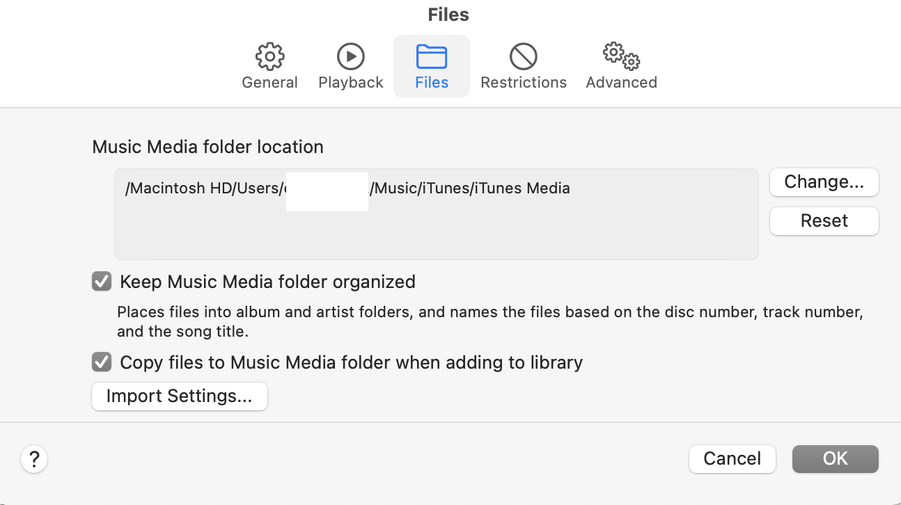

Because I was using iTunes when I set up my external drive, my Music Media folder was and still is named iTunes Media. (See screenshot of Music<Preferences<Files).
Just focus on your Music Media folder on your external drive and make sure Music points to the correct folder. (You're pointing to the correct media folder, not moving folders.) If the music on your external drive appears and plays when you launch Music and new music you add to your library goes to the media folder on your external drive you're OK.
Don't mess around with your Library files.
OK the only difference is that the "Keep Music Media folder organized" is not checked. Should I check it to prevent any further mixups?
Yes. And when you add new music, use the Music<Import process and navigate to the files you want to add. Don't just drag and drop onto your external drive.

I just checked the box and Music is organizing the music folders now (but they were already in folders...)
