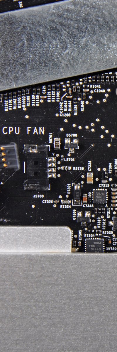

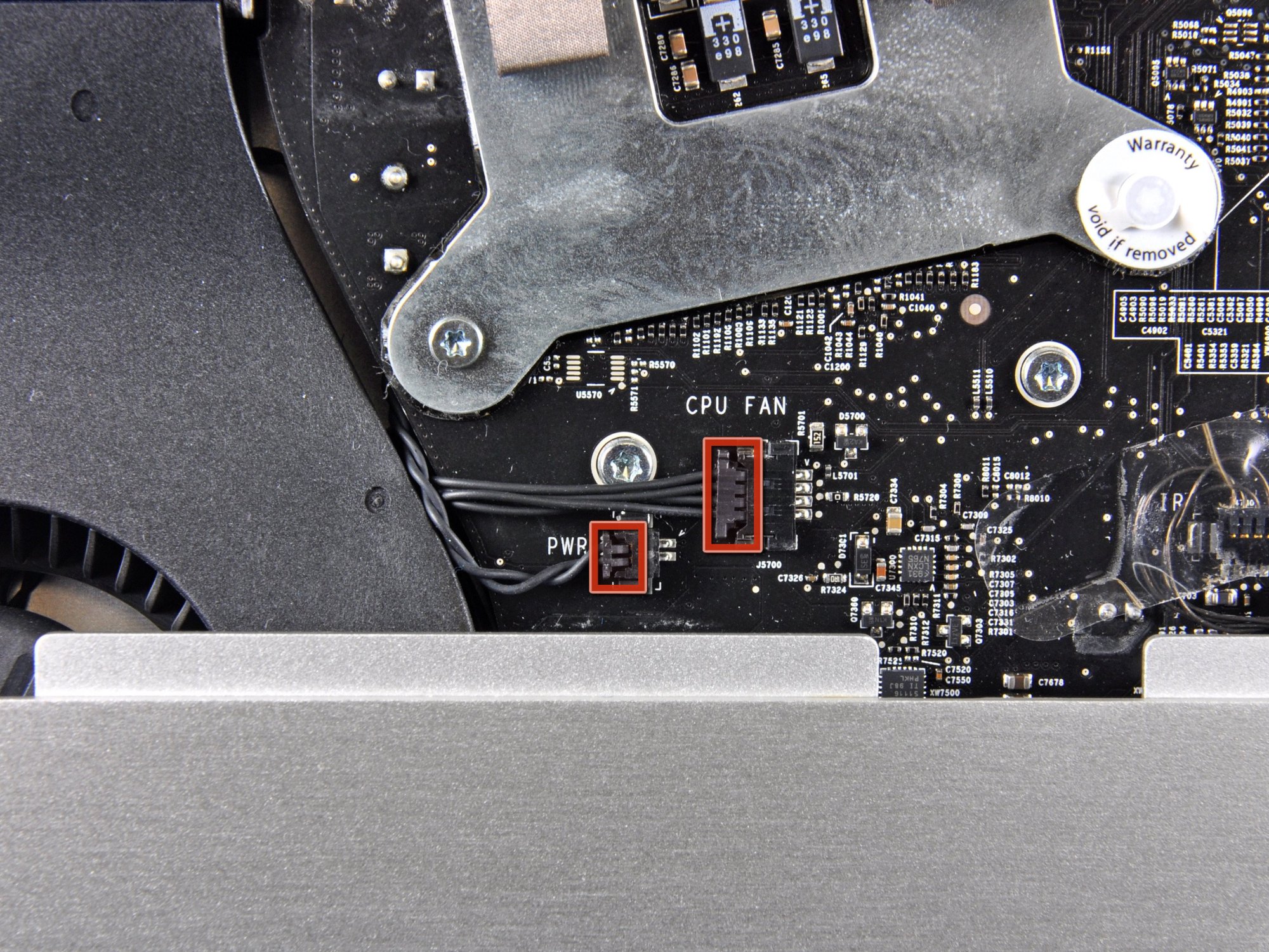

The CPU blower fan is at the lower left, it has a 4 pin connecter:
What are my options to quiet down that fan?

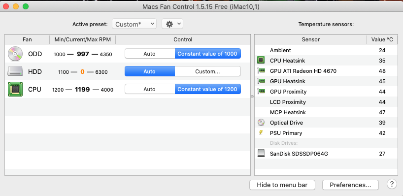

I am already using fan control software to set it permanently at 1200 rpm, but that is still not quiet enough for my liking.
I see the fan plug is a standard 4 pin connector.
Can I solder a resistor to it to slow down the fan speed?
If yes, how do I determine what resistor to use? (I am not familiar with soldering and modding electronics)
And the 4 wires are all black, how do I figure out which is the 12 V and 5 V and the 2 ground lines?
In the past, for my desktop tower computer, for a loud fan I used to ground the black wire to the 5 V line, that would make the fan run at 7 V, but this iMac blower fan uses a different plug than the molex connecter. Would there still be a way to attach the ground line to the 5 V and make my fan run at 7 V, that would be a simple solution if it can be done too.

The CPU temp readout in the first screenshot shows the CPU at 35 C when idle, I read that CPUs can reach up to 90 C during load and still be functional, so the heat is not the problem in this iMac. And even if it was I can always replace the 14 year old thermal paste on the CPU, that is an easy to way to get the current temperature down even more if it has to come to that.

5. Finally, use Mac Fan Control as you have been using it to reduce the RPM of the fan.

I want to reduce speed of the fan even more, the fan speed is ALREADY at the lowest possible setting, I want to do a hardware mod like how I said in my first post.
