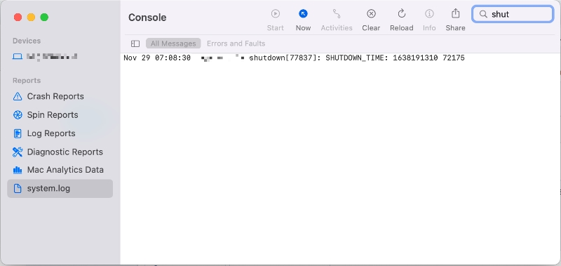

When in the console app, select systemlog and it will display a log full of dates and what took place on that day. Now take a look at the dates of each log entry and find where one day ends and the other day starts. When you do this, as it gets closer to the one day ending you will see a system instruction that indicates the shutdown time. Here is an exmaple of what appears on my
May 4 16:17:14 users-imac shutdown[1131]: SHUTDOWN_TIME (then a bunch of numbers)
May 13 08:35:37 localhost bootlog[0]: BOOT_TIME (then a bunch of numbers)
You will see this entry in the log for every time the computer was turned on and when it was turned off. In my example you can see I shutdown the machine on May 4 at 4:17pm and didn't switch it back on again till May 13 at 8:35am
You should have the same in your log. Just look for the day(s) in the log you think the machine shutdown because the very next entry should be the day you turned it back on again. Then you will be able to see which day and what time the machine shutdown.
Shutdown time
Console app > system.log > Search (top right) shutdown_time
Restart time
Console app > system.log > Search (top right) boot_time

Just to note, you have to double click on the systemlog for the systemlog window to open and THEN use the search option otherwise it will not work.
Does not single clicking open sys log in default window? Double clicking does open a separate window, but not necessary. Maybe I have some tap click default changed.
