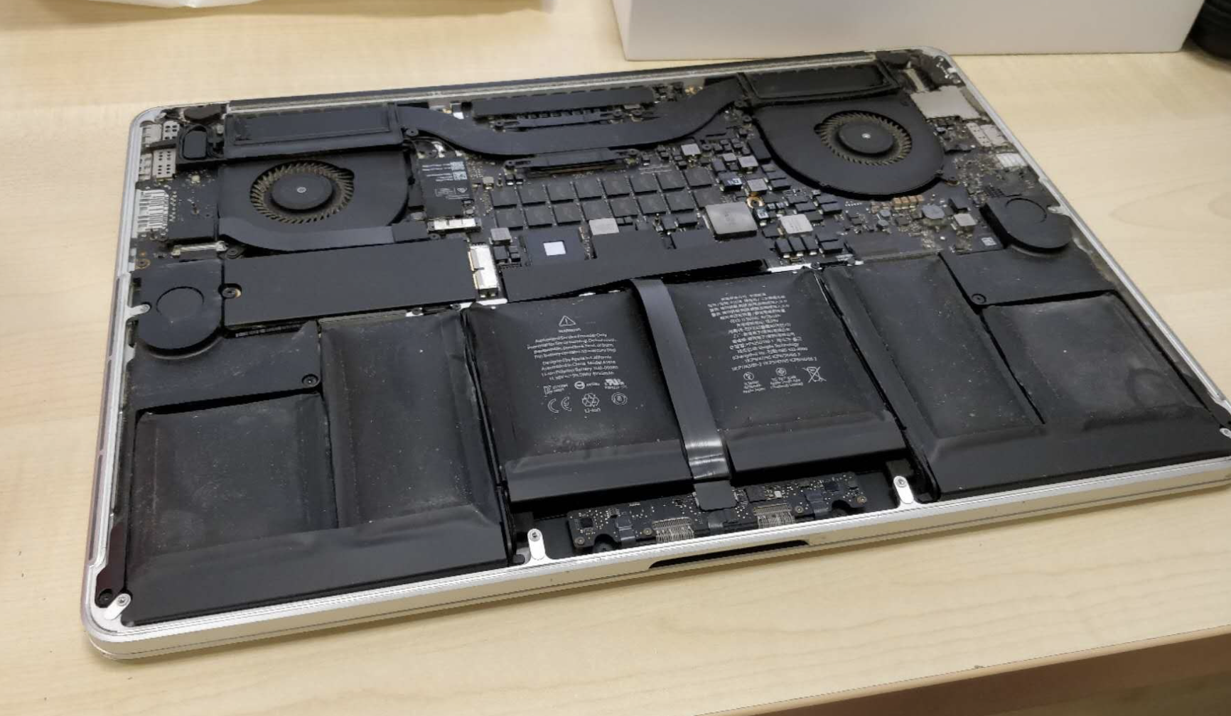

Here is just a random photo of what swollen batteries will look like. Normally these are flat and relatively squared off but you can see how rounded/ swollen they can become.
