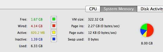

right now under page outs inactivity monitor it says 11.03GB (0 bytes/sec).
what exactly does that mean? is that bad?
Wow, that is way too much, this indicates you will get improvements by upgrading RAM.
On my 2012 Mini I had page outs a couple of times in the last few months, but only something like 100-200 MB.
Oh, and I too have 8 GB, what are you doing to get that many page outs?
Can you post a screenshot?
Edit: It means that all your physical RAM is taken and the system has to write the data to the HD which is immensely slower than RAM.
Here is mine at the moment 12 KB page outs!
