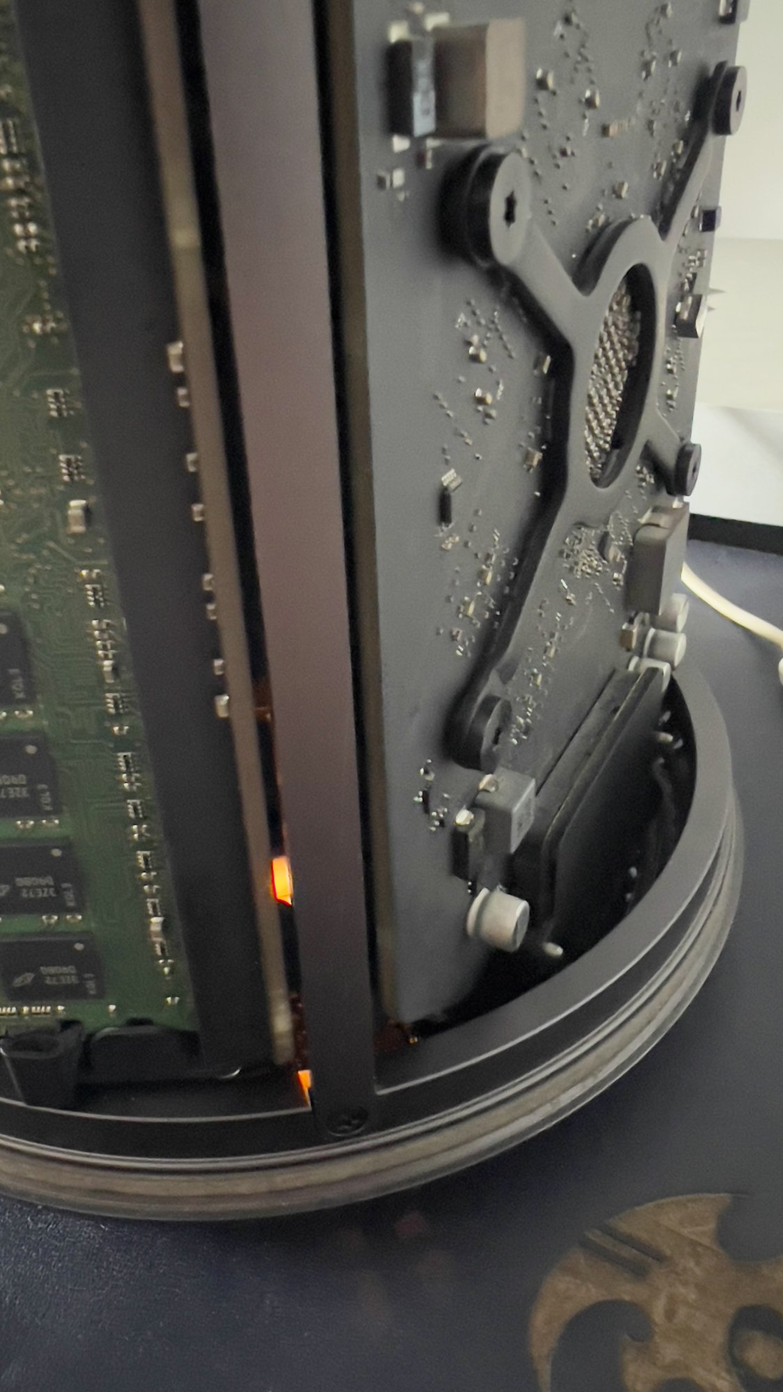

This morning, my Mac Pro has given me headache when it's no longer can turn on. All the lights in the back are still illuminated the light when plug-in the power cord. The Chime sound play normal when press on the power button but no boot screen. Follow the guide on logi.wiki, I'm able to start the mac pro without the casing and see the amber light on the CPU board as attached file.
May anyone here experience this before and how we can perform further diagnostic to narrow down the issues?

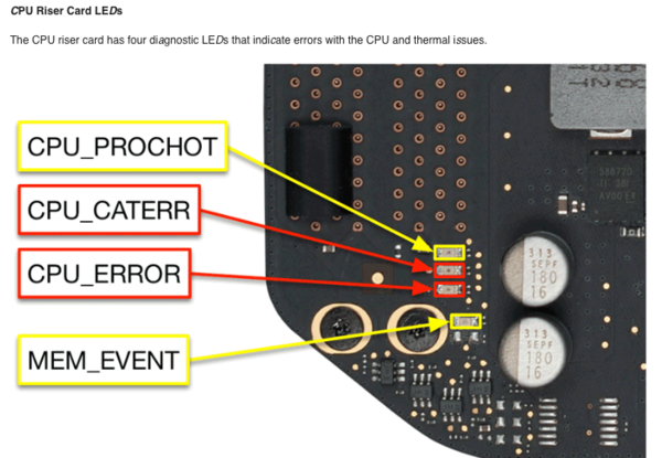

I can see the amber LED is on to indicate the issues as below but the space is just too small to look into the board for knowing exactly which light is on for checking. I still have hope that it can be saved because the light color is in YELLOW but not RED, isn't it.
From Mac Pro 6,1 Late 2013 Diagnostic LEDs - LogiWiki:
Error LEDs are red, and illuminate continuously when there is a problem.
Warning LEDs are yellow, and illuminate continuously when a thermal problem is detected. This type of LED is only found on the CPU riser card.
Ok so Its telling you there are thermal issues.

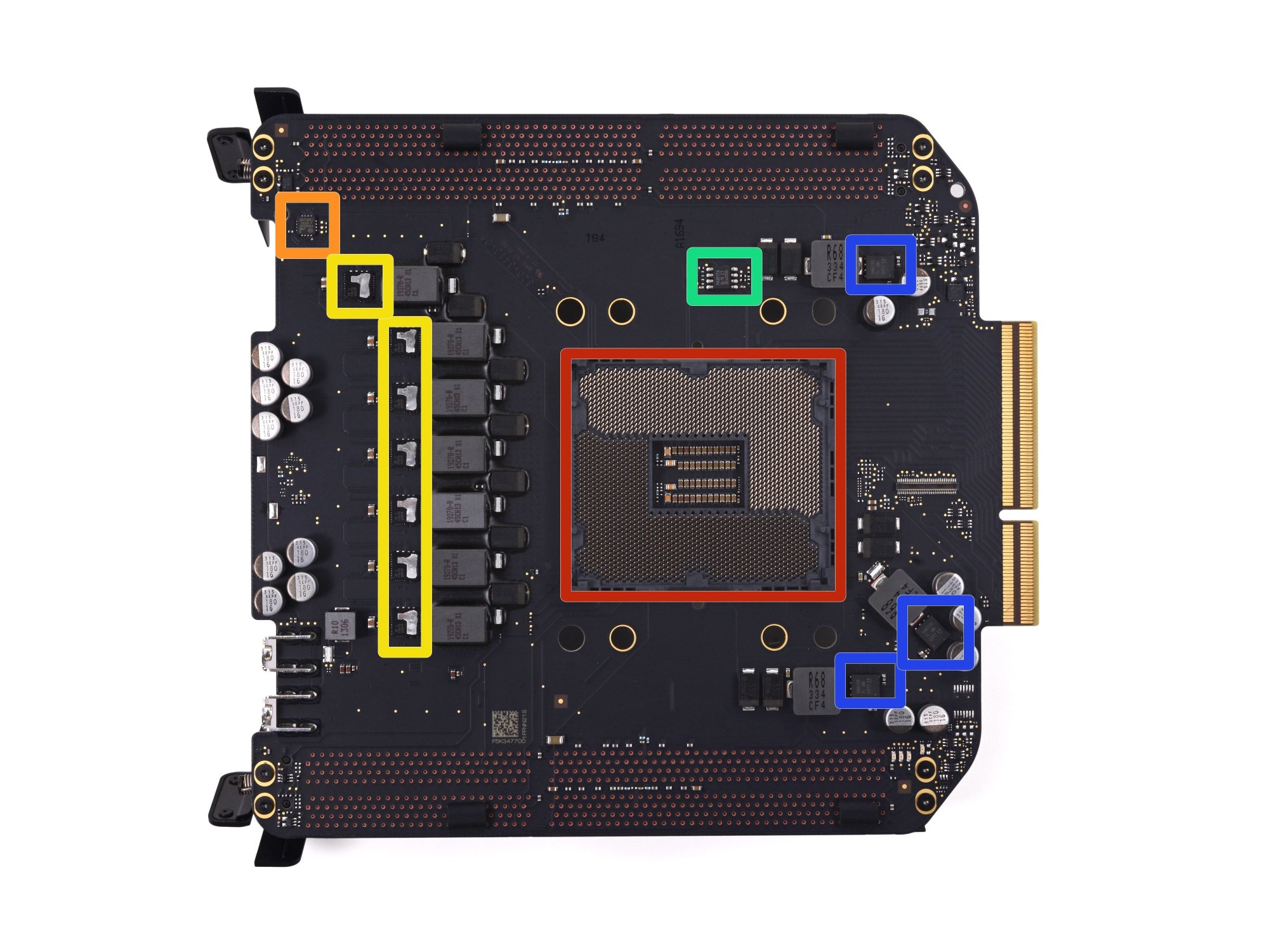

In finding a culprit of my Mac, I know the problem is related to the temp sensor. This is the picture I got from ifixit. Would anyone know the orange is the main temperature of it or any additional temperature sensor on this CPU riser board?
Thanks.
There are almost 38 temp sensors in the 6.1, unless that debug LED is for the part you are highlighting, then it could be related to an internal sensor in the CPU.
