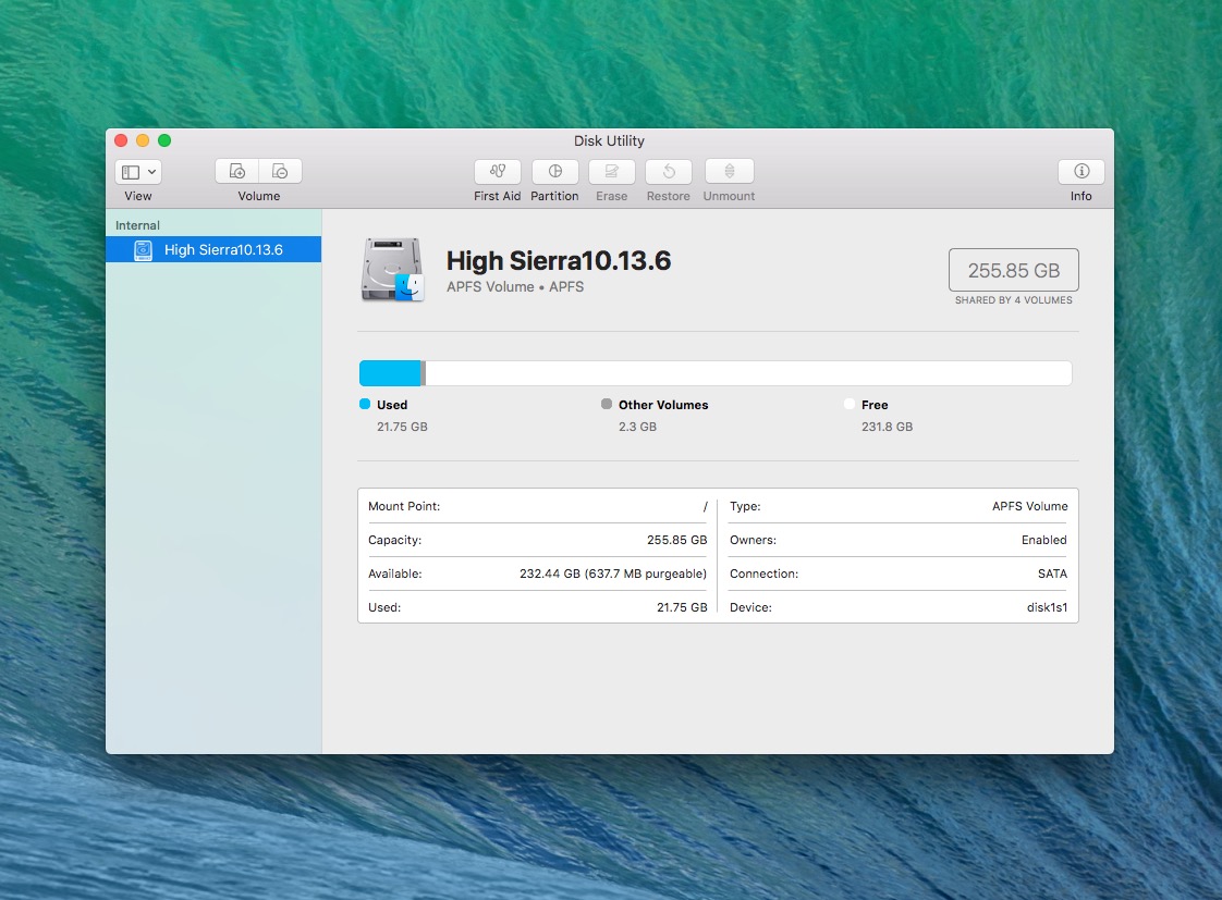

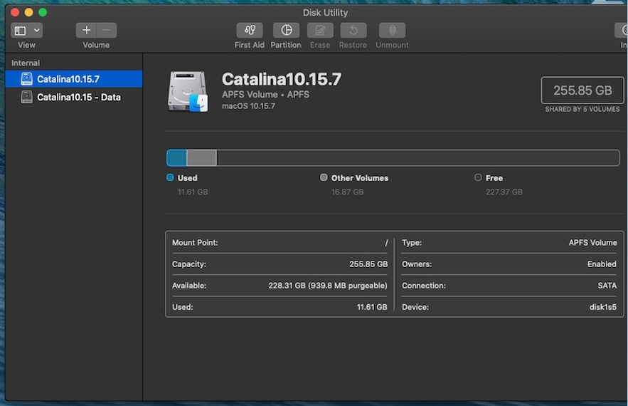

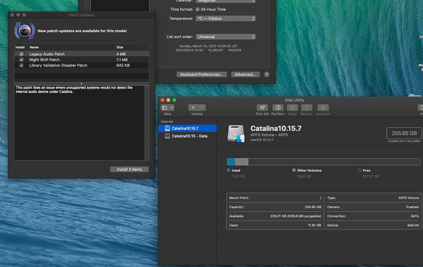

5: Yes, Not use Open Core.
I think Catalina or Big Sur Patch changed Hardware’s firmware.
But if I use USB High Sierra install disk install clean OS. I can into system.

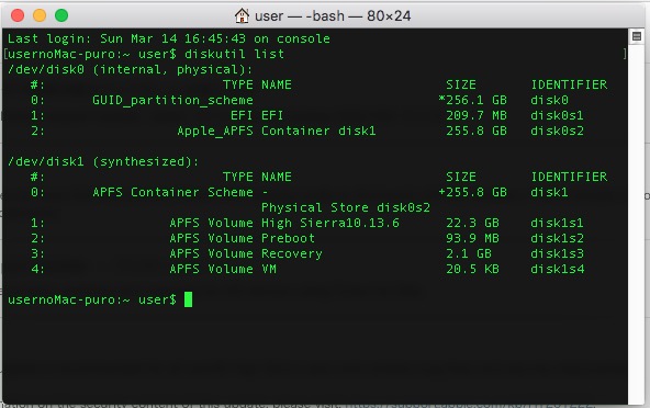

For diskutil I meant open a terminal window and then enter "diskutil list" at the command prompt and post the output here.
And to summarize - with just Catalina drive installed you can boot into Catalina, with just Big Sur drive installed you can boot into Big Sur, but with High Sierra drive installed you cannot boot into High Sierra (you just get the circle with diagonal line). If all that is true I would reinstall High Sierra on the High Sierra disk.
Hi, thanks your answer.
yes,I can reinstall clean High SierraOS .
sorry I don't know what is "diskutil" put here High Sierra diskutil list here
