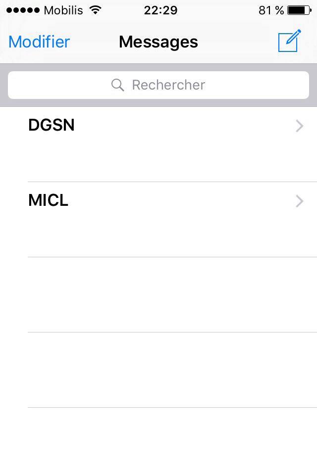

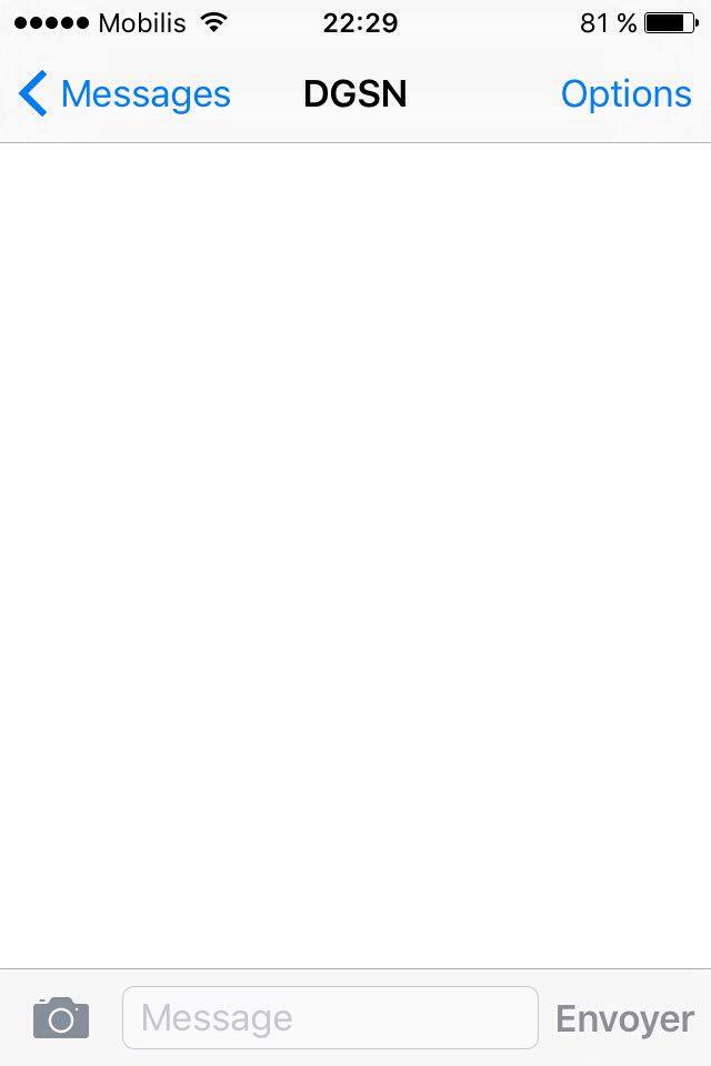

So It took me a while to finally move from IOS 6 to IOS 9 on my Iphone4S and when I finally did my Messages App isn't working properly.
*All my old text messages are gone.
*If I get a text message I don't even get a notification (yes I made sure in the options that it's not excluded from the notification center ).
*When I tested it out with a friend (without getting a notification) his message still appeared normally when I open it but as soon as I go back to see all the messages or click the home button and get back to the app I can only see the name of the contact and when I open it the text isn't there anymore.
*If I quite the app again the whole message disappear and the the whole page is blank.
*When I try to send a message the sending bar doesn't fully go to the end but my message does get sent but also desappear a few minutes later.
I tried to go back to my Save when I was switching to IOS 9 but nothing changed. I tried to switch it off and on again using the forced shutdown and it didn't work either. I also switched off and on iMessages, kept it on off aaaand nothing happened.
