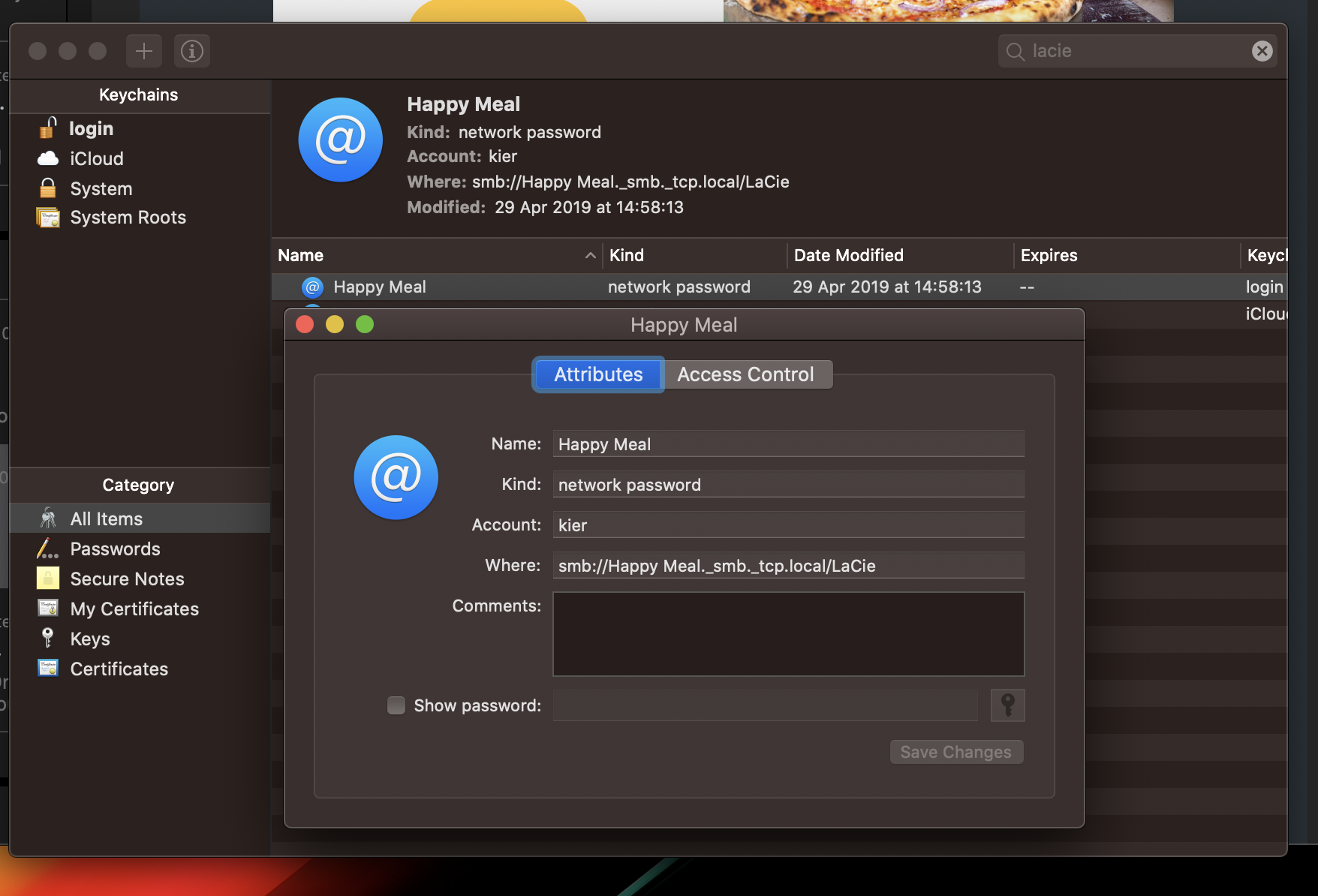

So, you probably checked to have keychain remember the credentials at some point when you connected to the share. Is there anything on your Mac that uses links (Symlinks) to the share? Do you use it for photos, music, etc that might be mounting when you launch those apps?

I’m not totally sure what you mean about checking keychain, could you clarify that, please?
Thanks again for your persistence.
I'm going to presume that you're referring to saved login creds for the share, in which case - yes, I do have those saved, though I'm not sure how that could cause the automatic reconnection issue I'm seeing?
In any case, I'll delete that saved password and maybe I'll see a mystery application request access at some point later today?

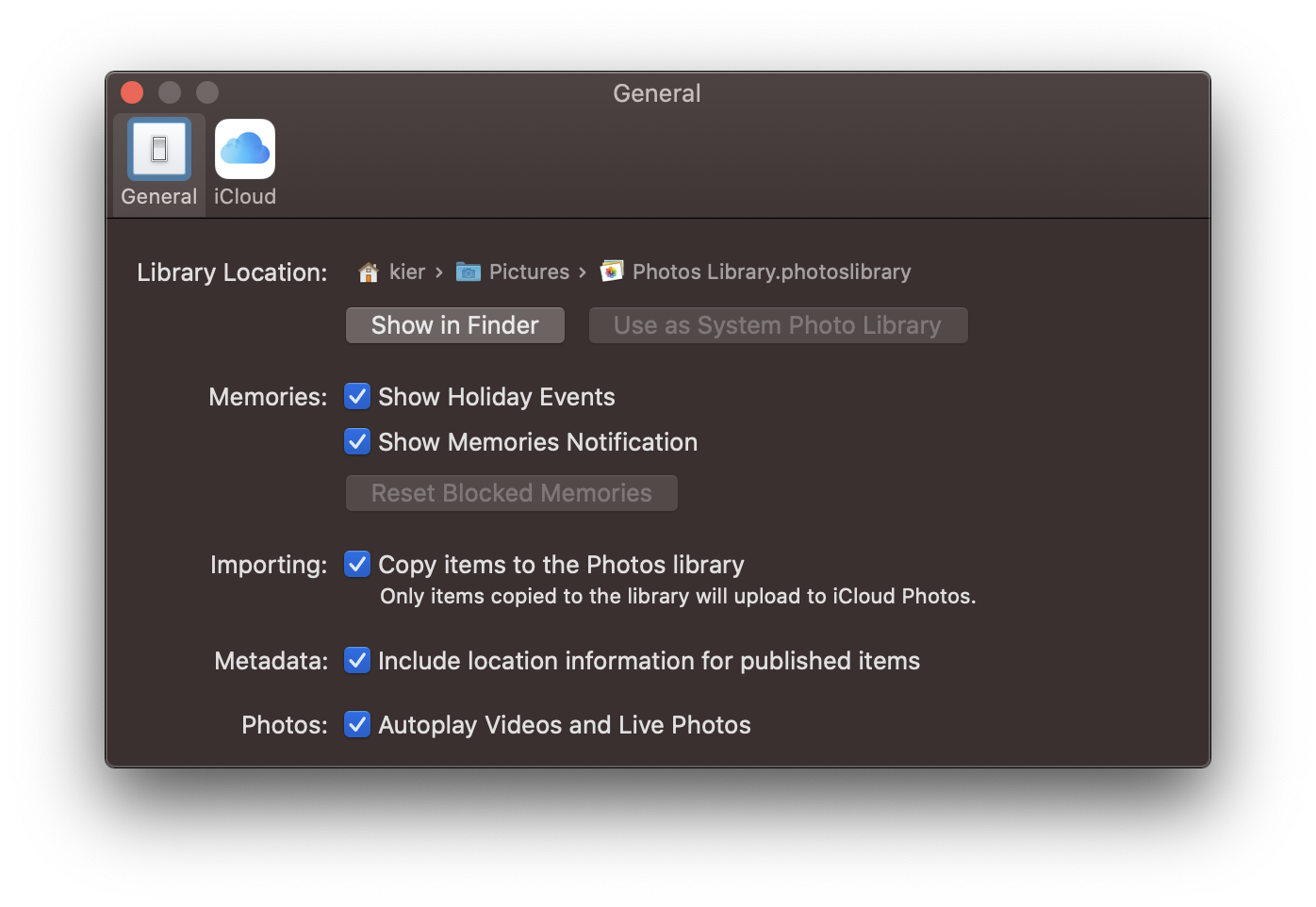

Now that the LaCie drive is remote, when it mounts, its path is still /Volumes/LaCie, and the old photos library lives there too, though I can't use it with this Mac, because Photos doesn't support network storage for its library, so now I use a local path...

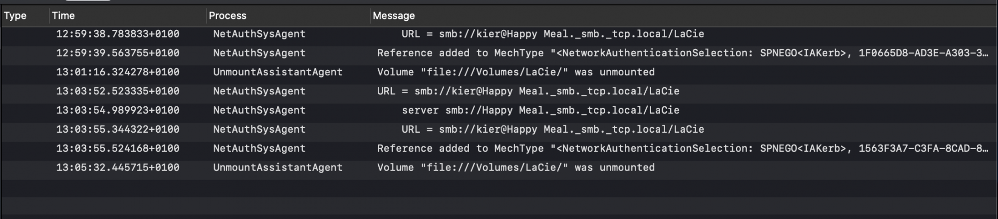

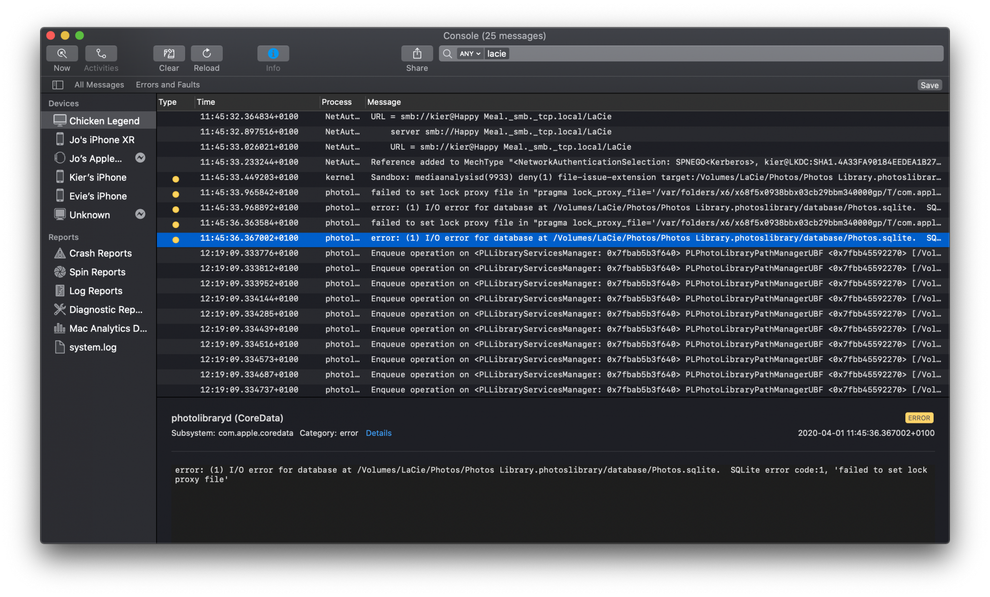

However, I've just spotted some logs from a few minutes ago showing Photos attempting to address the LaCie drive. This is almost certainly the cause of the reconnections - but as far as I can see, Photos is not connected to the LaCie drive in a way that is controllable by the end user. Does anyone have any ideas how to break this connection?

I've found an SQLite lock within /var/folders/x6/x68{gibberish}/T/com.apple.Photos.Migration/sqliteplocks:
Code:
kier@Chicken-Legend % ls -lh
total 64
-rw-r--r--@ 1 kier  staff     0B 31 Mar 17:09 _Volumes_LaCie_Photos_Photos Library.photoslibrary_database_Photos.sqlite:auto:
-rw-r--r--@ 1 kier  staff    32K  1 Apr 11:45 _Volumes_LaCie_Photos_Photos Library.photoslibrary_database_Photos.sqlite:auto:-shm
I wonder what will happen if I just zap these files completely

The keychain mention was simply, you had stored the creds so future connections would occur without prompting. But applications can store credentials in keychain as well, so that might explain the reconnects without cred prompts.
