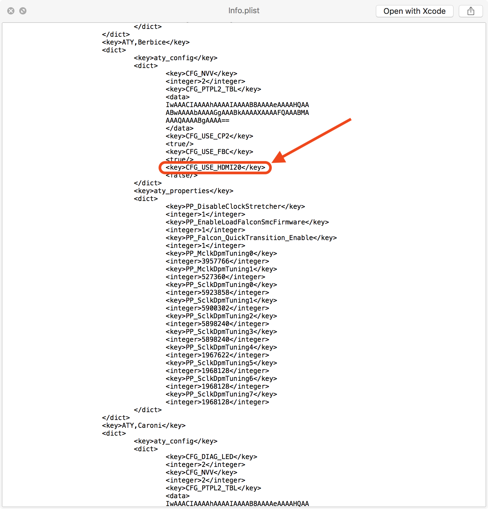

Member Éric 69 just confirmed that the RX580 now can display 4K 60Hz via HDMI port natively in 10.13.6. NO DP -> HDMI 2.0 active adaptor required anymore.
I opened the AMD9500Controller.kext some time ago, and see this
It looks like something about HDMI 2.0 is now included.
For those have RX580 and need HDMI 2.0 connection, can you try if it works natively without any adaptor in the latest 10.13.6?

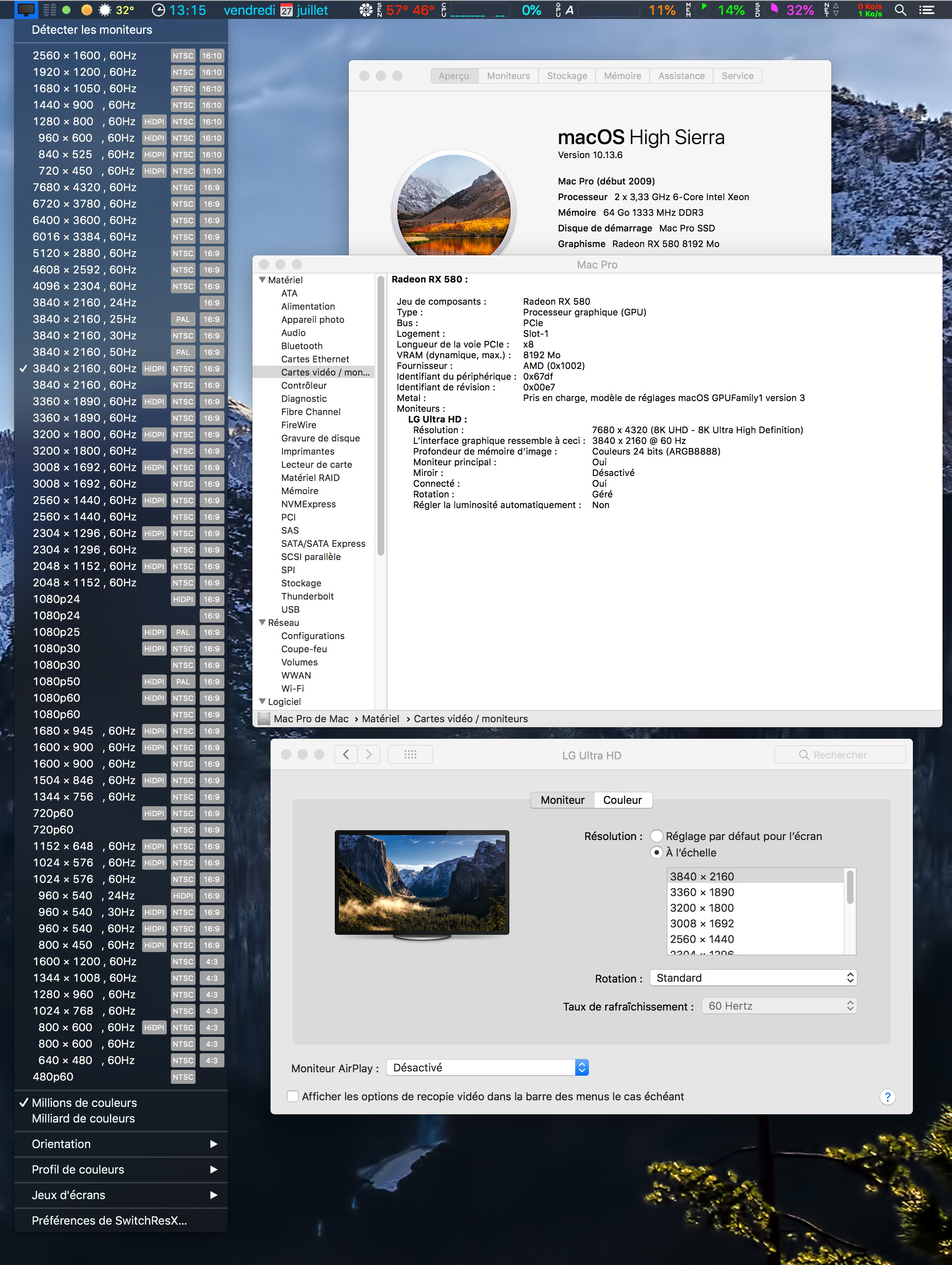

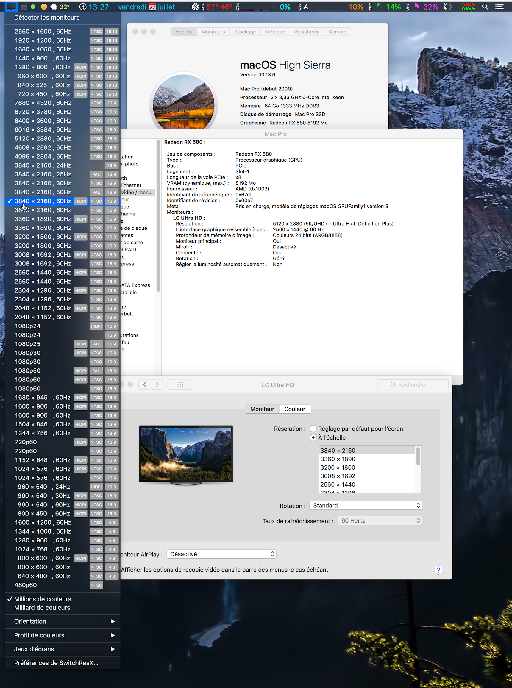

Yes it was me.
As h9826790 wrote,no DP -> HDMI 2.0 active adaptor required anymore.
I have now 4k@60Hz chroma 4:4:4 on my monitor and my 65" Oled tv without to active "Pc mode" or "HDMI Ultra Deep Color" in the settings and without active adapter (1080 Club3D)simply by connecting an HDMI 2.0 cable from my RX580 to the HDMI 2.0 port of my tv and monitor.
I no longer use the DisplayPort with which I have "screen flickering" issues.
On my RX580, I noticed a much better picture quality through the HDMI 2.0 port compared to the DisplayPort;via HDMI the picture is simply awesome on my 65" Oled tv.
I wonder why there is such a large difference in term of picture quality , I have long thought that the DisplayPort was superior to HDMI 2.0 ... ?
Finally no matter, the most important now is that I am very satisfied.
I want to thank all members of this wonderful community particularly h9826790 who wisely advised me and helped to make the right choice in my acquisitions.
Thanks to all and long life to MacRumors !!!
