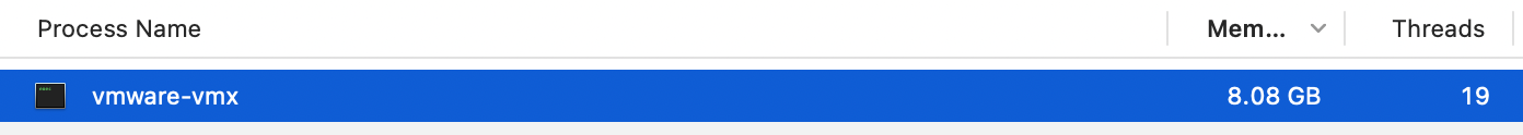

I have an M4 mini 24/512 and am currently running just one Vmware Fusion Windows 11 VM. It seems to sit stubbornly around the 8GB level - but I'm not pushing memory usage. It might change if there were any memory pressure.
