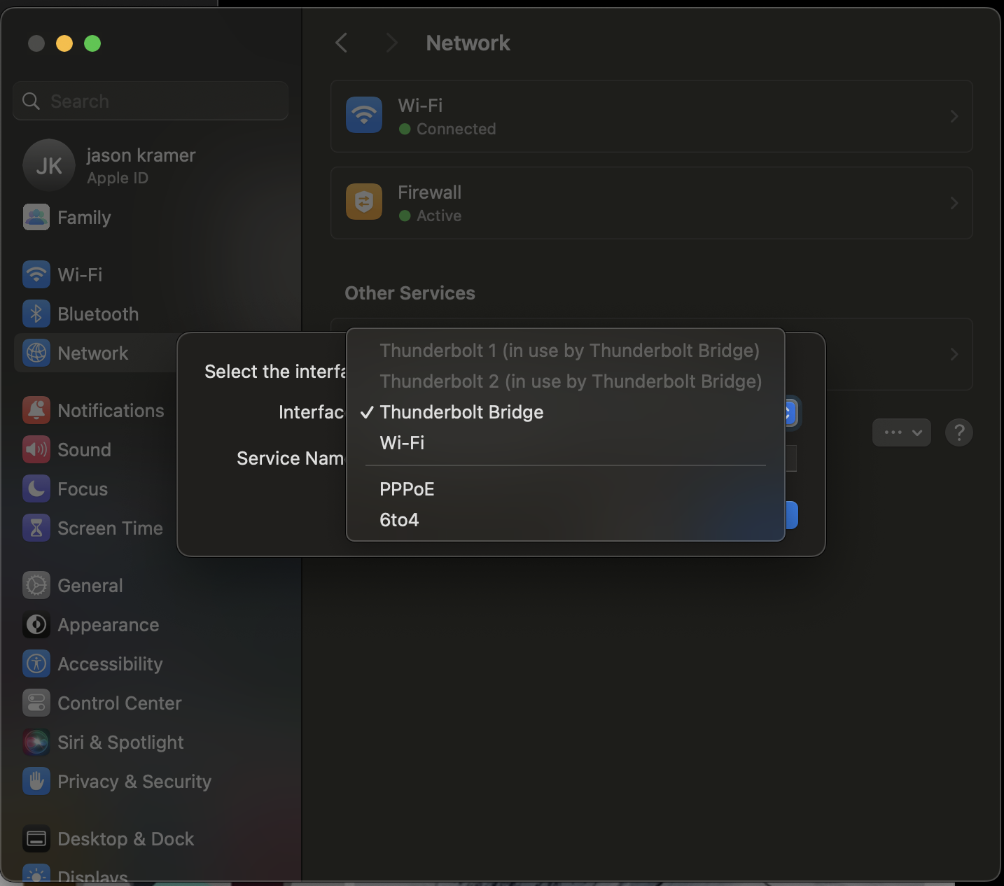

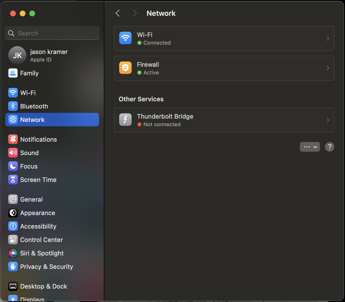

I cannot use my ethernet port on my iMac. Has anyone else had this issue or have any ideas on how to fix? I don't know where to go. I have tried to manually add one and it's not even an option. I ran diagnostics in recovery mode and it does not show any issues pending. I am trying to figure this out and I am getting nowhere.

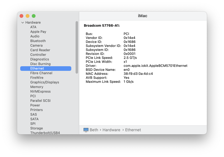

Does the Ethernet adapter exist?
It is from a 2019 iMac, but yours should be very similar.
If not, you have a hardware fault.

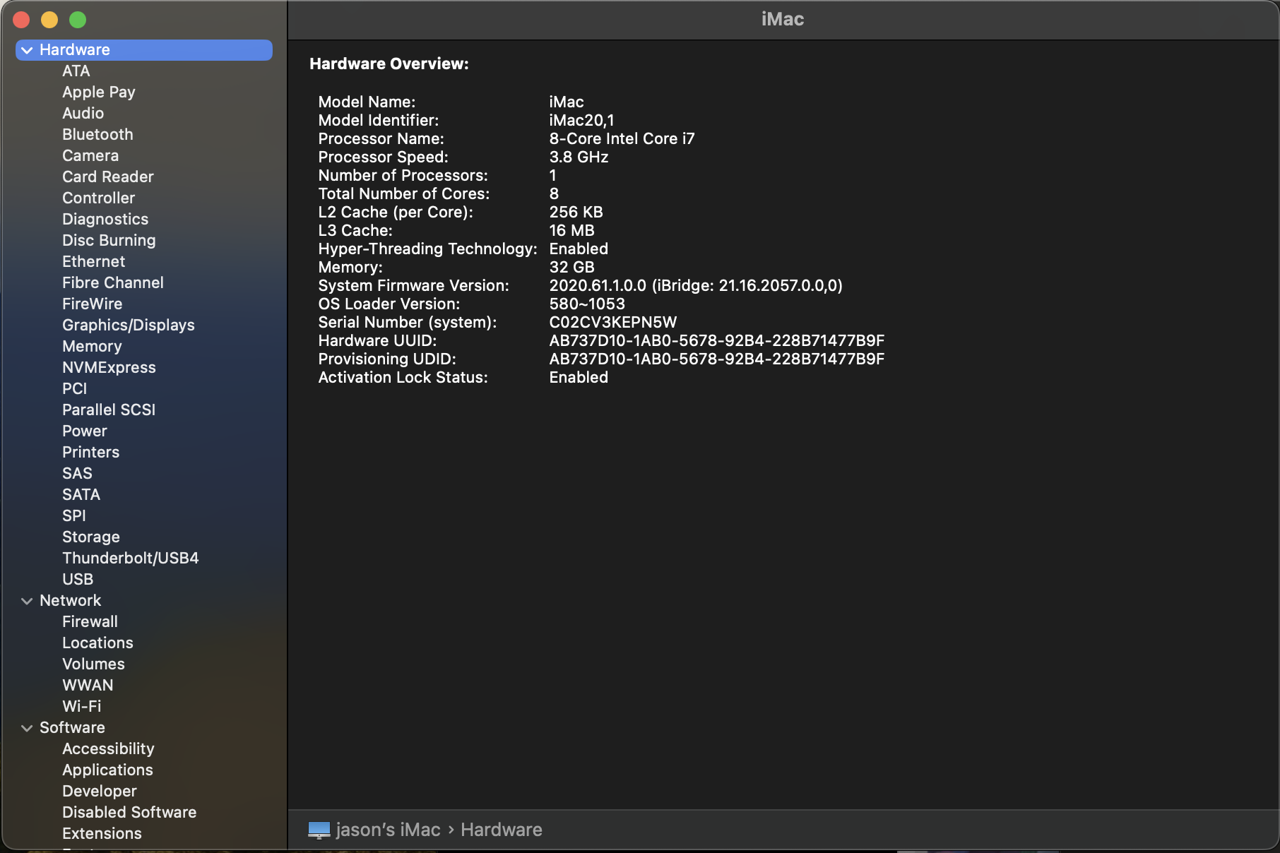

Not an answer to your question but please obscure the serial number in you pictures as this could be used for a hackintosh. Not security issue for you but is not a good idea to post this information on an open forum
There is nothing wrong with hackintosh , i use one but it is generally accepted it’s not best practice to post your serial number online. Just a friendly warning your choice in the end.

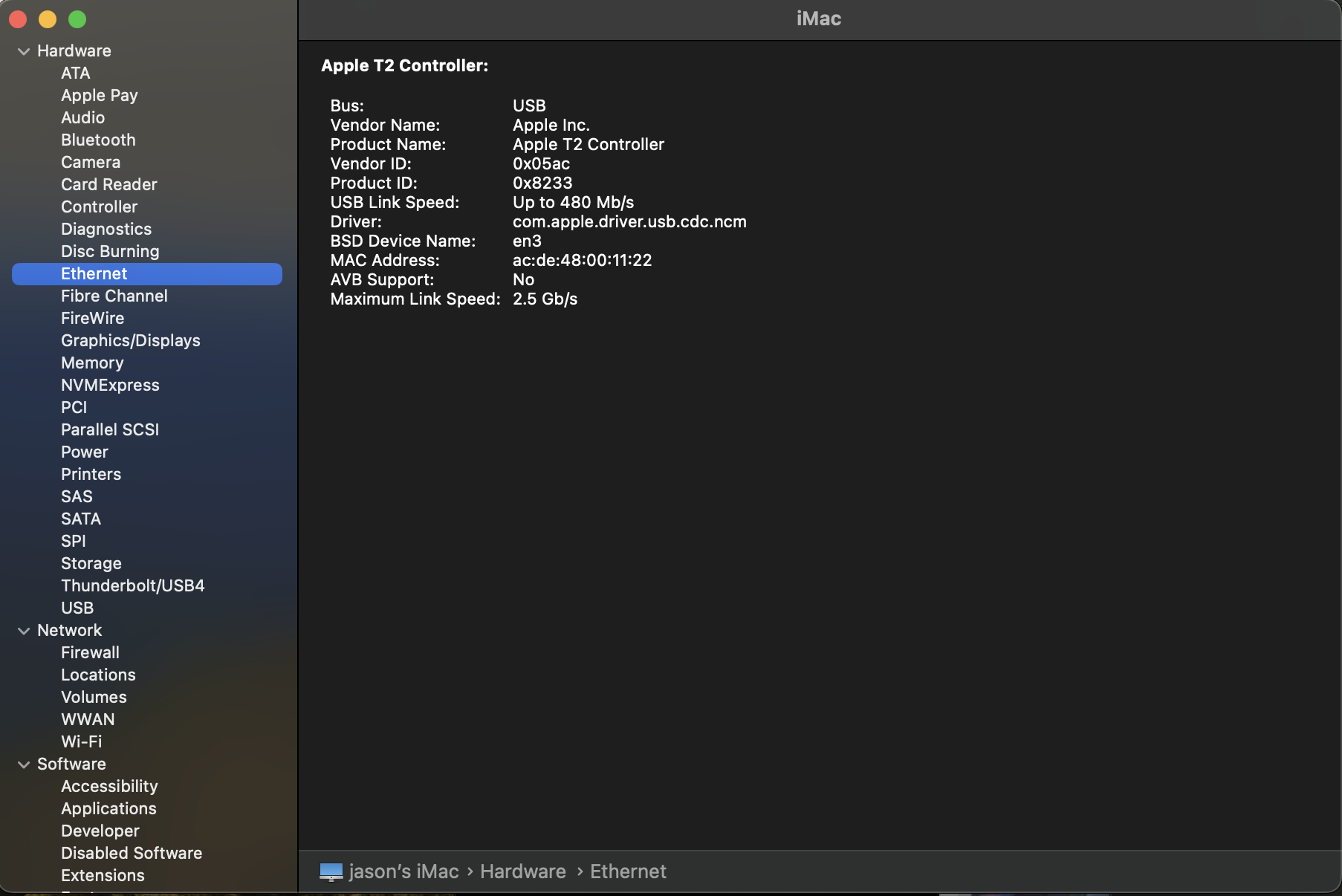

Neither am I! I was forgetting that you had the T2 chip. But it looks odd to me: USB controller, 480 Mb/s and en3. Do you have a USB hub connected which has an ethernet port (even though not connected)?
You need a reply from someone with a 2020 iMac.
I did at one point but I don't use it now.
