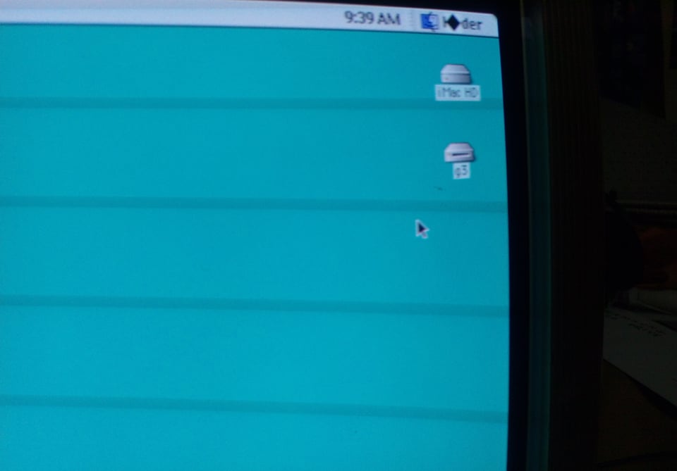

Tried a USB DVD Drive but sadly the machine doesn't recognize it
As for a USB Flash drive, it did read the drive but however everytime I try to transfer a Stuffit file, I keep getting an error saying something about the expandable being extracted by a PC so it won't work here

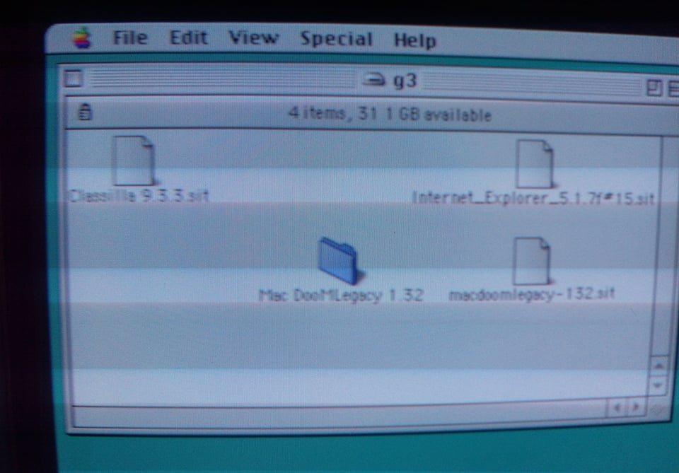

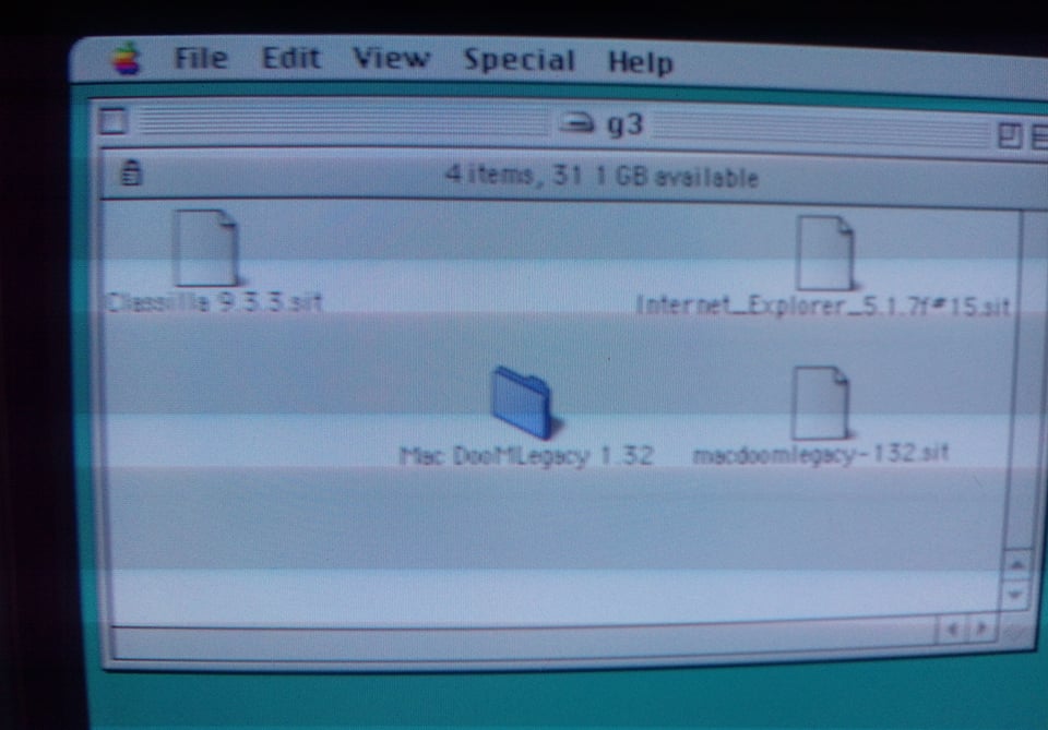

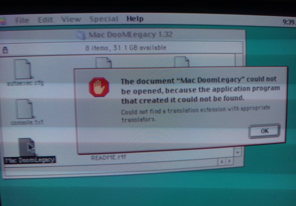

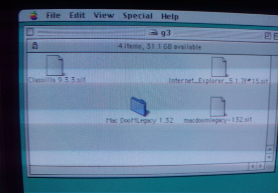

I'm moving the files from the usb to the Mac's HD then trying to unstuff them

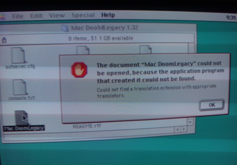

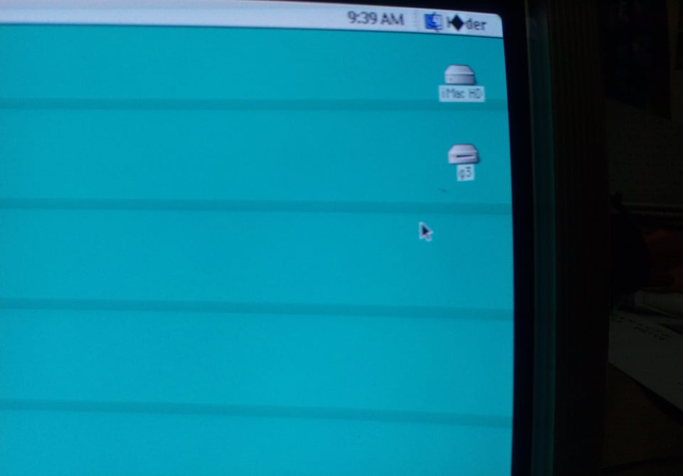

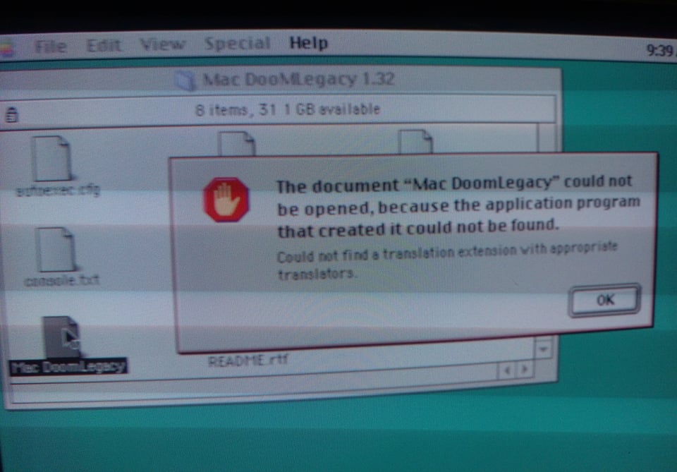

So good news is, I can finally have a pen drive to transfer files
Bad news is, the files I want to install aren't working and are giving me this error
Even unpacked one of the stuffit files to see if it would run but I was wrong
I have read about problems with resource forks and non HFS volumes. I've never run into the issue myself, especially if it is properly compressed. I'm not sure what else would be causing that error.
Have you tried moving the compressed stuffit files to your iMac's HDD and then uncompressing them?
Do you have any other Macs or just this one? Where did you get the files you are trying to open? I am certain DoomLegacy is available on the macintosh garden if yours has become corrupt.
