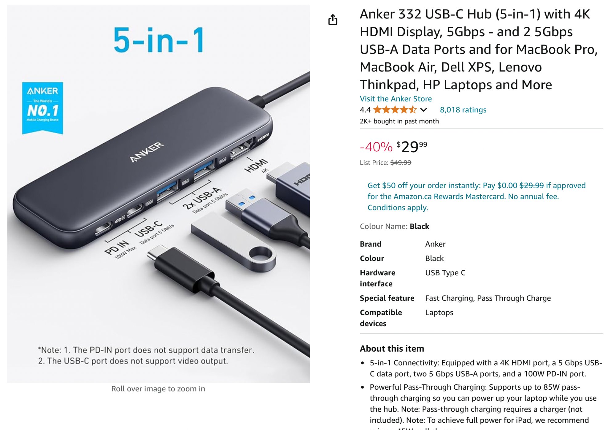

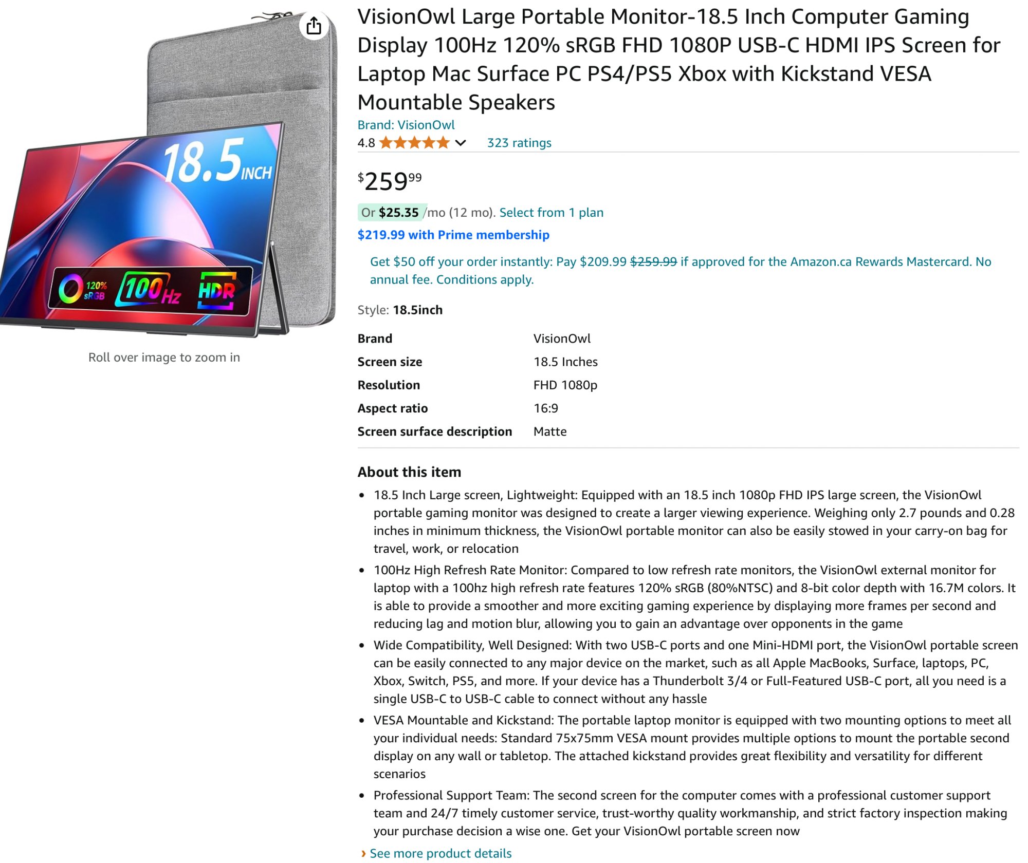

So Im new to stage manager and trying to make this work with my ipad air m2 13. When I was first using this portable monitor it was with my macbook pro m1 16". All I needed was a usb c cable (thunderbolt?) that came with the monitor that somehow could power the monitor and extend the screen at the same time. Didnt need the included hdmi cable.
Now I tried with my ipad with this anker hub i have and it wasnt enough power to run the display On the portable monitor. 67w brick in wall plugged into anker hub usb c power 100w with the same usb c cable from before plugged into the hubs usb c data port and attached to the portable monitor.
So I'm basically just wondering what im doing wrong and what kind of hub should i be looking for? Is the issue that I am trying to use the usb c data port on the hub when that should be another thunderbolt port?

you have to use HDMI. The hub has no thunderbolt/display port functionality via the usb-c ports.
It does support video using the USB-C port according to the item description.
“If your device has a Thunderbolt 3/4 or Full-Featured USB-C port, all you need is a single USB-C to USB-C cable to connect without any hassle”
That's the item description for the monitor. The 'device' in this instance is the hub, which does not support Thunderbolt. Only 1x 5Gb USB-C.
ETA: Sadly, the hub's HDMI port is also likely maximum 4k/30hz which is going to look super janky even if OP decided to go that way.

Thanks Mr. Lahey. Is there a specific style hub I should be looking for to make it work? At the very least a hub that would provide 60hz through hdMi?
Ok thanks. Do you think it's possible to find a hub in the sub $100 range that would offer the proper usb c display port alongside a power delivery port?
Easily. E.g., this - or just a USB-C to display port adapter with power delivery (? ~30€).
Honestly it's a bit of a minefield using hubs for this sort of thing. Doubtless you'll find one that does 4K/60 over HDMI but in my experience you're better served saving time and just buying a full-fat Thunderbolt dock. You'll have to spend a couple of hundred bucks or more but IMO do it right or go home.
The OWC 14 port Thunderbolt dock goes for $160 but it goes on sale sometimes.
