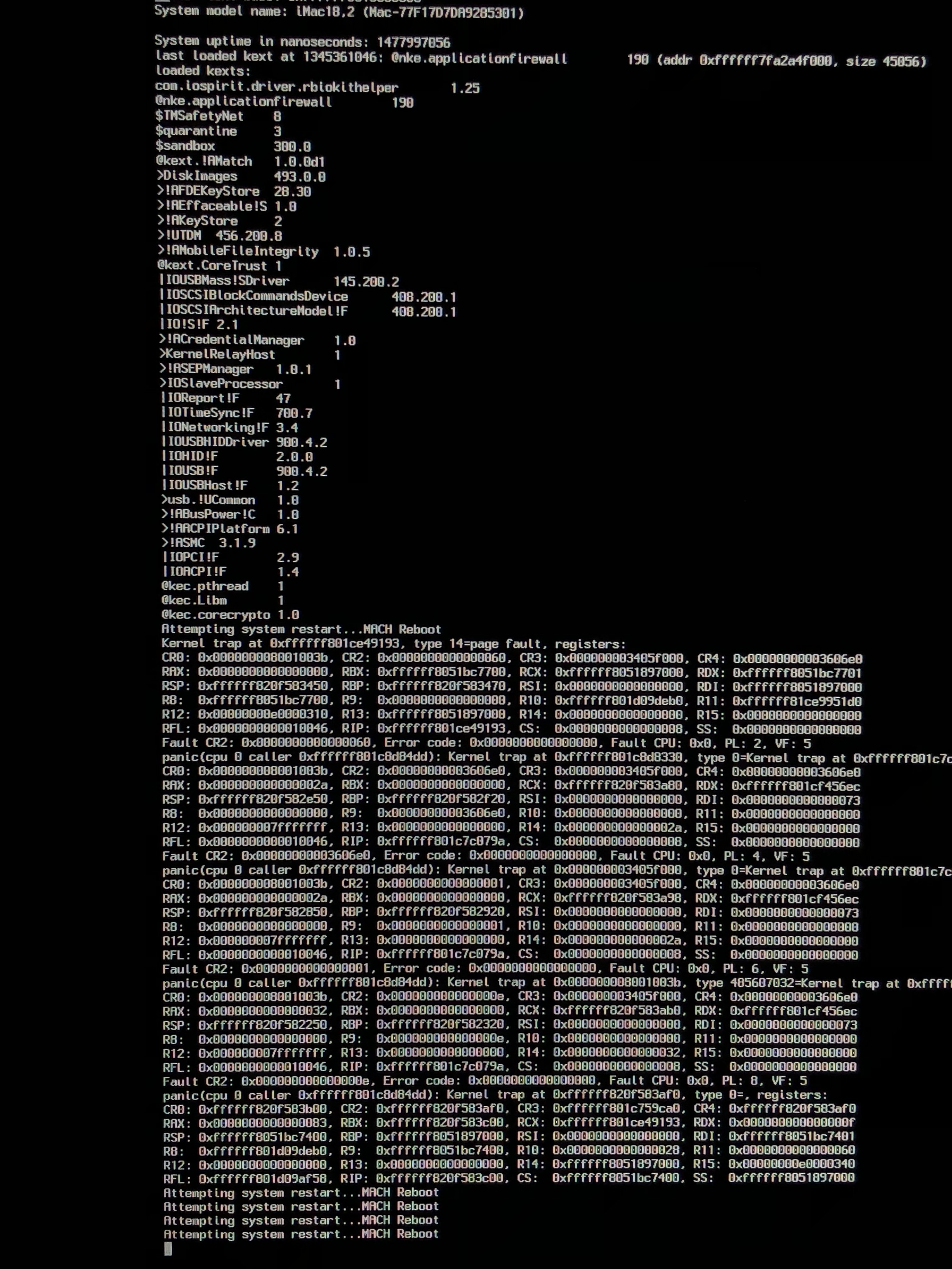

I’m just about ready to follow the advice there, however I learned about verbose mode and was able to see that the issue is due to a kernel panic but the rest of it is Greek to me.
I only see the end of the verbose screen because the rest shoots by too quickly. I have read that some people had issue with third party kext files and I do see a kext file there. Can anyone make anything of this photo I’ve attached of the screen? Does it indicate anything actionable. I’m just about ready to do a command R reinstall of the OS but for some that doesn’t seem to fix their issue so I thought I’d pause here to ask about this.

Ok, what’s in this log is not the kernel panic on boot but apparently the last thing the computer was doing when my mother started having problems (Safari seemed to freeze up) and she killed everything by long pressing the power button.

I just copied the last part of it till it ends.
I notice that it references (com.iospirit.candelair.sync). This is also the kext it reports in the verbose boot before it kernel panics.
Candelair is a software program that worked with the older iMacs with IR remotes. This is basically junk left over from years ago that I thought had been uninstalled. If this is the culprit how do I stop it from being loaded as kext at boot up by accessing the disk via target disk mode? Let me know whether coping more of this log will help.
[doublepost=1542849740][/doublepost]Could it be that this leftover bit of software was trying to run and my mother pulled the plug and corrupted it?
Can I get to 3rd party kexts via target disk mode and delete them so macOS doesn’t try to load them on boot? Where are they located?
[doublepost=1542850690][/doublepost]That was it.
Problem solved. I went into Library/Extensions via Target Disk Mode and deleted RBIOKitHelper.kext and the next boot went off without a hitch.
