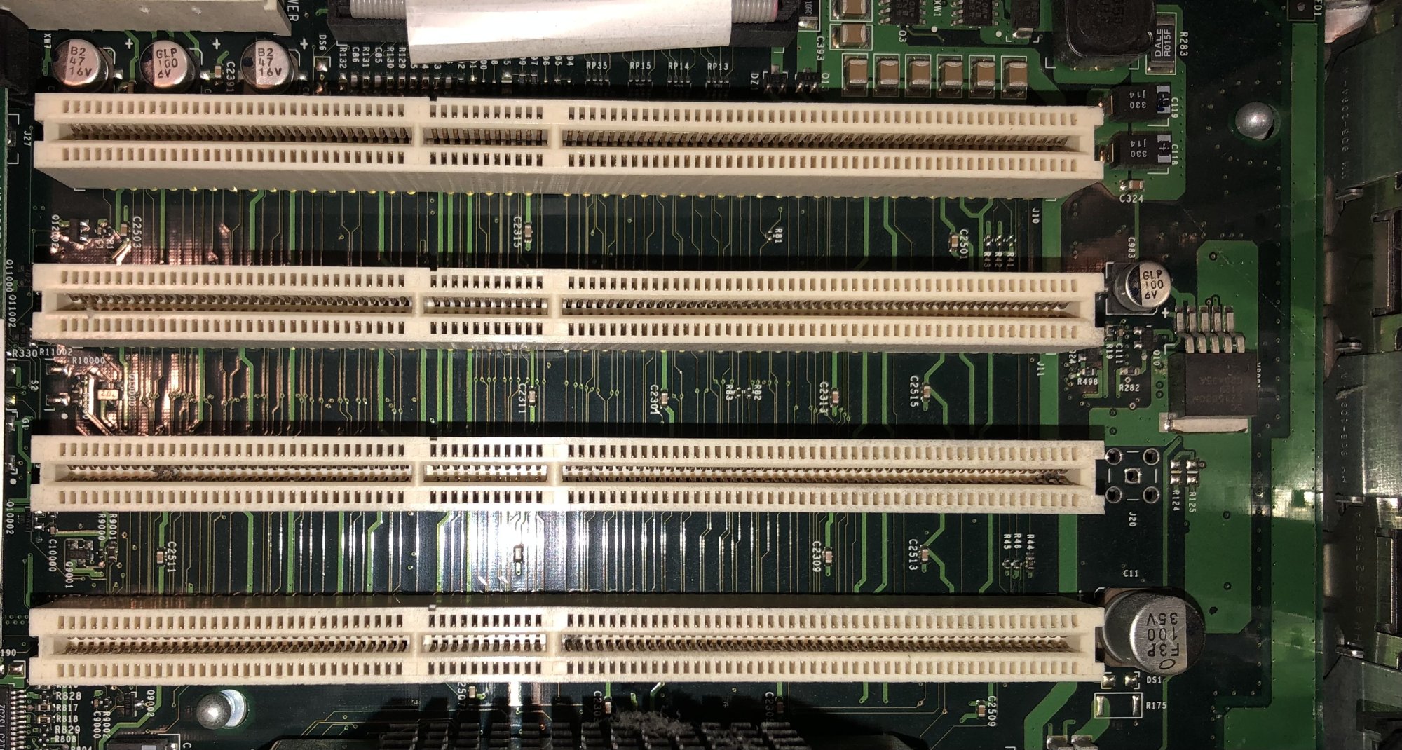

I picked up a slightly newer Power Mac G4 3.5/M8493 and it has 4 PCI slots but i can't quite figure out what sort of PCI SCSI card I should get for it.
Looks like three batches of pins - 32-11-49 adding up to 97 pins total. Mac Tracker says I have 4 - 64-bit 33 MHz PCI bays, and 1 - 4x AGP - but no mention of the total number or the configuration of the pins.

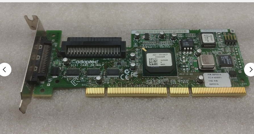

Slots are PCI64. Suitable adapter - Adaptec 29160. PC version requires chip with fimware replacement & reflash (can be done in OS922 firmware upgrade). USB ports AFAIK are USB1.1, it'll take eternity to copy something really big to copy.

Thanks for the tip. Wondering about the extra pins closest to the SCSI ports - my board only takes three sets of pins - this card has 4.
how do I get a Mac version?
Try search your local second hand stores \ web sites? AFAIK Apple branded card was called Adaptec PowerDomain 29160. You can try official firmware upgrades from adaptec\microsemi site (I've downloaded them m.b. around 3-4 month ago). Despite my card is PC version, flasher detected it, but couldn;t complete flash because of smaller (by half) PC EEPROM chip size. And it need to be done in Mac Os 9, AFAIK Classic mode of Tiger & Leopard didn't works.

PowerMac3,5 - M8493 is Apple Power Macintosh G4 867 (Quicksilver). It as 33 MHz 64-bit PCI slots.
https://everymac.com/systems/apple/powermac_g4/specs/powermac_g4_867_qs.html
The slots of the G4 appear to be 5V 64-bit PCI Slots.
https://en.wikipedia.org/wiki/Peripheral_Component_Interconnect
The slots can accept 5V cards and Universal (3.3V & 5V) cards. The cards will run at 5V. The slots can accept 32 bit and 64 bit cards.
That card is a Universal (3.3V & 5V) 64-bit card. So it should work if it's a Mac version.

The card shown above have low profile bracket, better to find another or ask seller about standard sized.
It WILL work, even if it isn't Mac version :D. But... in Linux :D. (Tested such card in Canister, Debian detects it at startup without problem). I wanted to connect IBM\Panasonic DVD-RAM drive, which can use cartridge disks. Project on-hold now.
