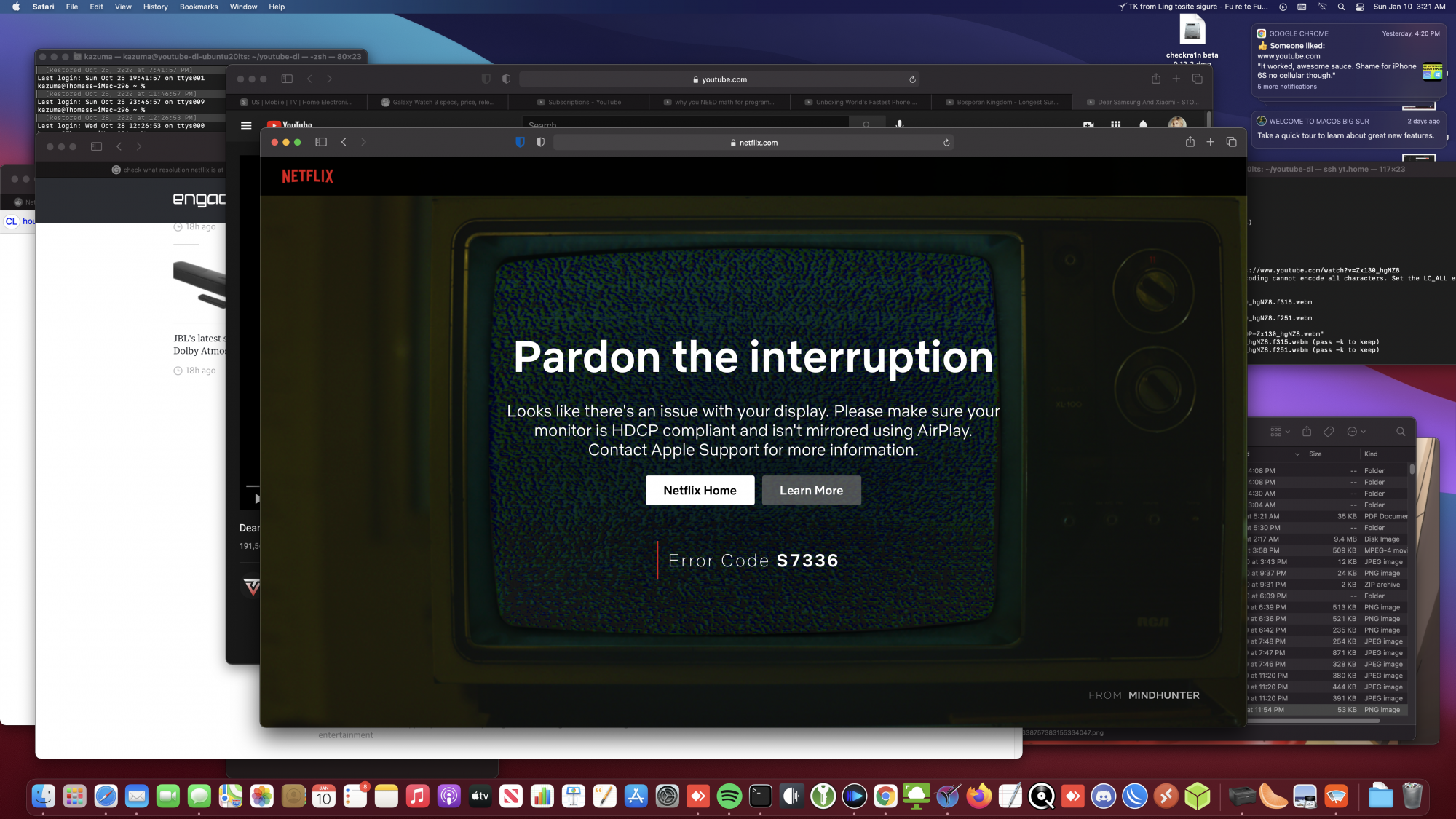

I do not have an external monitor, only the built in iMac display.

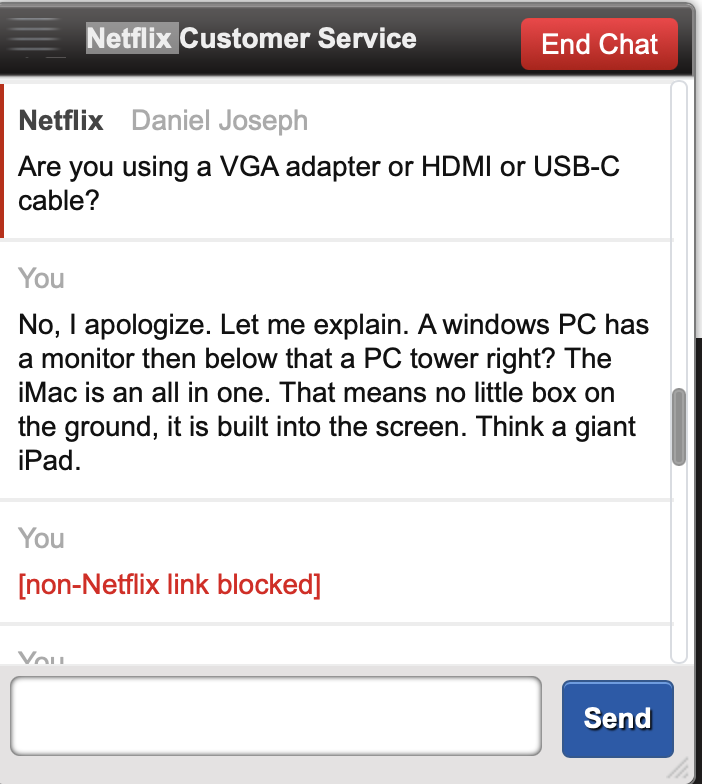

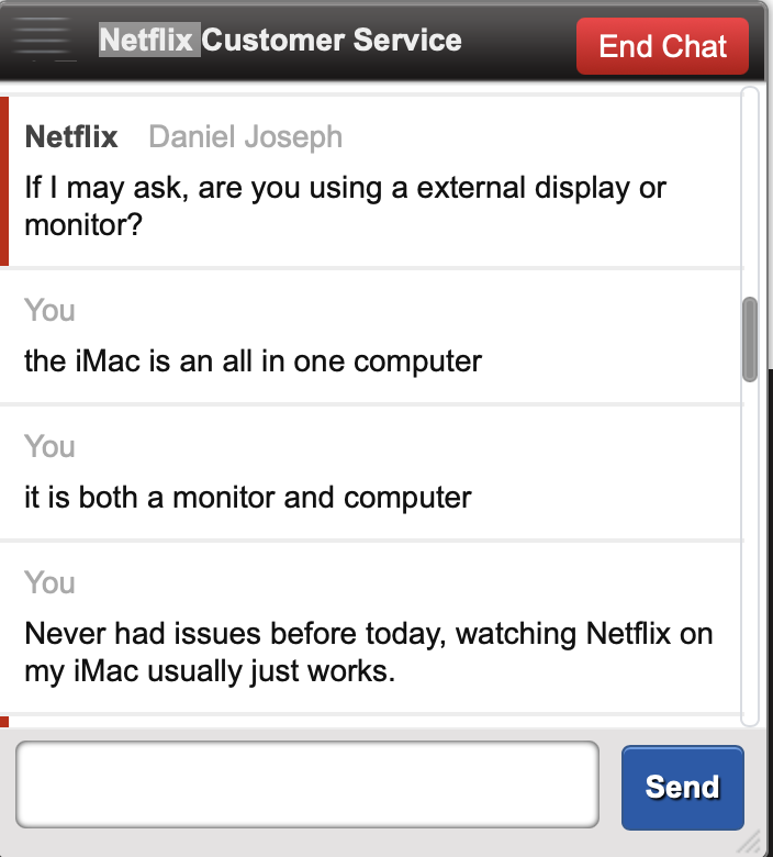

Tried going to Netflix support and the agent kept insisting it must be my HDMI or VGA cable, no matter how many times I attempted to explain the lad just seems to not get it. The second agent over the phone wasn't any better.
The steps I've done so far:
Cleared cookies and cache, then restarted safari, no dice.
Did the above then restarted iMac, then tried to watch Netflix, still not working.
What else can I try?
Big Sir 11.1 and Safari 14.0.2 - Error S7336.

Do you have SIP disabled? I wouldn't think that has an effect, but if SIP is disabled try enabling it to see if anything changes.
My iMac works as long as I don't have the sound going to my receiver ( I use USBC from the output on the iMac to a HDMI on the receiver ).
If I unplug that and launch Safari, it plays with audio and video on the iMac. If I have sound going to the receiver, Netflix thinks I'm sending video as well and gives the error. Weird.
Even weirder, other browsers work with the cable plugged in so it seems down to a combination of Safari and Netflix
