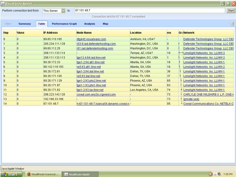

When running a traceroute line quality check, http://www.dslreports.com/linequality), my line quality test results came back good (pass), yet on the traceroute host list I show a host titled "???" that is one hop before my IP that shows 100% loss. 100% loss should fail the test shouldn't it?
Using another trace I can see that this unknown IP is 192.168.33.166, which I thought was a private local designation, yet I am not using this IP on my equipment.

Still, how do you explain that this "???" server is 192.168.33.166? I assume you are familiar with this IP designation? What's you spin on this?
192.168.0.1 is the IP for my earthlink DSL modem. If I connect my DLink Router to my modem so that I can connect my mac online, does this mean that the modem and the router are using the same IP? I'm trying to determine where this additional local IP is coming from? (192.168.33.166).
I'm not sure I understand where you got this IP address from. Can you post your traceroute? (Command and output) If you run traceroutes from 2 different locations you'll get 2 different results, so I don't understand what you mean when you say that ???=192.168.33.166.
The first few hops will be in your local vicinity. If you see a hop that is outside your local network followed by a farther hop that starts with "192.168", then that is weird. A remote computer can lie to you about its IP address, but that would be abnormal behavior for a router since I think it would wreak havoc on adjacent routers.
