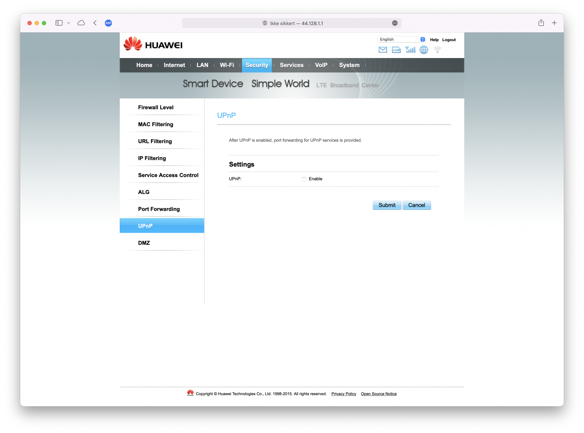

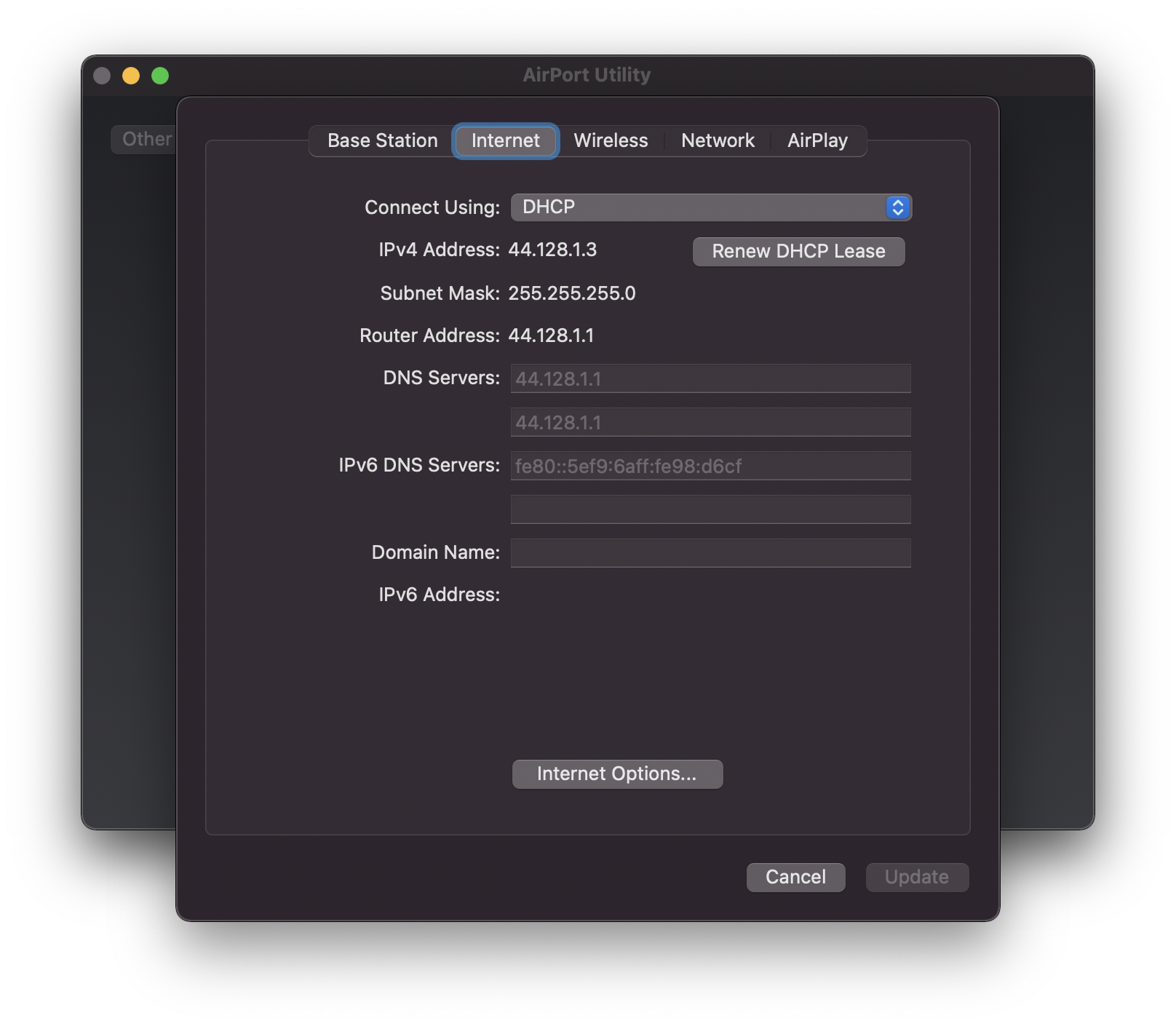

After getting lots of HomeKit devices running over wifi I'm getting lots of connectivity issues. Often the connection becomes insanely slow or drops completely, but only for a single device or a few devices, while the others continue at full speed.

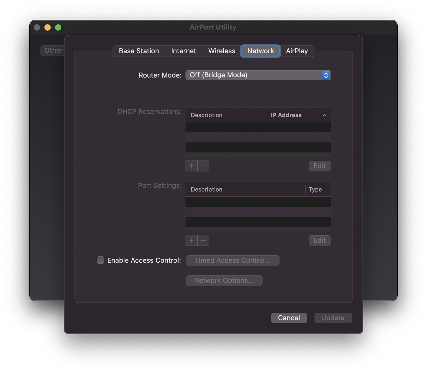

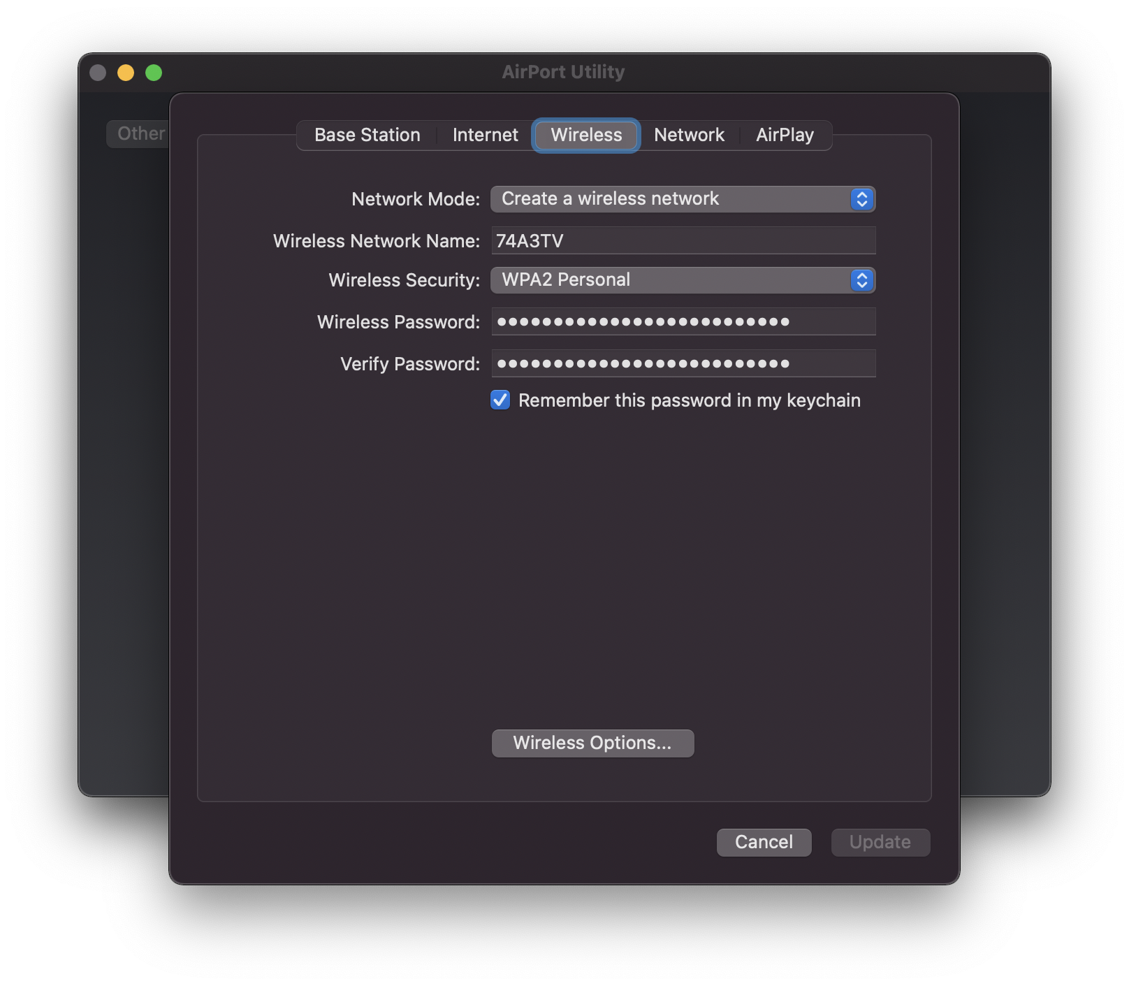

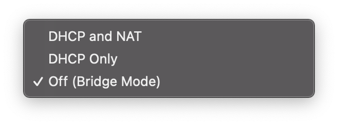

I have a 4G Huawei router with lousy wifi strength, so I have disabled the wifi in it, and connected an Airport Express via LAN to the Huawei router to run my wifi (bridge mode). I have a feeling that the problem is some kind of mismatch in the settings between the Huawei router and the Airport Express, but I don't know how to solve it.
I've attached my current settings as thumbnails and hope that some of you can guide me in the right direction?

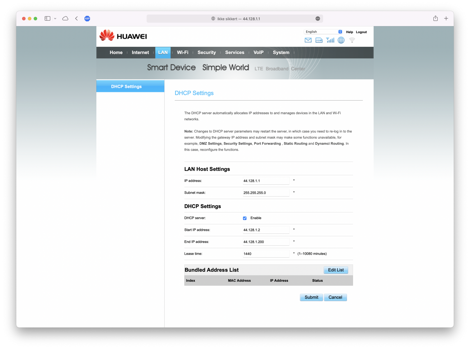

See link above - Assuming the Huawei is doing NAT, you should try using a LAN address pool in one of the above ranges and not a public IP range. That alone might explain the performance problems you're experiencing.
In screenshot 1, edit all those IPs (LAN Host and DHCP Settings) and change the 44.128.1 portion in each entry to 10.0.0 so you end up with IP address = 10.0.0.1, Subnet mask unchanged at 255.255.255.0 and DHCP lease range of 10.0.0.2 to 10.0.0.200
Restart the router and the computer/device you're using to manage it, then reconnect to the management interface using its new LAN IP of 10.0.0.1
Once you've re-established the connection, reboot your Airport Express and it should pick up a 10.0.0.xxx IP via DCHP too.
All your other screenshots look good, but it's important to not use public IPs on a LAN with a router doing NAT. If you can make those changes first, then after that you can see if there are still other issues that exist.

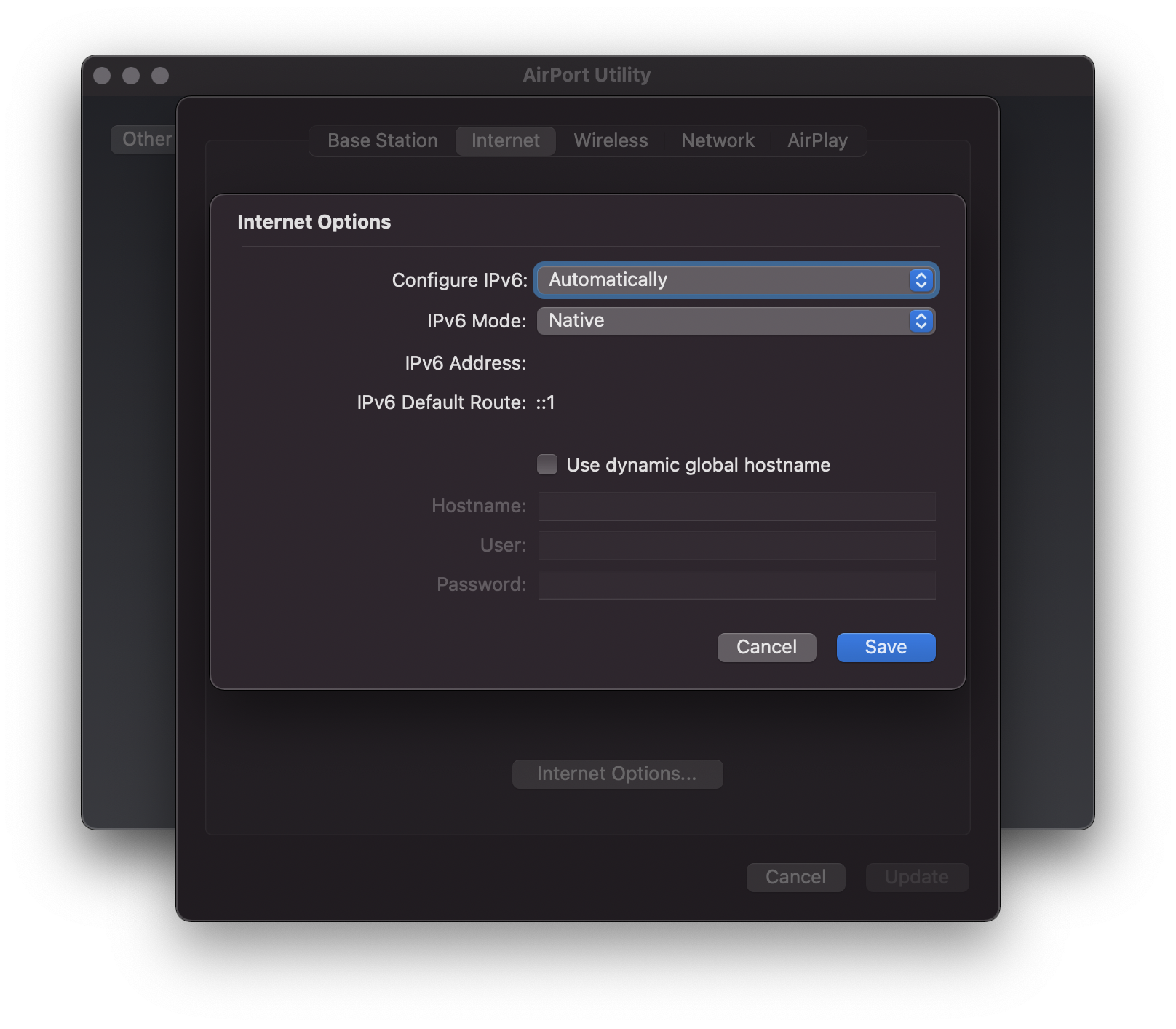

Before I do anything. Your link is about IPv4 and both the router and AirPort Express is set to IPv6. Should I set both to IPv4.
I changed the IP range from the default 192.168.1.xxx to the 44.128.1.x to se if it did anything, because the problem was there before as well.

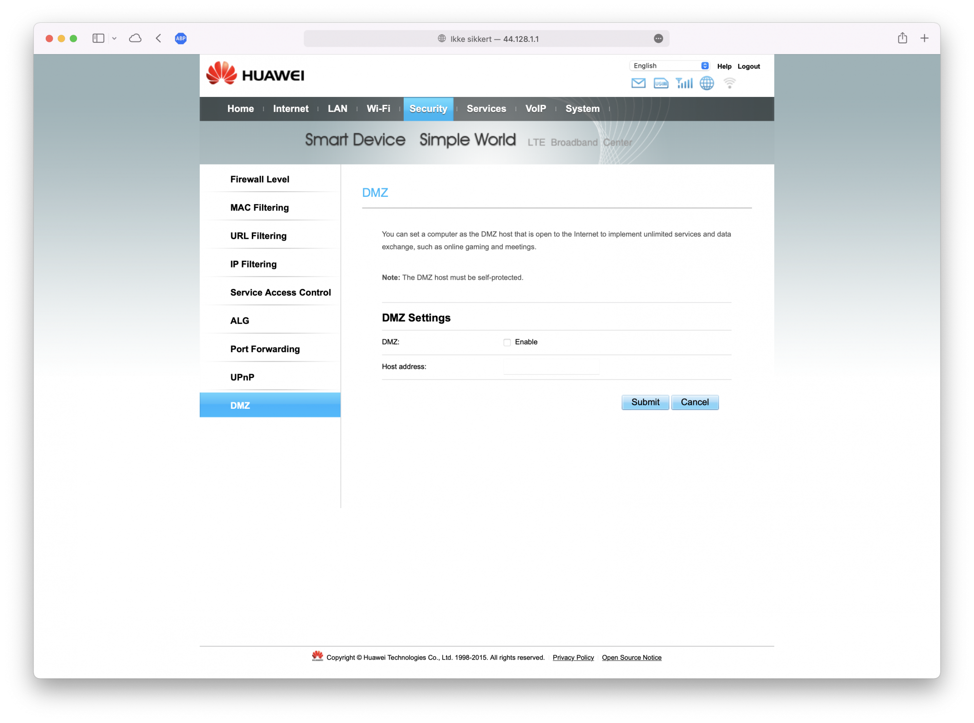

Some people keep telling me I should do DMZ?
Understood. I would either change back to the 192.168.1.xxx or use the 10.0.0.xxx - Either is fine, but a public routable shouldn't be used. And yes, IP4 should be fine internally. If your Huawei has a public IPv6 address, let it worry about that.
No on the DMZ - That bypasses the built-in Firewall on the Huawei and unless you have a good reason to bypass that, I wouldn't do it.
