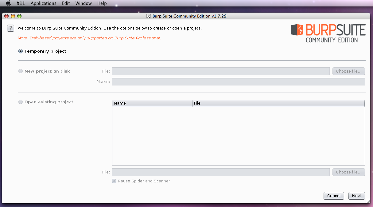

Burp Suite
Official site :
https://portswigger.net/burp/
Download the JAR file here
https://portswigger.net/burp/releases/download?product=community&version=1.7.30&type=jar
Requires JAVA 1.7 , see this guide how to install it OpenJDK 1.7 Java install on OS X 10.5.8

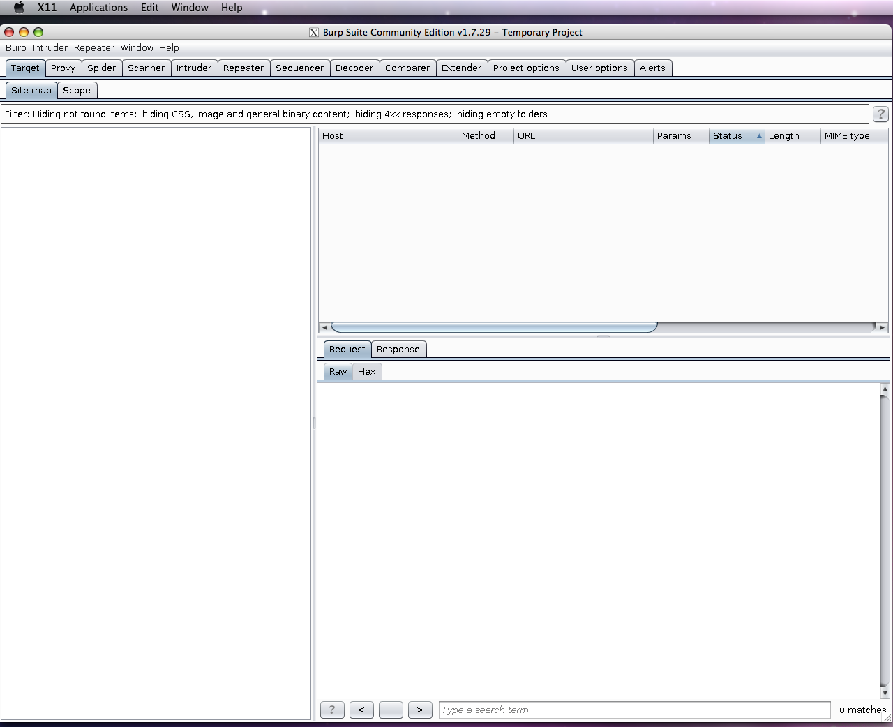

Then start it with , does need 1 Gb of RAM
java -Djava.awt.headless=false -jar burpsuite_community_v1.7.29.jar -Xmx1G
