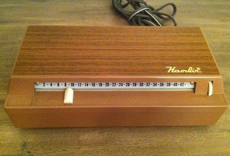

I'm beginning to miss the old CATV days. Anyone else old enough to remember these wired, fool-proof, channel selectors?
