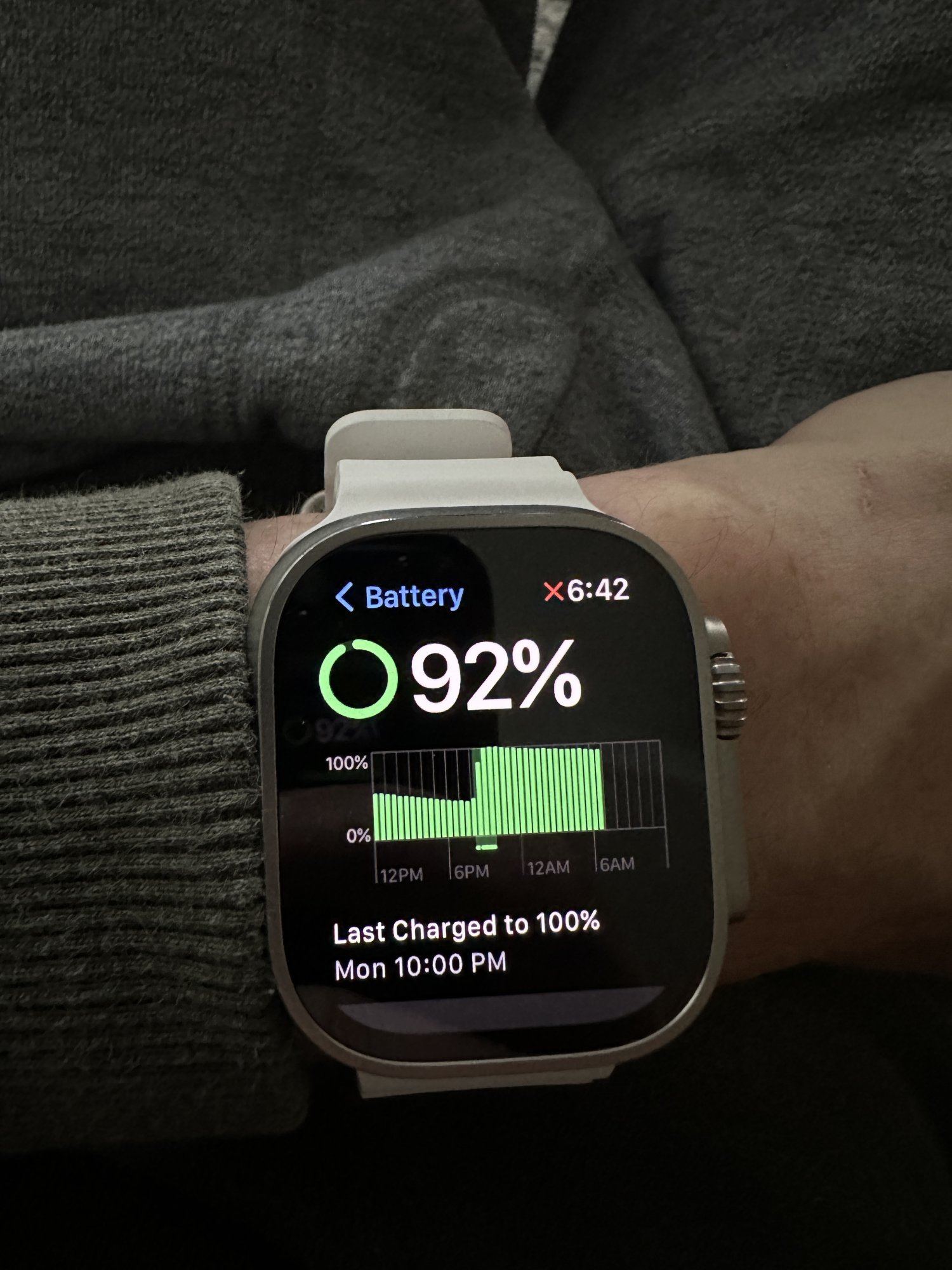

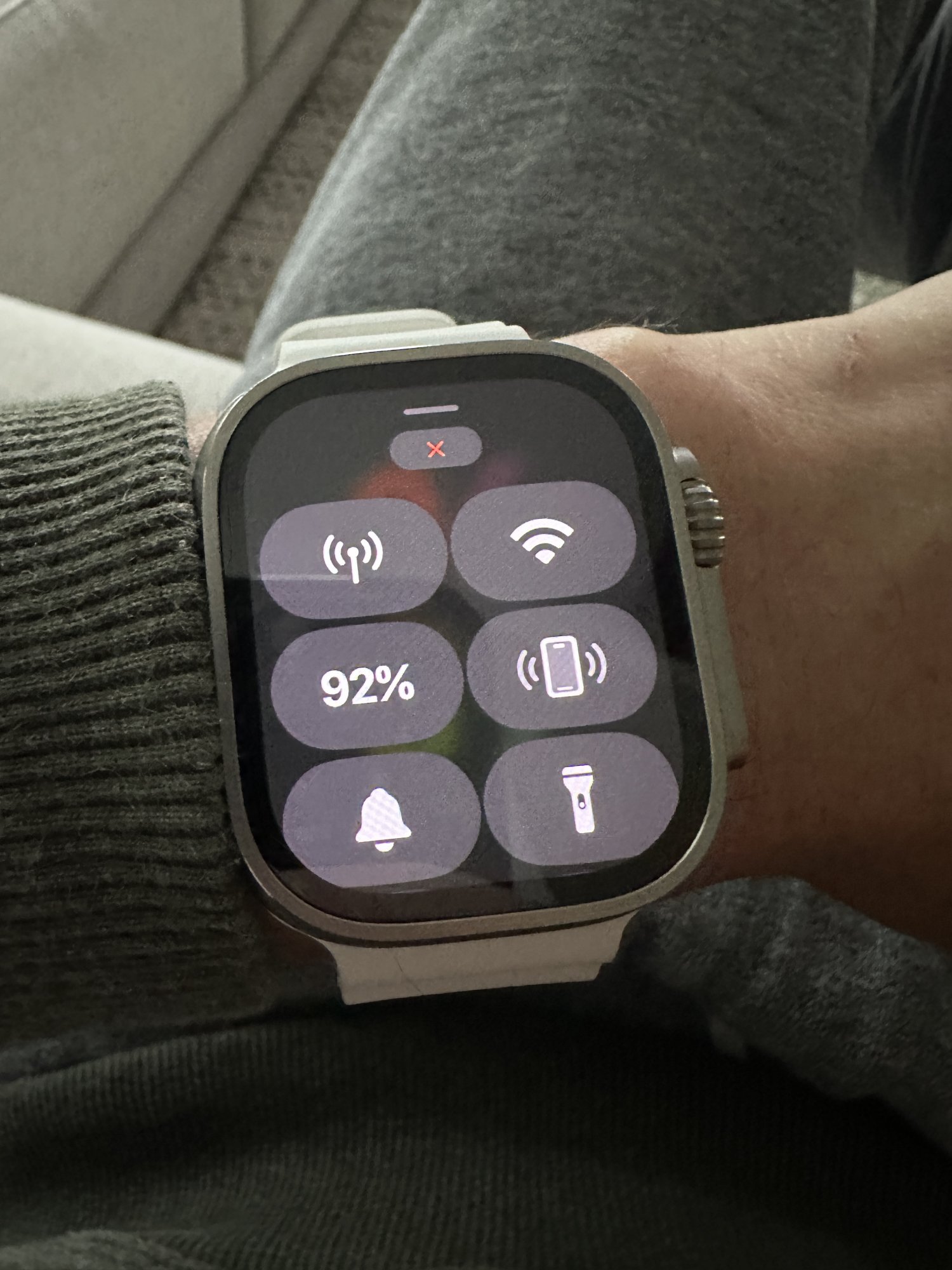

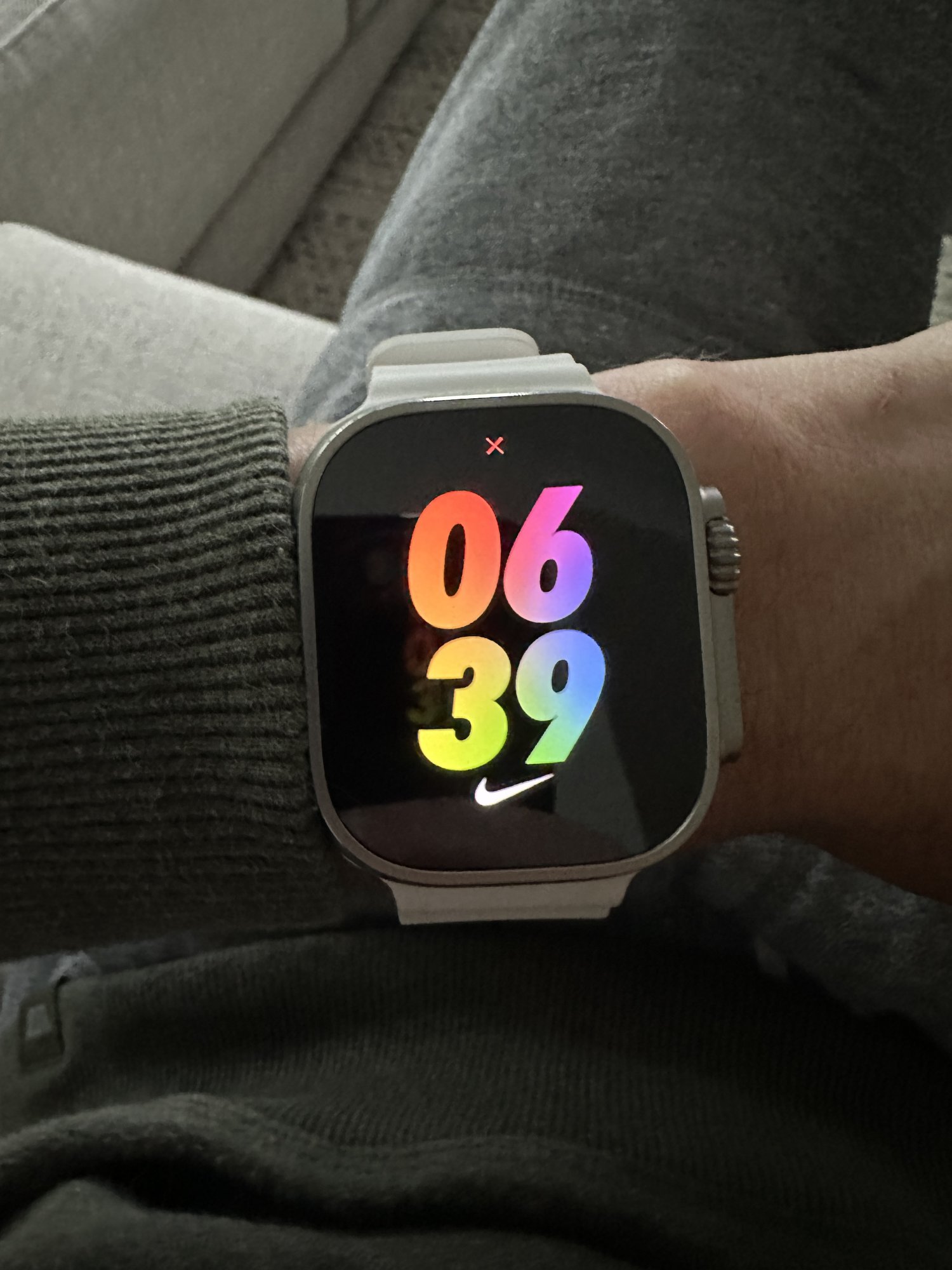

I have a week old Ultra and I charged to 100% 10pm last night woke up 6:30am down to 92%. it's now 1pm and I am down to 86%. VERY minimal notifications received, sitting at my desk. AOD off, wake on wrist raise is off, cellular off and wifi off. Simple nike watch face with no complications. Is this normalize battery life?

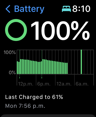

But the series 3 would never suddenly die in the lower percentages like this one does.. that's why I worry.. Here's a screenshot of the battery life throughout last night.. you can see how suddenly around 40% it just dies suddenly..
I have a faulty battery don't I?
(edit: not even 40% ... seems like it shut down at around 50%)
