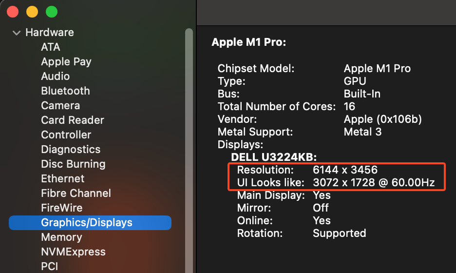

Possibly caused by resolution change?
You may check the display settings, or the Display section from System Information, or the OSD from the display itself.
