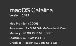

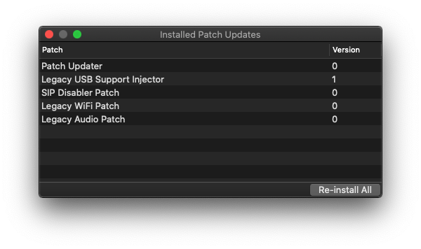

I've just purchased a 5,1 with some kind of Catalina beta.. I think its the dos dude version
thing is the gpu is a Vega 56 and I'd like to update to a more recent version of Catalina
is this possible to do from within macos (without needing bootscreen?)
can I just download the patch and run it?
sorry if this has been asked before
ideally I'd use Mojave (that's what I have on my MBP) - but I see that I'd first have to get an older card to do the install steps
thanks for reading this, any thoughts appreciated

is it possible to get to Mojave with this configuration?
Yes, no problem. Make a createinstallmedia USB installer, remove any bootable disks, insert a new/erased disk, power on your Mac Pro - it will boot from the createinstallmedia USB installer after 3 minutes.
Since USB has the lowest boot priority, you have to keep just the createinstallmedia USB key as a bootable disk or you won't boot from it.
Use the search if you need more info on how to do it.

just download Dosdude Catalina installer, follow the instructions and install Catalina 10.15.7
with this Dosdude method you cannot do automatic updates there is more info on this thread about installing Catalina on Unsupported Macs: https://forums.macrumors.com/threads/macos-10-15-catalina-on-unsupported-macs.2183772/

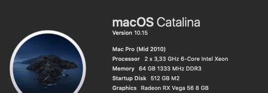

I have a similar set up to you...
