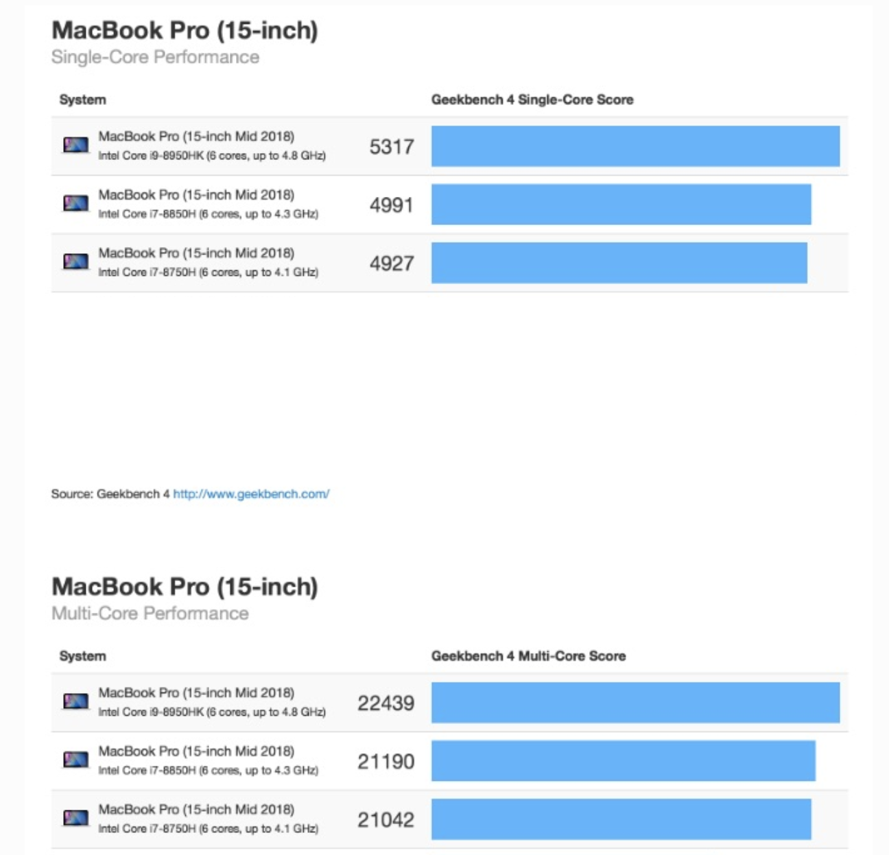

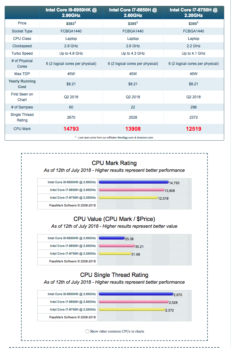

So Im looking at 3 processor options
(2.9Ghz) i9 8950hk
(2.6Ghz) i7 8850h
(2.2Ghz) i7 8750h
Im planning to configure it for 32GB RAM with the 560x GPU
I just dont know which processor.. by looking at the benchmarks I see the numbers but honestly.. how am I suppose to know if 200pts or 500 pts or 1000 pts are considerable differences.
Im inclined for the 2.6ghz or the 2.9ghz but I read the differences are minimal..and i9 will just heat up more.
Benchmarks from Macrumors
https://forums.macrumors.com/thread...t-yearly-performance-gain-since-2011.2127645/
and this other benchmarks
I do Xcode for mobile apps and recently work with 3d Augmented Reality. As well as TouchDesigner and WebGL 3d visuals., Madmapper, Resolume.
Any suggestion ?

I’d get the i9 for your line of work. This should be a no brainer.
Due to the potential for thermal throttling on the i9 (in which case, the additional on paper performance is lost), I think the i7-8850H is the real sweet spot here.
The i7 should be fine. As mentioned, the i9 is going to run HOT in that small case and will quickly lose its advantage.

The more I read the more I ditch the i9... seems like the money is not worth the i9, plus the heating problem.
Im definitely thinking getting the i7 8850H, but then again.. If you look at the charts... it is pretty much the same as the base model. Im perfectly fine paying for the 8850 but in real world... will I feel the difference with the base model ? You know.. compiling apps, opening programs, having multiple apps running at the same time, rendering in real time.
I just dont wanna be thinking later: "man.. I could have taken those extra bucks for more SSD or peripherals"
