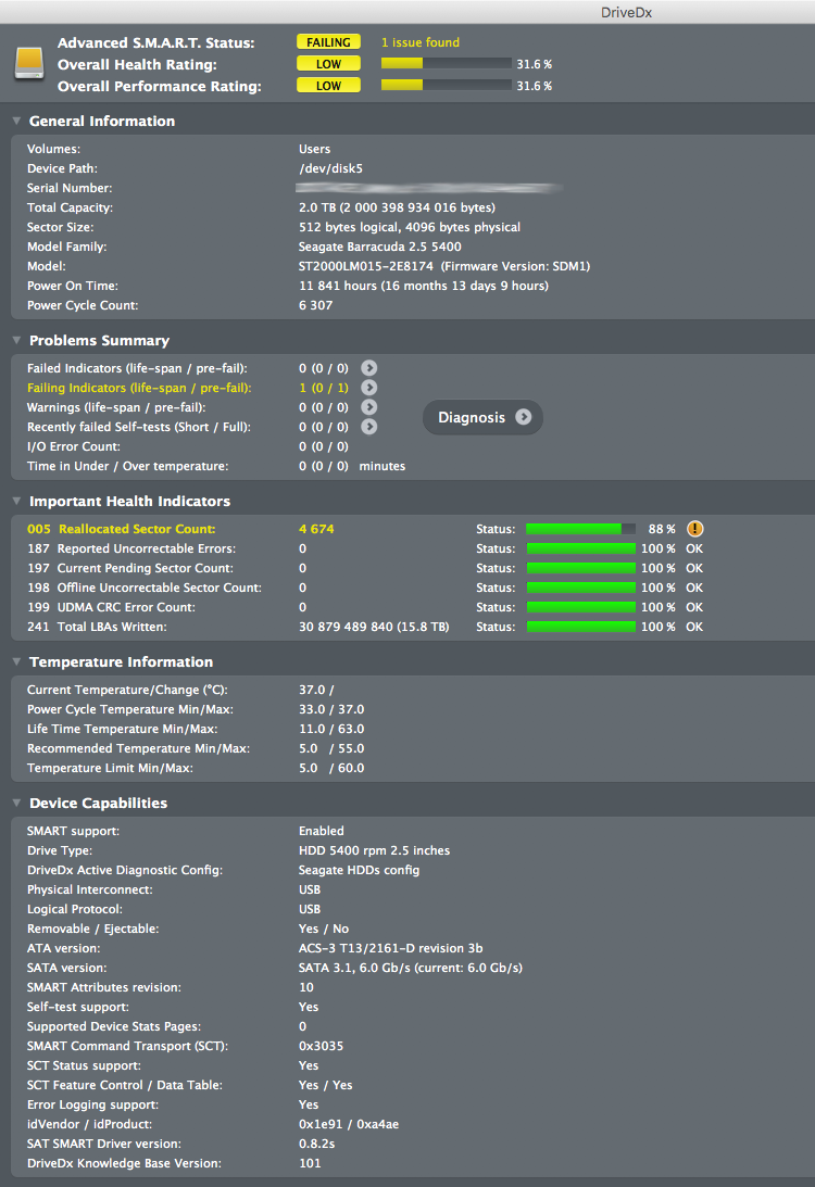

So it looks like the 2TB Seagate Barracuda harddrive inside our late-2012 Mac Mini finally gave in after around 5 years of use. Can someone confirm if this is the case (see screenshot below) or that it's likely that I can revive it after reformatting it again? I assume not.
Confirmed. When you start seeing reallocated sectors then it becomes a crap shoot as to how long the drive will last. If the bad sectors were only on one place on the drive, were few in number and weren't increasing, you could gamble on it if there was nothing important that hadn't been backed up. But with as many bad sectors as you have with this drive it's better to just replace it and not take the chance.

Thanks for confirming and explaining!
I took it out of the Mini and put it in a USB-3 drive-dock just to see if I could make an additional backup, but what happens is that it's very slow, and while I can copy some smaller files/folders over I'm having problems with larger folders, so I can't complete a full backup.
I didn't know about any Samsung EVO problems, but did a little searching after reading what you said and came across a posting entitled Samsung 870 EVO -beware, certain batches prone to failure!
I'm going to keep a close eye on this, even though it appears (according to the above thread) the problems mainly concern those manufactured around Jan/Feb 2021.
DriveDX looks to have been a good investment for figuring out all this!
