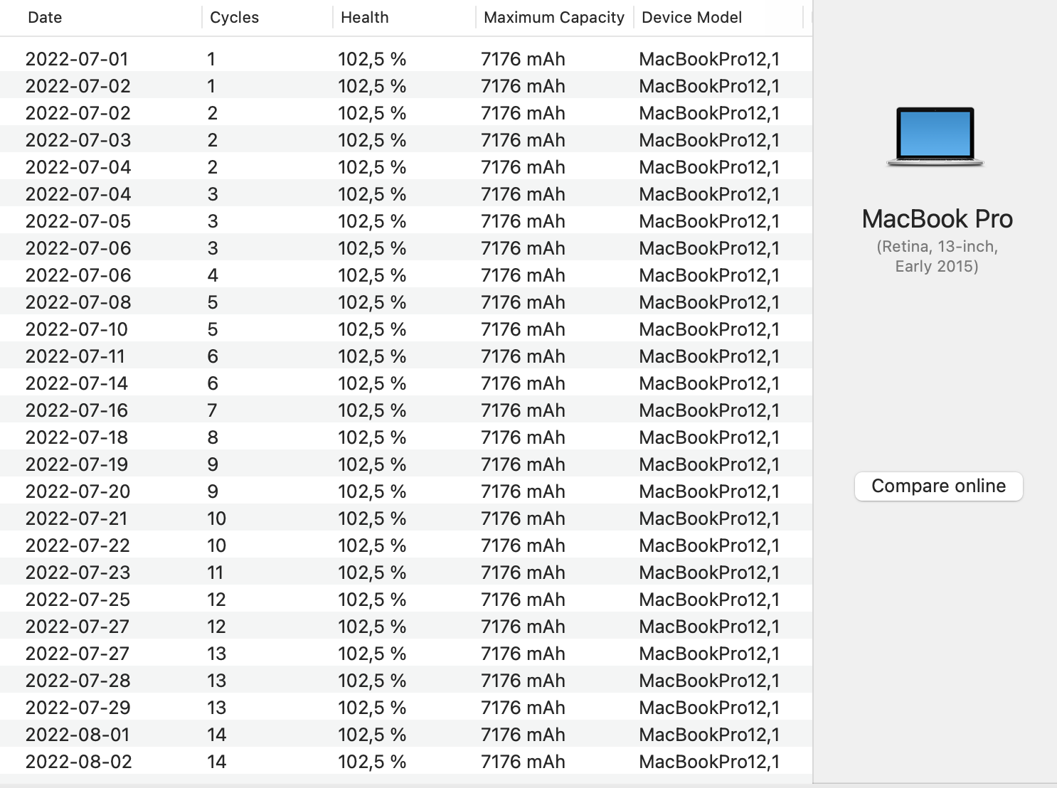

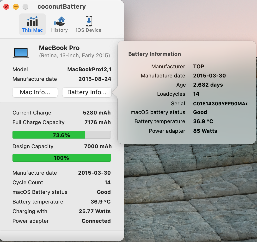

I would expect some fluctuations of the full charge capacity value with use, but it just stays exactly.the.same!
Since I first fired up the Macbook with the new battery the capacity stays at 7176 mAh.
I did several SMC resets so far, some full cycles, but the value does not change.
imo what's going on here is physically impossible, minor fluctuations in capacity are to be expected. what could possibly keep this value fixed?
the battery age is a false value. the manufacturer reuses the circuits of original batteries and exchanges the cells with new ones.
oh and the battery is running perfect, it delivers the 8-9 hours of light use.

I don't see what you're asking. You already know the battery is using a bms (likely not even the original TI one) providing fake info. The cells in your battery are probably b-grade at best. Estimated health only changes after checkpoints are hit (on the original ti algorithm), so your smc resets don't do anything.
So what exactly is your question. The fact that it's currently working doesn't contradict any of the above. You may have even gotten lucky and it'll last for more than 1 year. It's probably safe since I hope even the cheapo chinese bms implement basic ov/oc protections, but if you treasure your laptop like an heirloom I wouldn't risk it when there are chinese batteries that are at least more transparent about their supply chain.

The question was „what’s going on“, the info that the battery may report a fake value on purpose (and that this is possible) is new to me and may answer my question ;) I already guessed something like that but was unable to find one single report of similar symptoms so I assumed that it‘s not possible to alter the circuit of a battery in way that it reports a fixed value.

The BMS (battery management system) is what sits between the raw battery cells and the smc. It is the one that reports all data to the smc, handles balanced charging logic, has protections, etc. TI is texas instruments, they are a supplier of such BMS ICs. In the case of the 3rd party Chinese batteries they either reflash the firmware on the ICs, or just replace them entirely with something more amenable to reporting faked values. There's nothing inherently bad about using the non-original TI BMS, just that I'm skeptical they will spend the extra cents to implement all the same protections, configure the logic correctly, and so on. (Configuration meaning that even if you use exact same model TI BMS, you have to configure threshold parameters correctly).
>manufacturer assures that only high quality cells are used for his batteries.
Sure they all say that. Unless you verify their supply chain, you have no way of knowing. General principle when buying 3rd party li-ion batteries is to assume that nothing should be taken at its word.
I doubt you're going to get any explanation from manufacturer.
