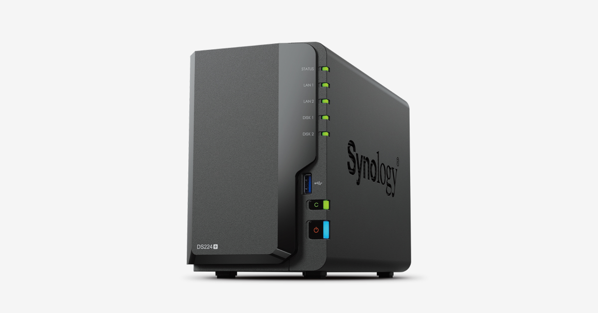

Never owned a NAS before, but I'd like to fix that and I could use a little guidance. My intended uses:
  • Plex Media Server
  • Data backup/syncing (to replace Dropbox)
  • Photo storage/backup/syncing (with good photo management, searching, browsing, etc)
  • Remote File Access (from laptop or mobile device)
  • Shared file access (from various computers of everyone in my family)
Not interested in building my own rig and I'd much rather buy something pre-built and ready to go out of the box, so I'm looking at something from Synology right now. The number of options are overwhelming, though.
I will be the only user, so it's unlikely that I'd be watching Plex, backing up data, and browsing photos simultaneously.
Having never used a NAS I don't know yet if I'll use it as a standalone device connected directly to an ethernet cable, or if I'll connect it to my Mac Studio desktop computer, which I typically leave on and running all the time.
My Spectrum internet service is 1 Gbps down, 40Mbps up. I currently use an Eero Pro 6e, which supports a maximum wired speed of 2.5 Gbps.
Any suggestions for a RAID 0 option from Synology? What about a RAID 5 option?
Not sure if there is any other relevant information that would be helpful, so let's start there. Any suggestions would be sincerely appreciated!

Another vote for Synology, for the features you mentioned.
How much data do you want to plan for? Two medium to large drives mirrored might be the lowest cost, most reliable hardware option, just as in Bigwaff's example.
If you go Synology, don't be tempted by their lowest-end offerings. The are cheap because they are underpowered, and performance is reflected by that. I would probably go with at least the DS224+.
Synology. I use quite a few different models at work and at home. The good thing is that you can start small and then expand it.

Synology is very good for your list of uses. Buy a 4-bay "plus series" and be done with it. Then buy four drives. But please note the controversy around Synology. Synology now wants you to buy Synology-branded disk drives and RAM, as they say it is more reliable. But some hobby users are cheap and want to use "whatever is lowest cost". It is very much like Apple selling soldered-in RAM while some users would prefer "whatever is lowest cost" RAM.

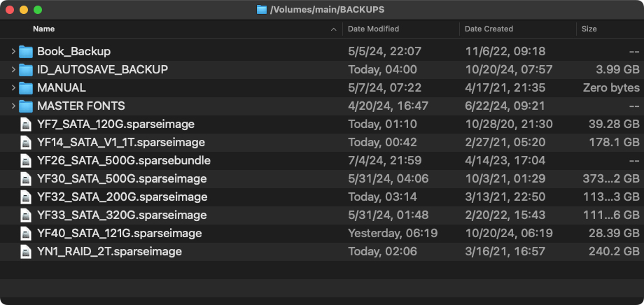

Perhaps I was unclear. The NAS I use for backups is for ALL my Macs and PCs. Not just one.
The data on my Macs and PCs are still on their individual drives. It's just backed up to my NAS. I use Carbon Copy Cloner for backups.
