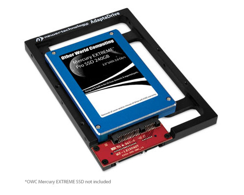

Will the Newertech Adaptadrive (3.5" to 2.5" SSD adapter) fit the drive-sleds in a mid-2010 cMP (Mac Pro 5,1)?
(the manufacturer's page doesn't specifically say)

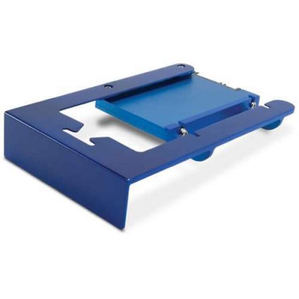

Are they reliable? I read in some other thread that these come with electronics making it less reliable than say the 2.5" drive sled from OWC (photo below). I even read somewhere a claim that the Adaptadrive slows down an SSD compared to having it directly connected, but find either hard to believe. Judging from the photo it looks to have a circuit board which only holds the SSD connectors on one side and the connectors that go into the cMP backplane on the other side. Please correct me if I'm wrong!
I actually planned on getting a couple of those OWC 2.5" sleds, but not being available locally and very expensive to order from abroad I thought the Adaptadrive looked like a nice option.
You're right !
There's no circuitry on the pcb , just copper paths.
So, the claim that it slows down the connection is bogus ; )
Back in the day I've used these in a Mac Pro 3,1 because the nice blue OWC ones dont fit in the MP3,1.
Btw there are Newertech adaptadrives for e.g. a MacBook Pro optical bay that do have a circuitry on the pcb.
I've used them too and there was no slowdown either in that case.

Yes, the model you linked also fits in a MP 4,1/5,1 drive sled.

I also bought one of the blue OWC adaptors from Amazon at £13.47 to put an 860 EVO SSD in and an OWC 3.5" Drive Sled to take the larger HDD that has a different hole mounting position than the standard older/smaller capacity drives/sleds for the Mac Pro and all seem to do the job.

KeesMacPro is absolutely right about there being no electronics on it, and as far as I can tell the only difference between it and the blue OWC Mount Pro adapter is that you only need to mount the SSD to the sled while with the Adaptadrive you first mount the SSD to the Adaptadrive, then mount the Adaptadrive to the sled. I believe they're just as reliable and work in the same way.
