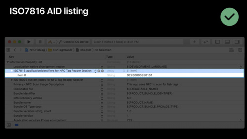

Seems to be a lot of confusion on this topic. NFC is not to be confused with mobile payments or Apple Pay, which is what the EU antitrust charge is about.
Yes, Apple Pay uses NFC, and that part of it is locked down. However, apps are free to read and write to certain kinds of NFC tags. It has been that way since 2019 / iOS 13.
OP, what kind of NFC tag are you using? Does it support one of the NFC tag protocols listed in the second link above? Or are you able to scan/read the NFC tag in an AirTag if you have one handy? (The NFC tag in an AirTag contains a URL.) That would at least tell you if your reader is working with a known supported tag.
