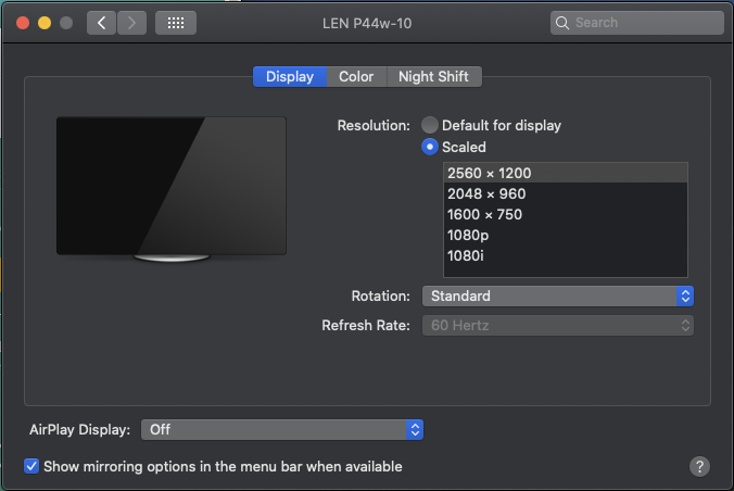

Strange thing is that some guy on reddit also had a problem with P44w-10 - the resolution ... but in the picture he posted I can see that he had an option for Night Shift ... but he was running Catalina at the time.
