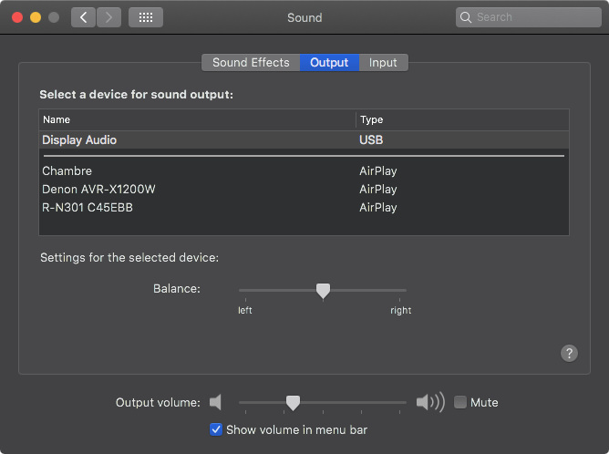

Hello,
Today I did setup my new desk / found the time to do it - as I moved back to France after few years abroad.
I did purchase a while ago (more than 10 years) a 2.1 Harman Kardon speakers and decided to connect it to my MacPro for the first time.

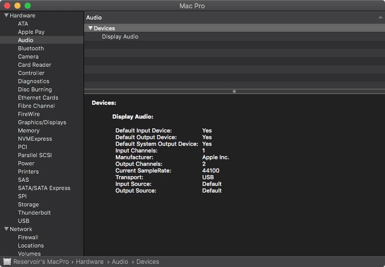

I never needed until now to use the external output audio 3.5 on my MacPro using Catalina.
I did install Catalina using the Catalina patcher and found out that I had no audio interface excluding the one coming form my 24" Cinema Display LED.
I did reset the PRAM but the system keeps ignoring my MP audio interface.
Is it a known issue with the dosdude1 patch? is there a solution?

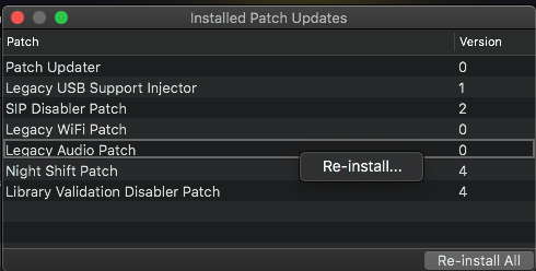

Hi Macschrauber,
Thanks for your advice. In fact, I did install the post install patches back in those days.
I just re-installed the audio patches today and voila.
