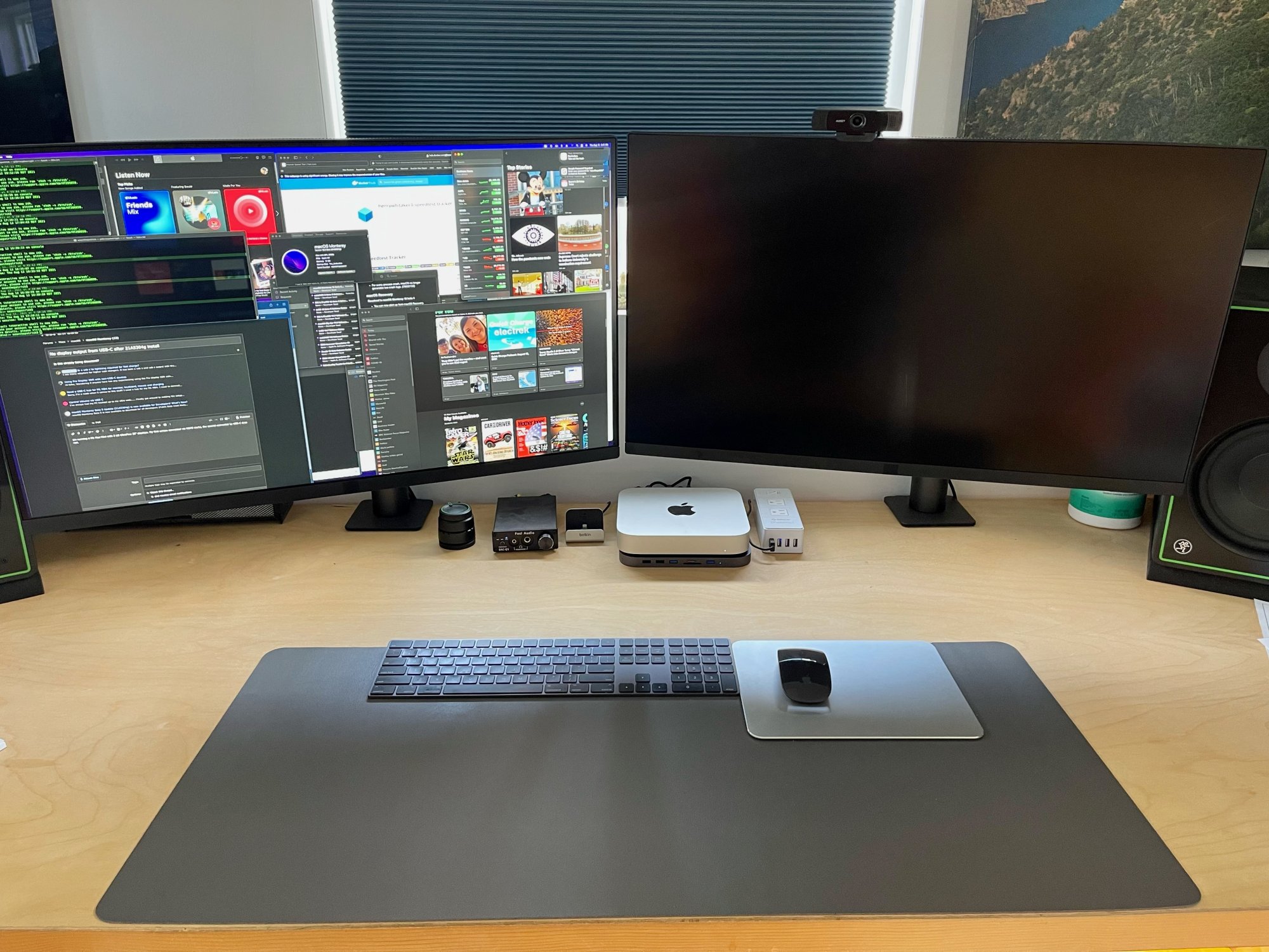

Im running a M1 Mac Mini with 2 LG UltraFine 32" displays. My first screen connected via HDMI works, the second connected by USB-C does not. Tested the display on another Mac and it works.
