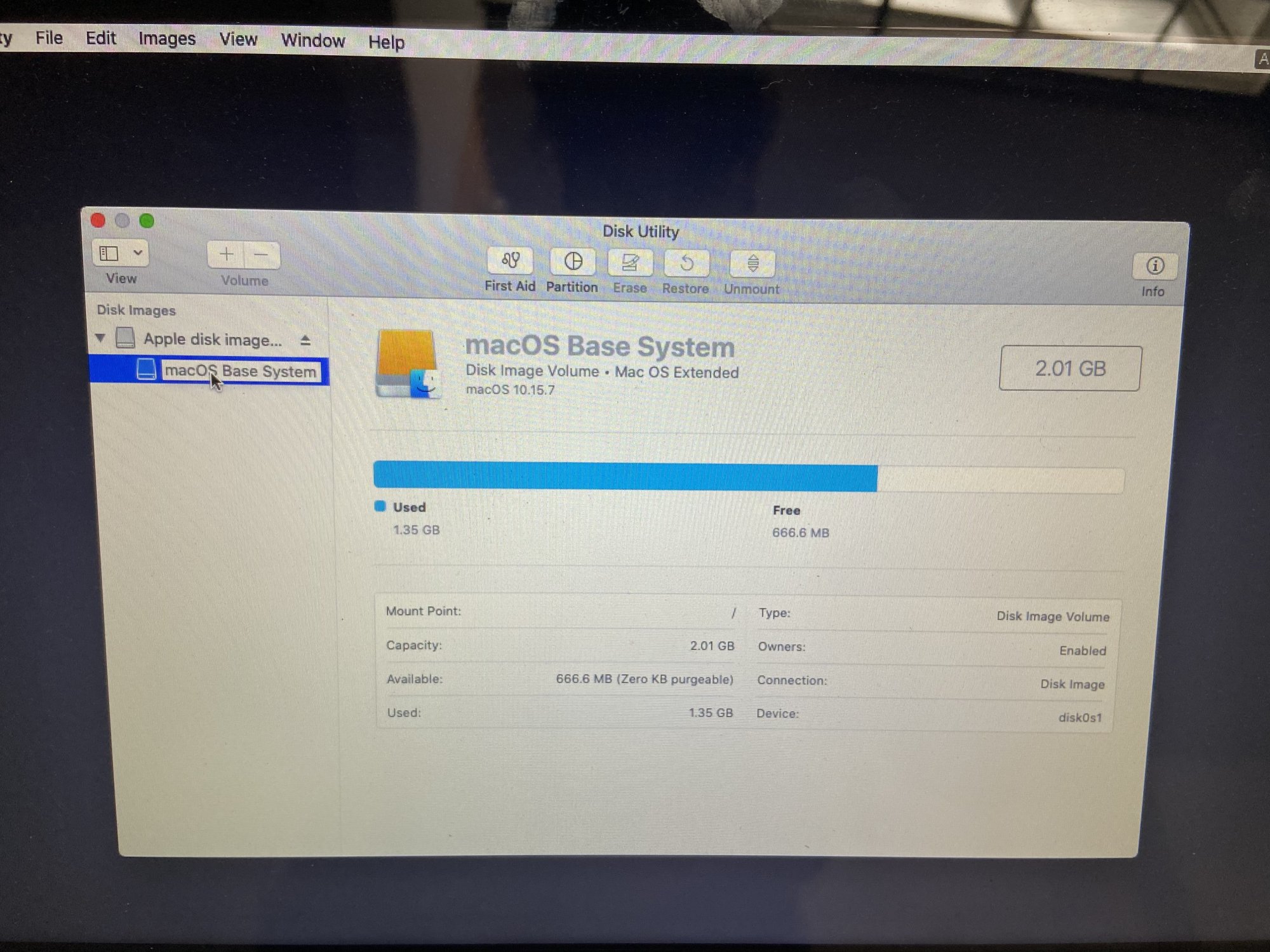

bit of a problem, closed my MBP (as in the lid) and travelled home from work, went to open it this morning and it rebooted and then showed me the dreaded question mark on start up, so I have restarted whilst holding option, command and R to do an internet recovery, however when I then go into disk utility, after selecting view all devices, I’m faced with the image in the screenshot, I can’t erase either disk?
therefore can’t reinstall the OS.
any ideas at all here? I’m suspecting either faulty HD, or cable, but I’m in below my neck when it comes to this.
any help at all would be gratefully received.
machine is I believe a 2012 MPB.

Ok, I see your point, and I agree, a replacement is the way forward, but surely if the HD was totally goosed it wouldn’t show at all in disk utility?
That's the RAM drive created for the disk image for Internet Recovery showing in those pictures. If you restart. It disappears.
Also when HDD fail. They can still show up in Disk Utility. Even though it isn't the case right now. It all depends on what part of the drive failed.
