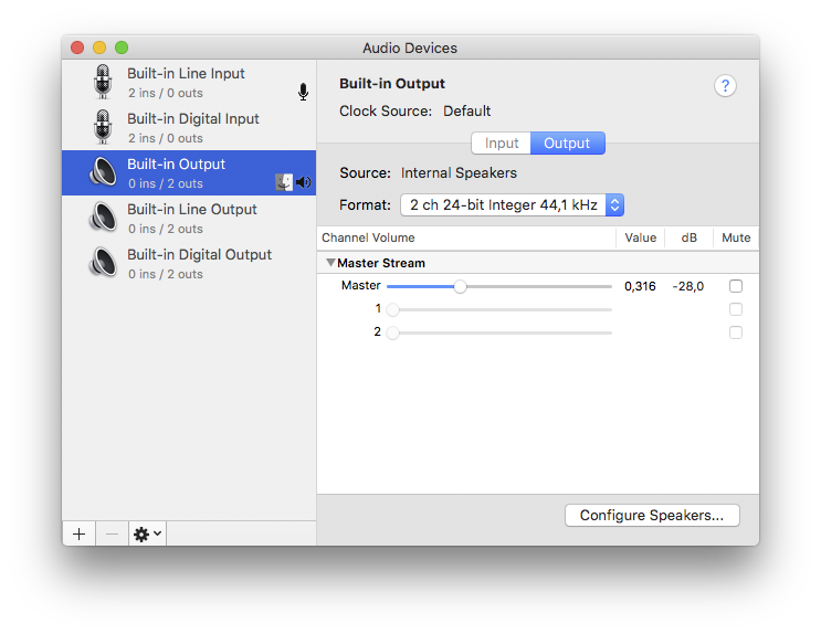

For some reason I'm not hearing the audio coming in from the rear line-in jack of my cMP (mid-2010/MacOS 10.13.6).
I've checked the Sound preferences and set INPUT to "Line in" (the meter definitely shows audio coming in) and OUTPUT to "Internal speakers".

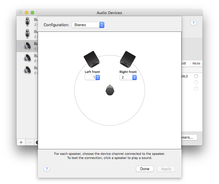

The funny thing is that I do hear the alert sounds and whatever comes from the web browser. And using the Audio MIDI setup app's "Configure speakers" I can again confirm that the internal speaker is working, but not what comes in from the line-input.
