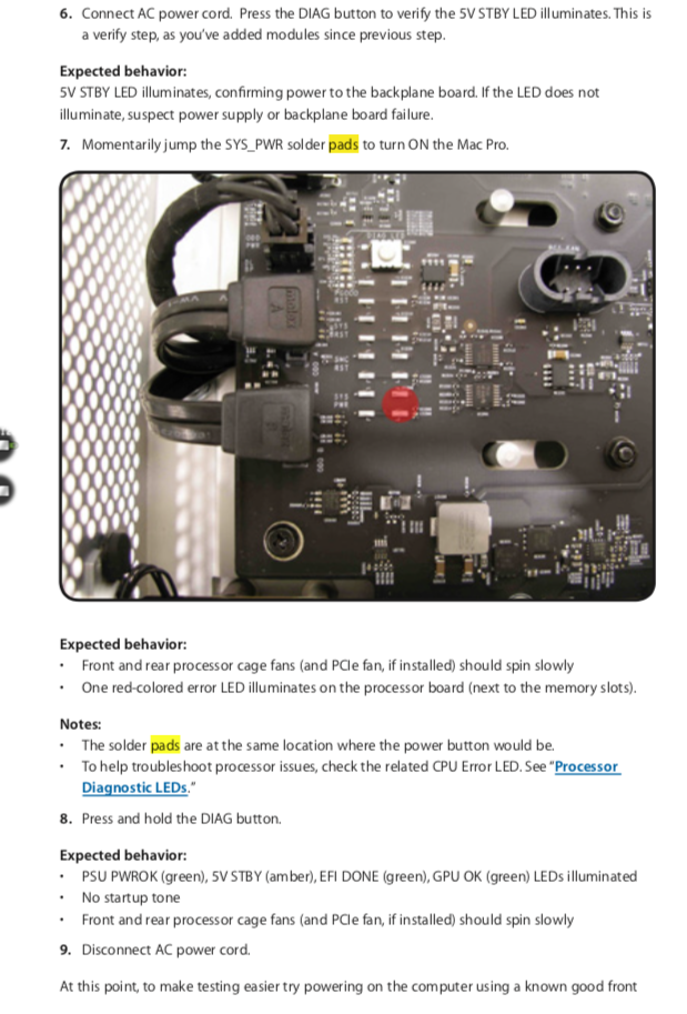

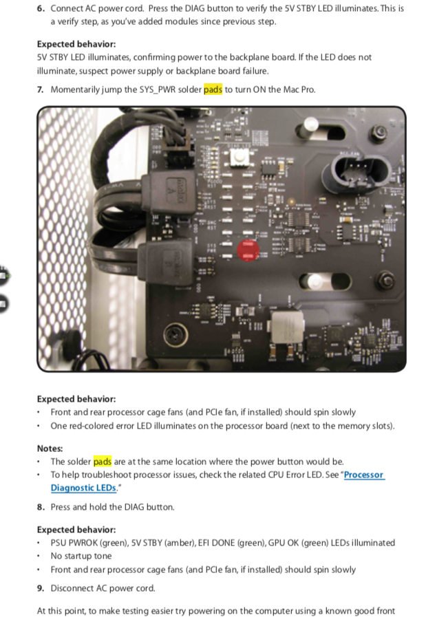

also consider the technician source for shorting the power on pads near the diagnostic switch.

Double check the cabling between the Backplane and the Front Panel.
It is just a workaround about a non working power switch to diagnose.
Reactions: michaelbirdart
here is the jumpstart procedure for a regular startup of the box with connected rtc battery:
