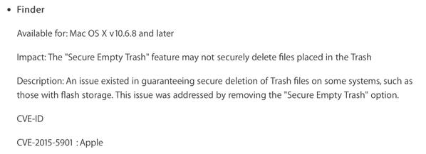

I just downloaded El Capitan and noticed my trash can no longer says empty securely. I've looked in the Finder menu where it used to be but it no longer offers the option. Any ideas or suggestions? Thanks.
I suggest you watch something like this video to understand why the option was pointless on SSDs (especially towards the end of the video where this is covered):
Essentially, the SSD microcontroller manages the data on the SSD and does "wear levelling", meaning writing to a particular block with an specific ID might be mapped to a different physical block (because there is a limit to the numbers of writes possible to each cell of memory, the SSD manages this to maximise the life of the disk). The old approach of writing over with null data means that the SSD might not actually write to where the data was, but a different area of the physical flash.
As per below, secure empty trash doesn't really work with SSD due to the way they operate (wear levelling).
Apple removed this option for SSDs.
If you want to be able to delete stuff and care about security, use FileVault to encrypt your stuff. The whole disk is inaccessible to others in that instance.

This isn't a problem that is fixable with the filesystem really. The SSDs contain their own logic which re-maps blocks to do wear levelling. The OS can't see what is going on with that and can not control it.
Rather than leave an option that does not work with SSD and may be misleading to users, they removed it.
As I stated above, if you care about this, run FileVault.
