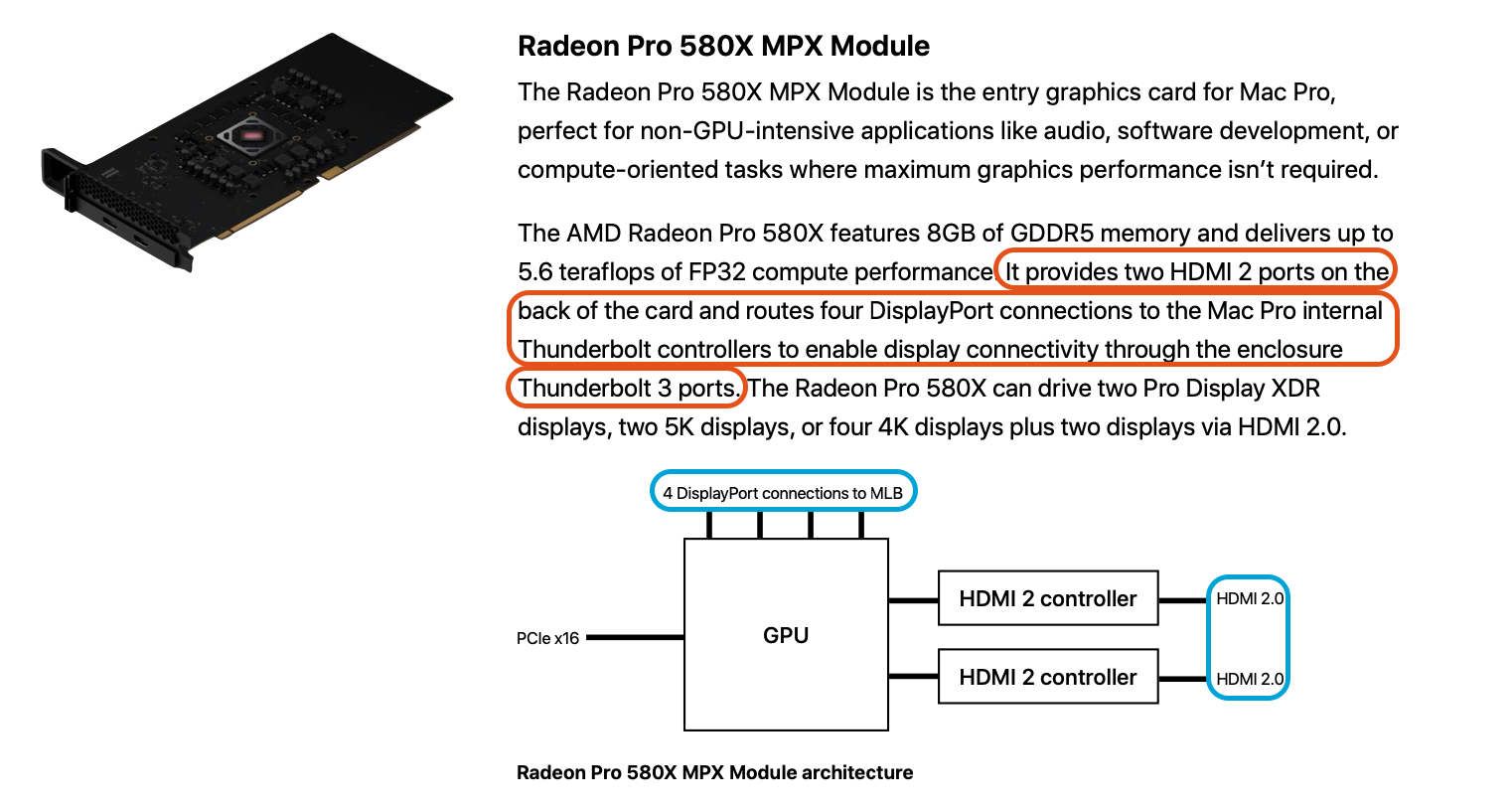

The 580X seems to have only 2 HDMI Ports, how do you connect the Monitors and what does the System Profiler show ?

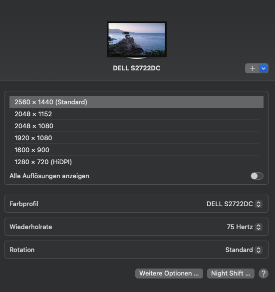

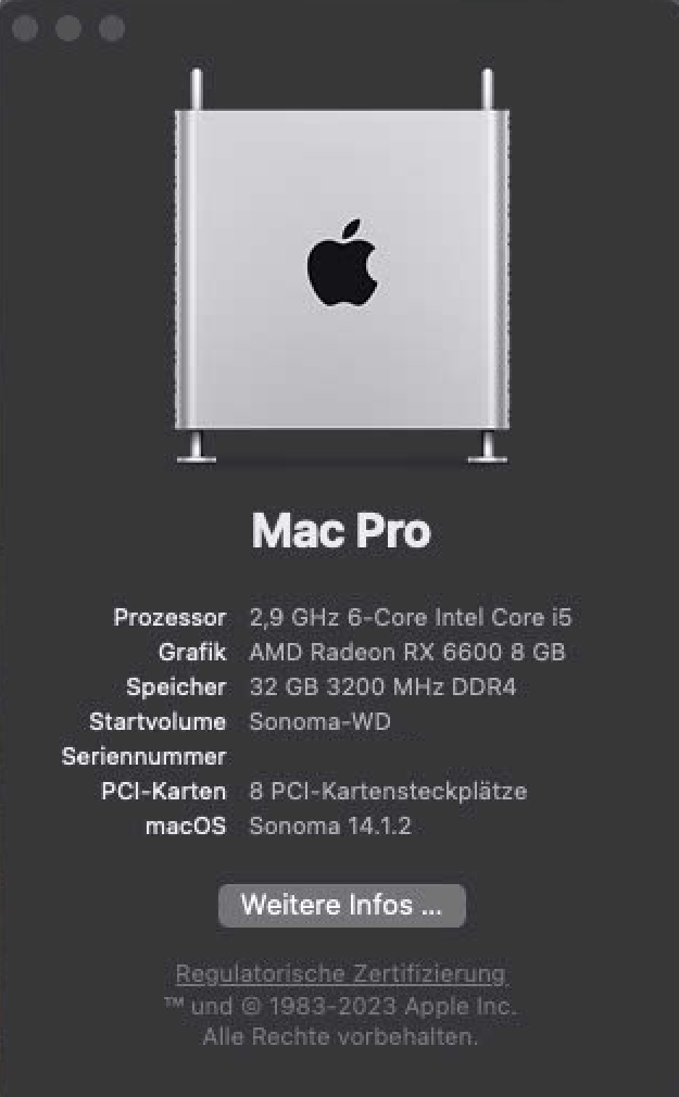

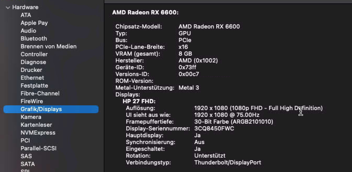

On my Hacky it shows also in Remote:
On my German System it shows up like this:
Then you can see if your Card shows up and how.
If the Monitor shows up under Displays you can try to set fixed refresh rate and change resolution....
Post your views.....
I can configure my Displays also while Connecting Remote...

system_profiler SPDisplayDataType says the 7,1 has a 580X and two displays. Yes, it only has two HDMI ports and that is the way it came from apple when I ordered it in Dec 2021.
So your System is reporting Displays and Grafik Card, you should then as i described be alle to go Remote to Display and change the Refresh Rate to a fixer value......
