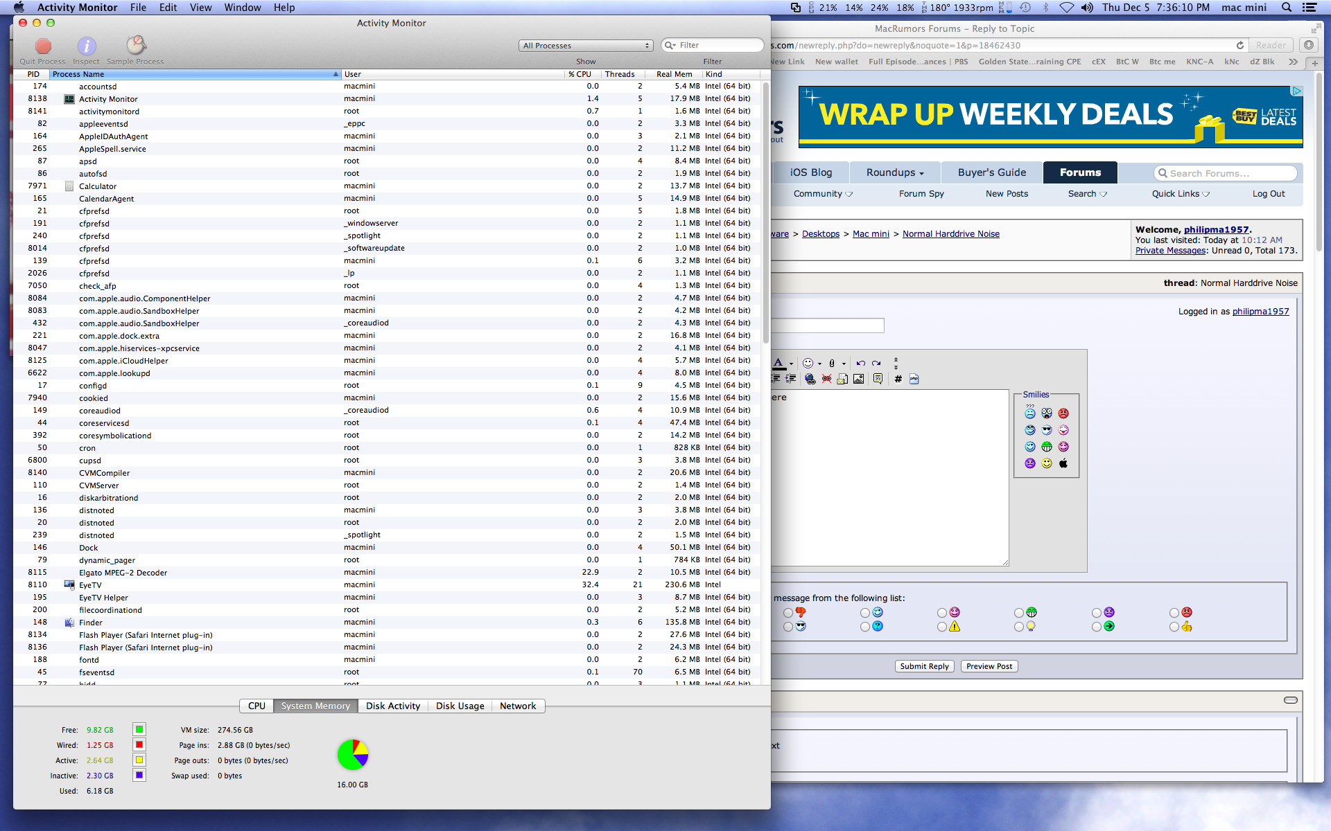

look at your page outs and swap right here.
0 page out and o swaps means I never went to the disk due to lack of memory.
any one with billions of them will have a lot of hdd noise. notice I have 16gb ram.
