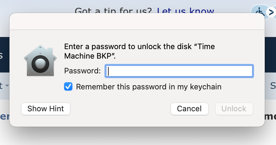

I just tried plugging in my TM backup external drive and it did not appear on the desktop.
I got this displayed
I put in the password and after a few seconds it appeared on my desktop.
