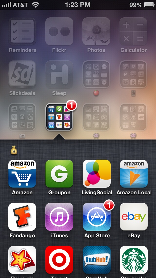

So here's a screen shot of the issue. The app folder doesn't shift down to show the last row of apps in the folder. As you can see the names are also cut off. Again, is this a jacked up setting I haven't done right or just an issue with the app? Because using these really nice layouts are useless if I can't use my folders.
Same issue here.
