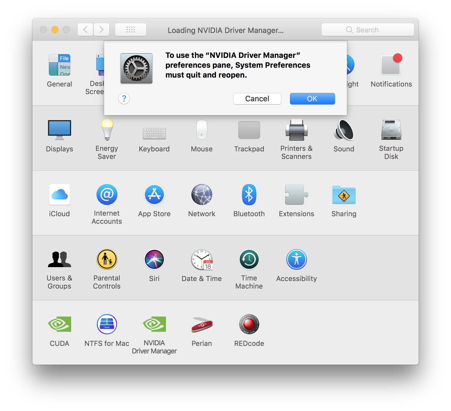

Since June 01st the drivers for my Titan-X (Maxwell) PCI-e GPU were not working anymore. When I tried to reinstall using WebDriver-387.10.10.10.40.140 it appears that the certificate is not valid anymore.
The preference pane panels for both CUDA and NVIDIA Driver Manager were not working:

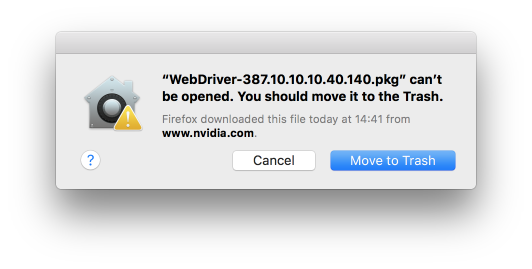

Initially it would give the error message:

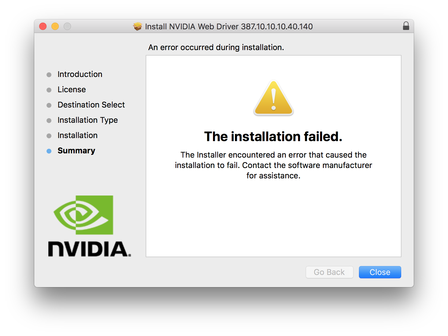

The installer starts to run, however, during the last step it fails and this the error message I am getting:

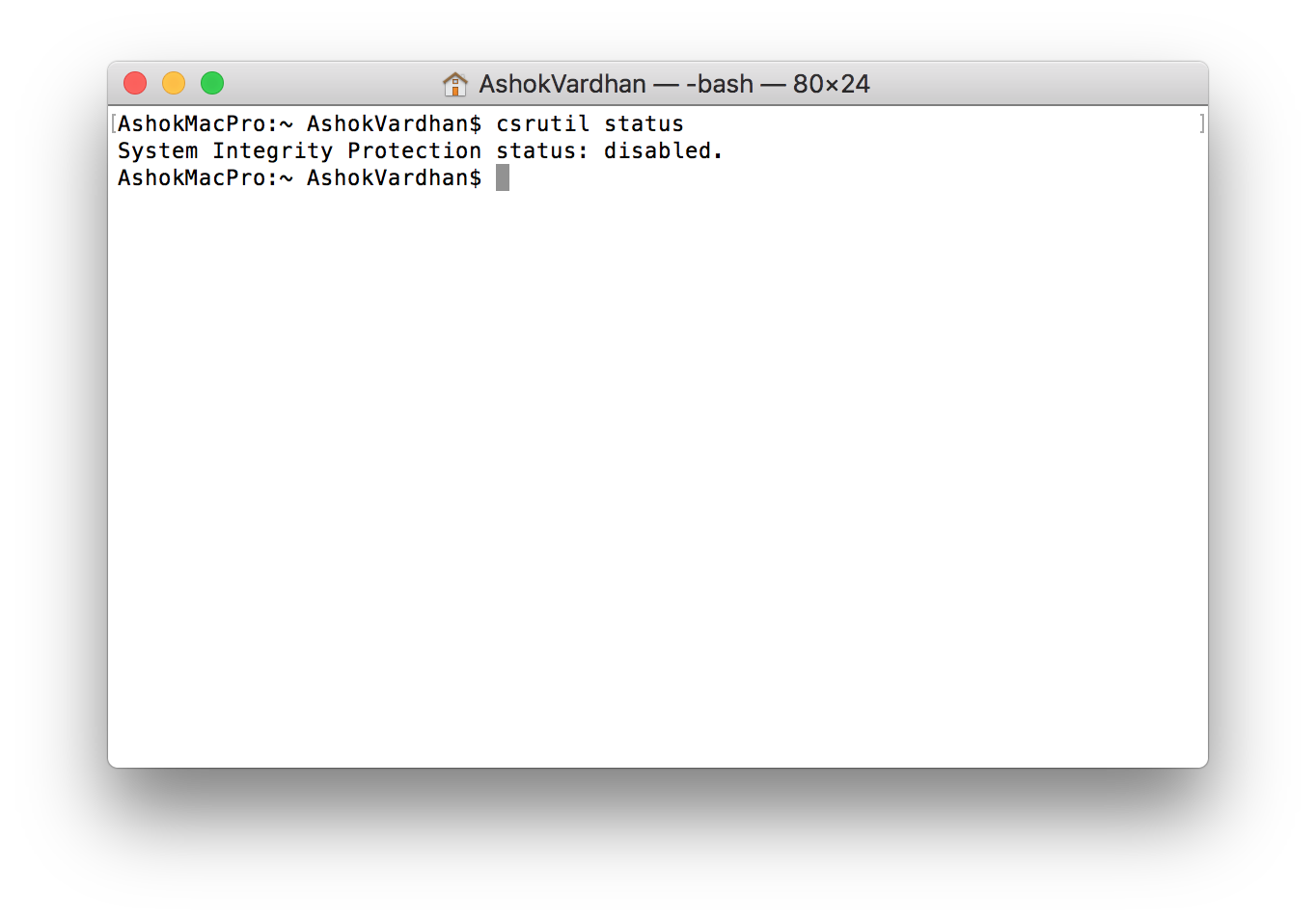

SIP was disabled in recovery mode using Command-R during bootup by using this command in terminal:
csrutil disable

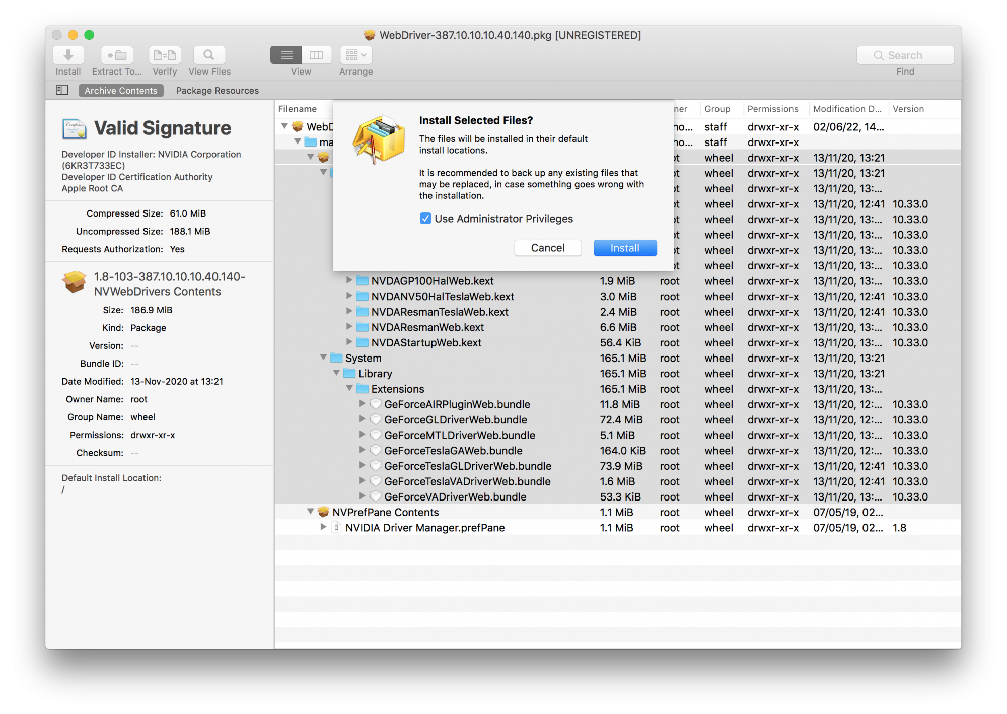

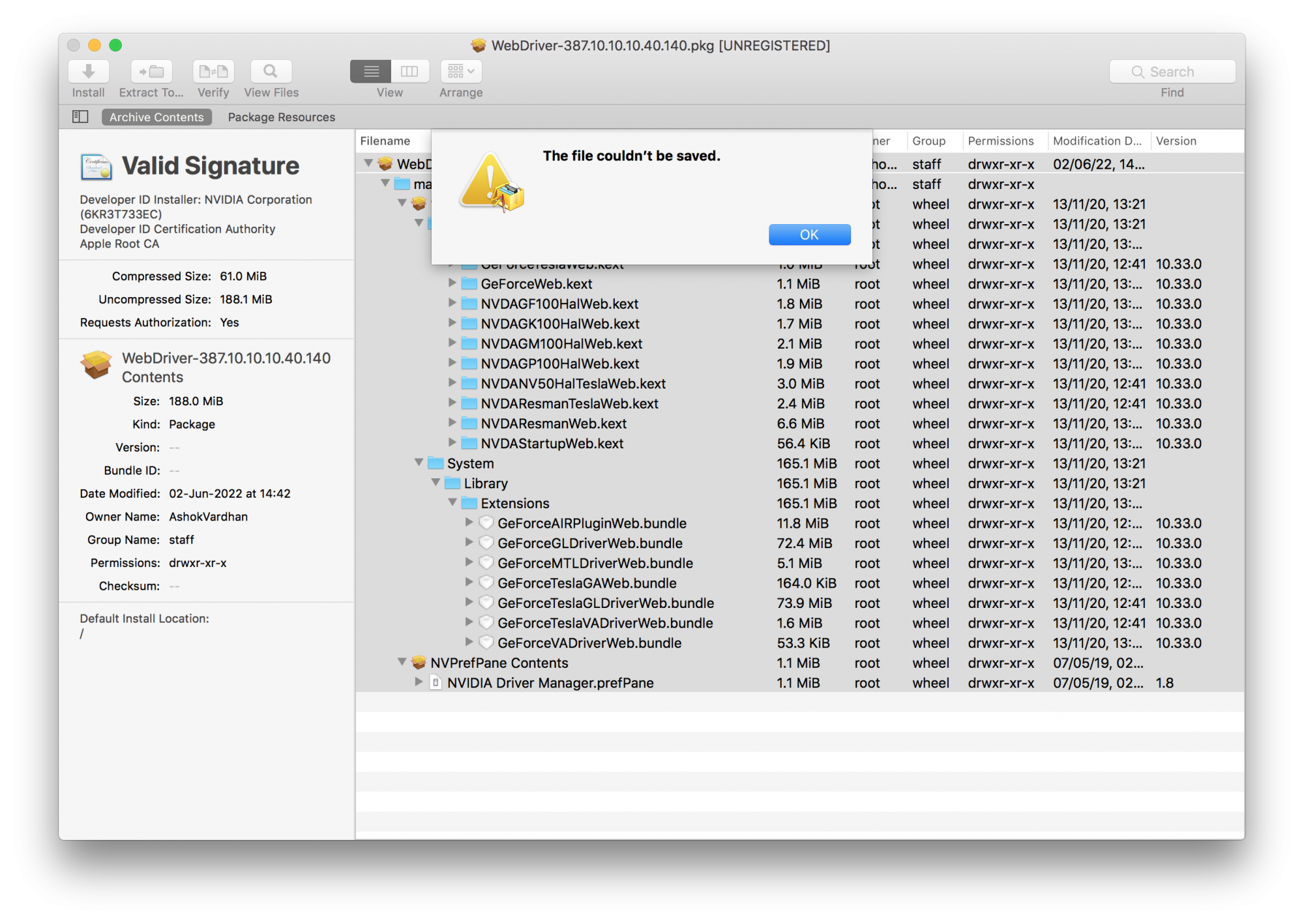

I took all this one step further. I used Pacifist, loaded the installer into it, identified all the individual kexts and preference pane entries the installer makes.
I used the codesign command: (sudo codesign --force --deep --sign - /"Path to Kext and PreferencePane entry/) to replace the individual signatures of every kext and file installed in the various folders:
~\Library\Extensions
~\Library\PreferencePanes
~\System\Library\Extensions
Still made no difference. Something more regarding the kext signatures is happening that is beyond my current scope of understanding.
I have been reading the issues other people were having in regards to being signed out of iCloud/Apple ID and unable to use it because of related certificate issues. Wonder if both of them are related?
There seems to be solutions for the iCloud/Apple ID issue, just not sure if it will help fix this one as well.
Anyone with more deeper insight into system architecture please do comment.

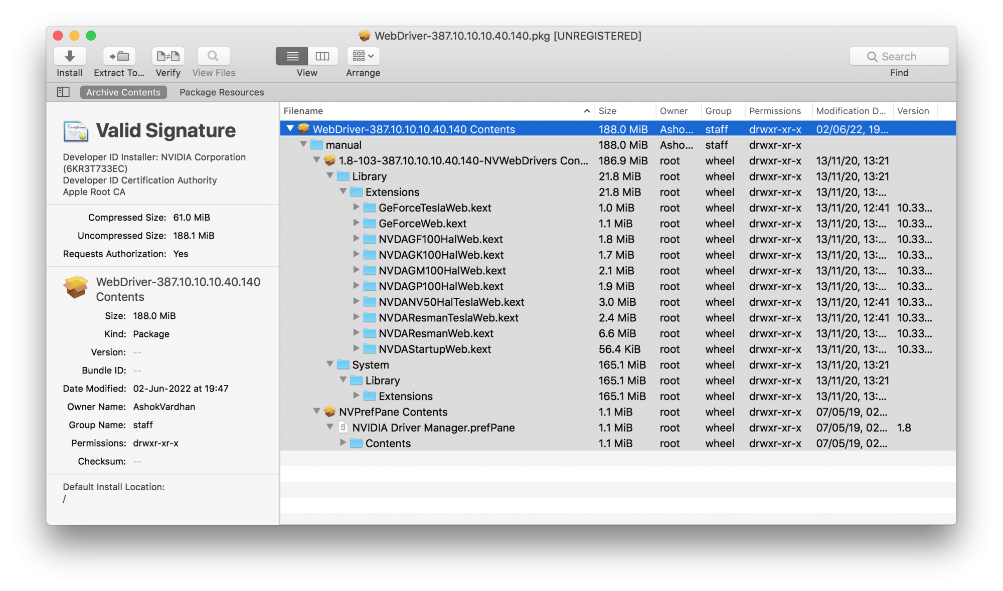

The strange thing is that Pacifist shows the installer as having a valid certificate.
Individually injecting/installing them through Pacifist seems to work, however, the kexts are not loading properly once injected/installed.
The "install" option (i.e. Pacifist automated install option on top-left corner) also does not work:
So I don't know where the issue lies?

Tried this. Installer runs fine, however, in the last stage I get the same error I got earlier when using the codesign terminal commands:

I had a feeling someone would indicate this to me.
In my initial post I had forgotten to indicate it (now I have updated it). I thought disabling SIP should do it too.
The terminal "codesign" method, Pacifist method and your "pkgutil" method were all performed when SIP was disabled:

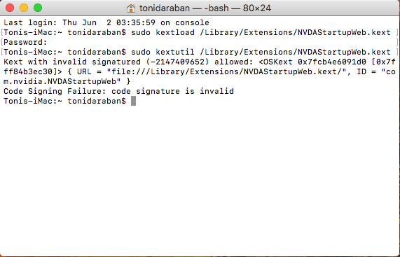

I also started a thread to this topic. Experiencing all the same probs. Tried a different "solution" by unsigning each and everything in the more os independent 387.10.10.15.15.108 package and installing manually. Also blocked one attempt of NV calling home with little snitch.
All with no success. How can one company suck so big? We all have payed hundreds of bucks for our cards and now they are all "expired" if this can not be fixed.
Reactions: Ashok.Vardhan
