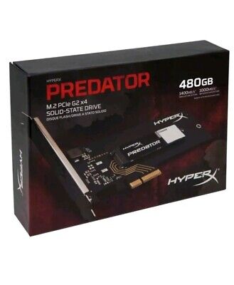

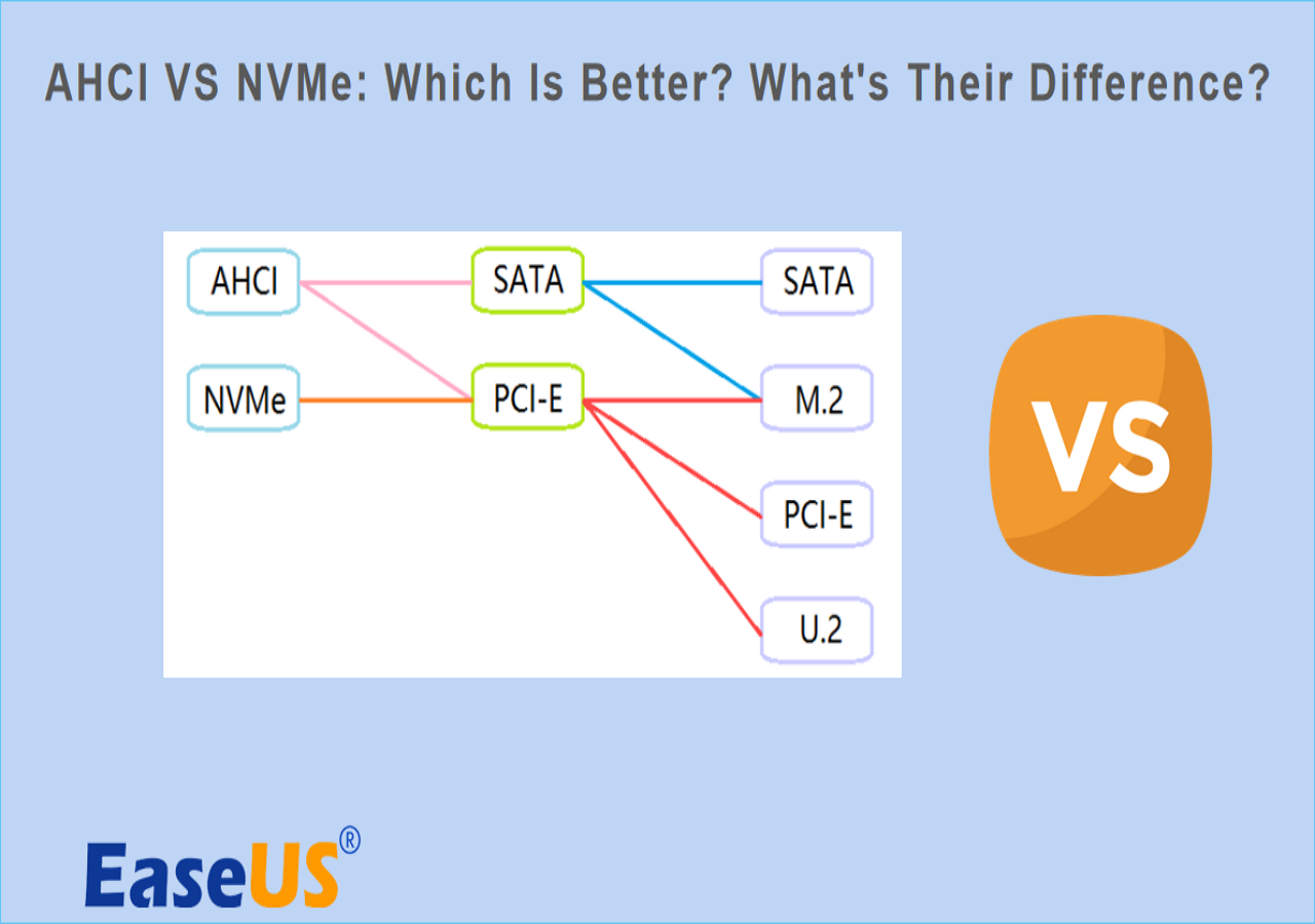

During my upgrades, one law always seems to remain the same and that is this one. Try always to upgrade with parts that are not too distant from the original time frame of the "to-be-upgraded-device". If you have decades between, chances are it will not work or cause issues. This is correct also with older cars, old-timers and other collector items. In your case, it could be very well the case that you will run into problems by using NVME blades. To be honest, I was absolutely surprised when Apple officially allowed NVME blades on the 5.1 just before 2019.
Just in case you want to avoid the injection of the NVME driver thing in OCLP as you mentioned above, you could go for the older standard and most likely have a better compatibility and avoid driver issues down the line.
Here are the basics just in case you want to go this route:
There are a small number of blades that are still for sale with PCIe adapter in Germany it seems. Just in case you can get one of these new such as this one at your location, it would be worth considering. I still have this blade in operation after 6 years. It is still great and I did go with the largest option at that time (960GB).
