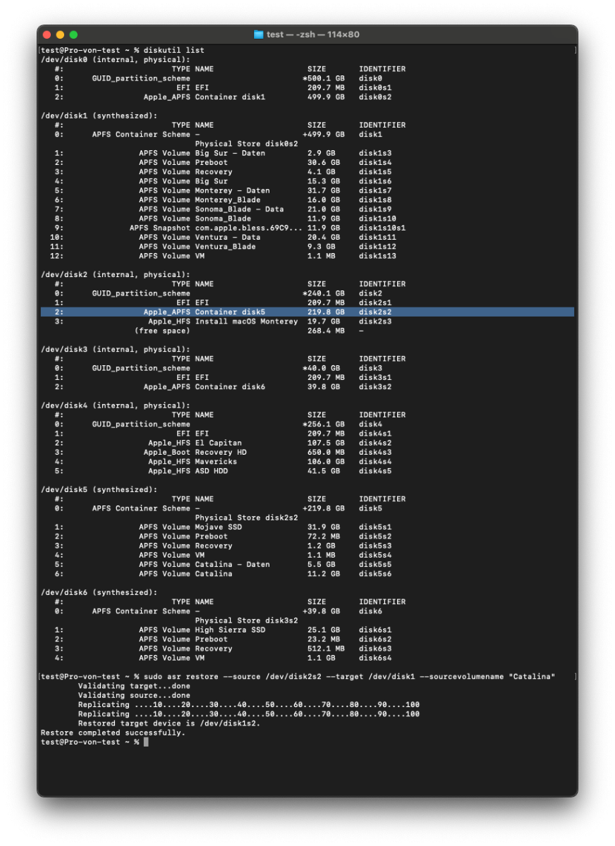

Since I just did this with my test disk, I'd like to quickly summarize it as a reference:
The test disk contained Big Sur, Monterey, Ventura, and Sonoma.
1.) Boot createinstallmedia stick/partition (USB installer).
2.) If necessary: Open Disk Utility and format the target volume in GUID format, create a container.
3.) In Terminal read out the source and target containers.
diskutil list
4.) Run asr like this example, insert x, y and sourcevolumename accordingly.
asr restore --source /dev/diskxs2 -- target /dev/disky --sourcevolumename "Monterey"
x=source container
y=target container
sourcevolumename=The name of the system, the data volume will be copied with it, in the example Monterey and Monterey - Data.
The next system can be copied in the same way, it will be added.
While booting, a tool corrected the UUID first and restarted. The OpenCoreLegacyPatcher patches also had to be renewed.
The whole process took a few minutes from blade to blade with moderately filled data volumes. Much faster than reinstalling all systems.
This had worked for me in the running system, if the system to be copied is not the running OS. Booting the installer was safer for me anyway. I have it on a partition, so it's quick.
