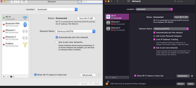

Any 5,1 / OCLP 1.2.1 running Monterey with Pro tool 2023.9
What's happening is I just did clean install three times of this combo. Installed Pro Tools and everything runs smooth (EXCEPT) I have to force quit Pro Tools and I'm also having Avid looking into to it.
I'm will not be surprised the folks on this platform will probably figure it out before Avid does.
What's interesting is Martin's package it doesn't have that problem. Is there something perhaps I can migrate from his package and inject into OCLP?
I should be using Martin's package anyway, but I just thought maybe there's a way before I abandoned OCLP.
Well I thought I try one more time.
it appears that I am missing the Firewire Icons in my network tab and that's probably why I'm having a problem quiting Pro Tools. Anybody have any suggestions on how to insert the firewire icon in the network tab?
Thank you.
