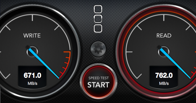

If you wanted to really speed things up, you could get two external drives and set them up as a Software RAID0. It is really easy and it can speed things up a lot.
I set one up a few minutes ago using a good SSD over Thunderbolt and a very cheap SSD over USB 3, and here are the results on my iMac:
If you had this set up or just one external boot drive, you could use your internal HDD as a back up using something like CCC or TM.
