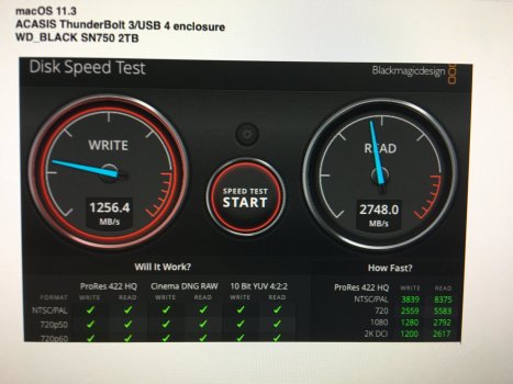

Using the ACASIS Thunderbolt3/USB4 nvme enclosure, my Write Speed is okay half of my Read speed with the 2TB WD Black SN750 SSD. As you can see from the attached photo, I am getting about 1250mbps Write compared to 2750mbps Read. Now, I have read that the 1TB Black SN750 SSD is able to get matching Write speeds, so the ACASIS enclosure should be capable, but can anyone share news of better write times for an alternate 2TB nvme SSD? I’d love to return my Black and grab something better. Thanks for your time.

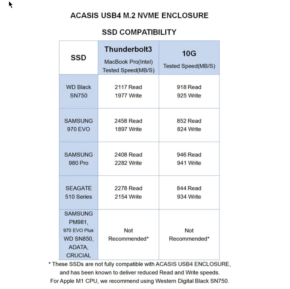

Following image comes straight from the "ACASIS Official Store" at Ali Express. They also have an "ACASIS Factory Store" at Ali Express. (For obvious reasons I'm not posting direct links.)
Looks like the 2TB Samsung 980 Pro and 2TB Seagate FireCuda 510 are NOT your best bet. But the WD SN750 you already have.See last line under the table. Why not contact them on Ali Express?
