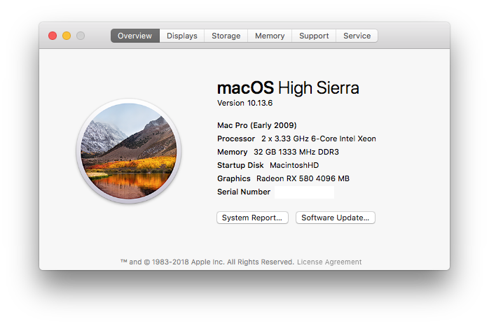

Tried a search of this and not finding the solution (maybe overlooked?)...I am new to OpenCore and saw a YT video of how easy 0.6.6 is and thought "now we're talking!". Sooooo, I have a 4,1/5.1 MacPro with an RX580 4GB
Anyways...created a USB thumb-drive of Monterey installer...did the Build and Install OpenCore step; first to internal SSD (system drive) and then tried to the USB thumb-drive after results of reboot on internal SSD...reboots...holding down OPTION key...hangs on black screen for a loooong time and nothing appears. Eventually hard rebooting and returning to High Sierra.
Anything I'm missing on how to do this? Am I suppose to have a 3rd drive to install it to...?
Thanks in advance!

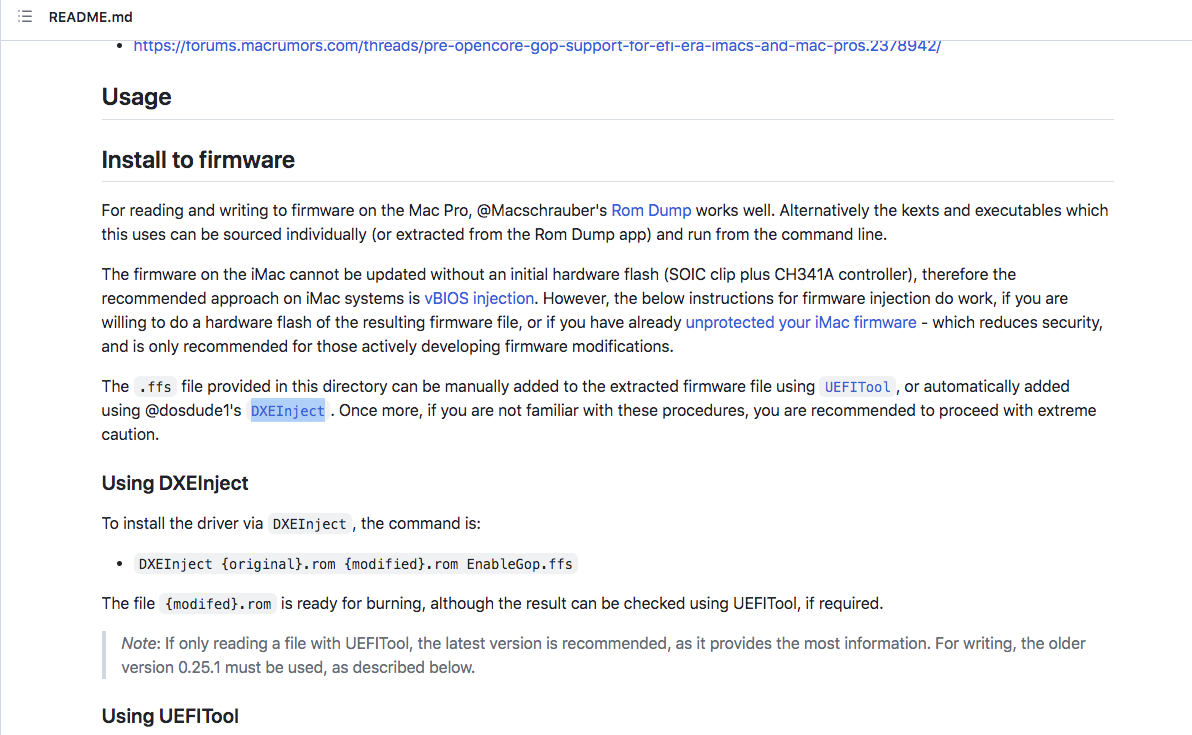

Ok, so I've used the Rom Dump app and then I tried using the UEFITool, but dialog window states can't work with macOS version (High Sierra currently)...should I be using an older version or...?
Feeling a bit inadequate atm 🧐
Maybe I'm missing the obvious step-by-step somewhere...idk
For injecting, like stated in the instructions on the screenshot you uploaded above, you need UEFITool 0.25.1.
For inspecting, the most recent UEFITool release that works with MacPro5,1 BootROM images is UEFITool NE A63.
You can make two firmware files of course, one with EnableGop and one with EnableGopDirect.
Then flash what you need if you change GPUs.
The dumper (UefiExtract as the background tool for that functionality) scans for EnableGop(Direct) GUID and the version string and displays it. You can just scan a firmware file when using the <more> button.
Also it warns when checksums are mismatching.
Ok, I had downloaded latest A66...thanks for the heads up.

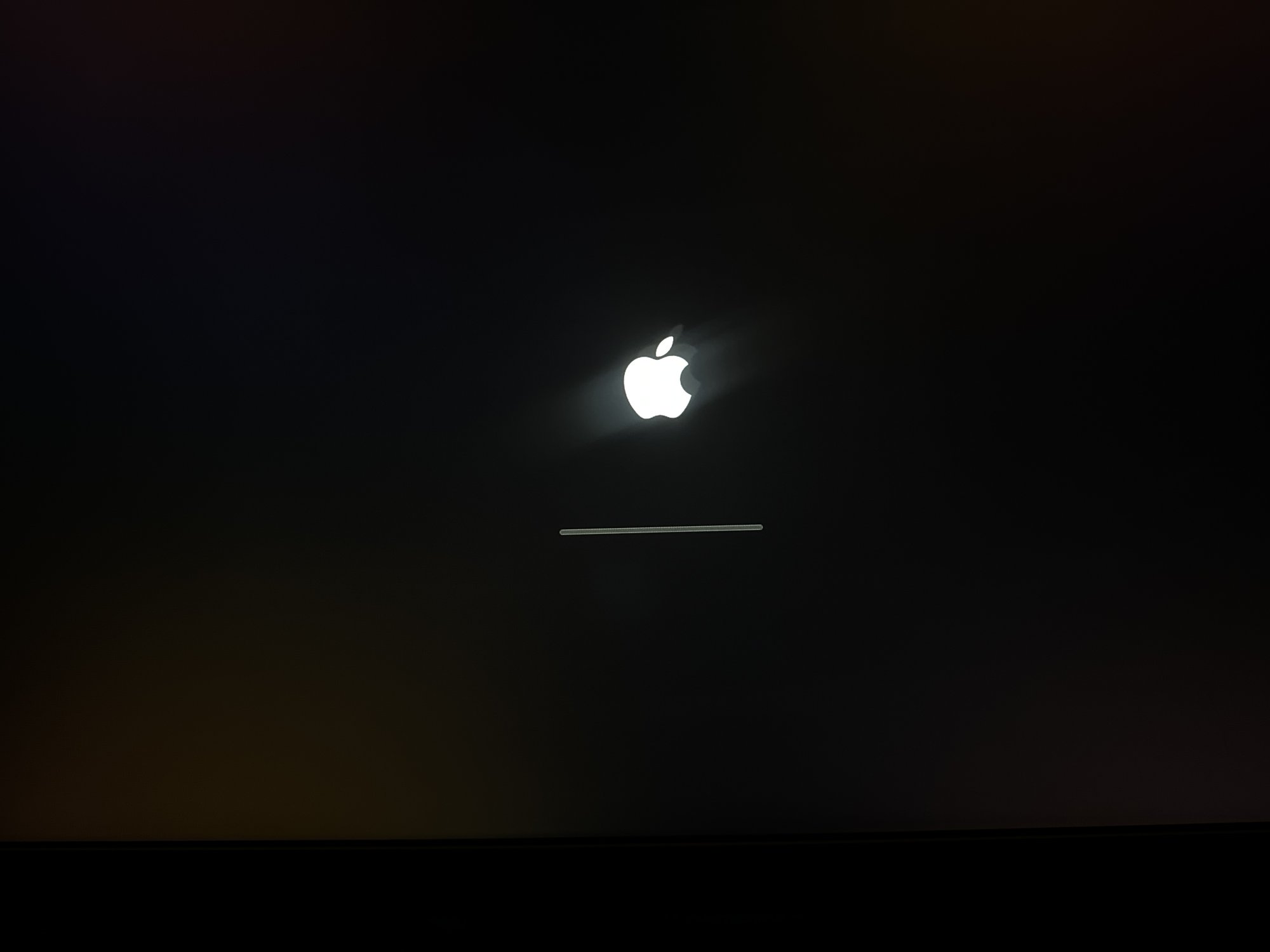

Ok, now I’ve gotten to select my opencore on my usb drive and then the InstallMonterey portion of the usb drive and it stalls at the Apple progress bar…I can see the access light (stopped flashing in otherwords) of the usb drive and nothing is happening…thoughts?

Ok, thanks to Jessie’s Flying YT, I found simplest solution:
Install a formatted SSD and the external OpenCore/install macOS Monterey usb drive. Automatically will boot from external…problem solved!
