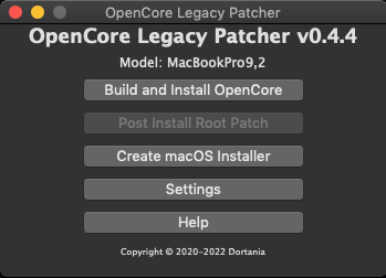

OpenCore Legacy Patcher 4.4 install screen shows: Model: MacPro 5,1, however, 'Post Install Root Patch' is strangely greyed out, whereas on various videos this is displayed as white text on black box, as all other options. Nevertheless, I reasoned that my MacPro 5,1 does not require these Patches as it is Metal enabled and upgraded to Firmware 144.0.0.0.0.

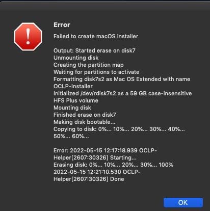

Attempted to create Sandisk USB 32Mb installer with O/S Monterey 17.3.3 in Application folder of Mojave partition, after Monterey was installed this error box appeared:
Tried process again, same error box. Tried with HP USB 32Mb, even downgrading to OpenCore Legacy Patcher 4.3, again same results.

SIP Disabled, safe mode restart, using clean system (No none Apple Apps) Crucial 500 Gb ssd, partitioned into 2, Mojave 10.14.6 (APFS)/ Catalina 10.15.4 (APFS), installed OpenCore Legacy Patcher 4.4 onto Mojave partition with O/S Monterey 17.3.3 in Application folder of Mojave partition. But again 'Post Install Root Patch' is greyed out:
