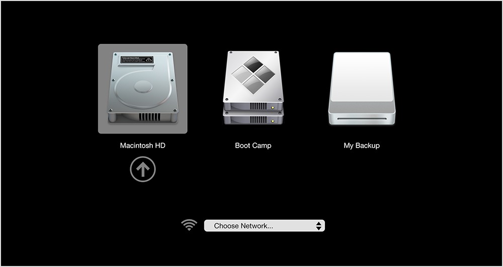

I believe you can get the bootpicker/startup manager by holding down the Option key during the chime. Then you can choose which disk/OS you want to boot into:

You can patch your firmware to enable native Apple boot picker nowadays. There is a thread about it.
But like I said you don't need a bootpicker to boot to Windows 10. You can do it through the startup disk.

If your GPU supports showing the native boot screen, you can use this as your boot manager for selecting between Mojave and Windows. You can access the native boot screen by always pressing the OPTION key whenever you need Windows or set your Mac to always show this screen by entering sudo nvram manufacturing-enter-picker=true && sudo reboot in Terminal. In both cases, your GPU needs to have the required support.
